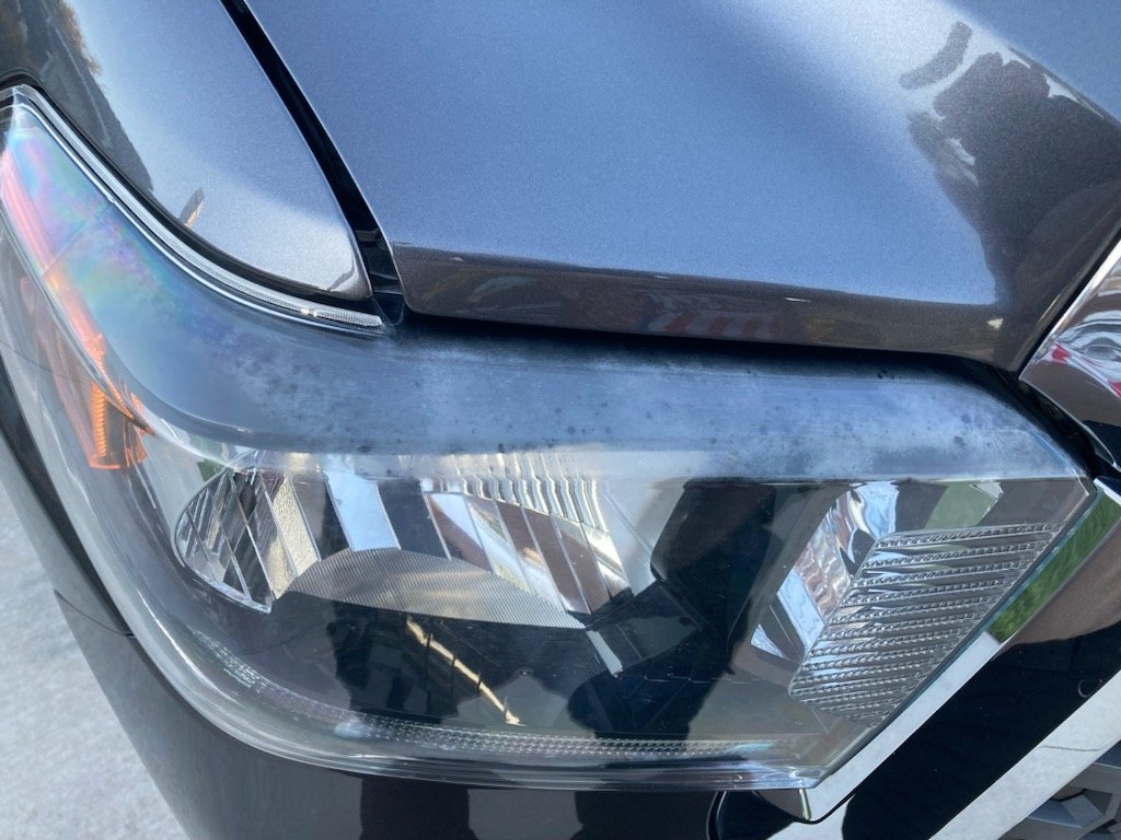

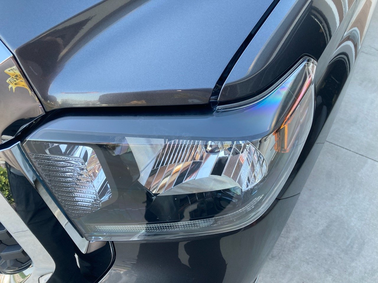

    Has anyone had their headlights cloud up like mine on the PS of my 2021? I polished both sides and the discoloration seems to be on the inside not out!

    In all seriousness, could just try a headlight polishing kit. Mine is the same way

    As stated in my original post. I polished the headlamp(s). Used a kit first then everything else I had. Issue is on the inside as outside its as smooth as a baby's butt

    Open it and put New sealant there is a YouTube video

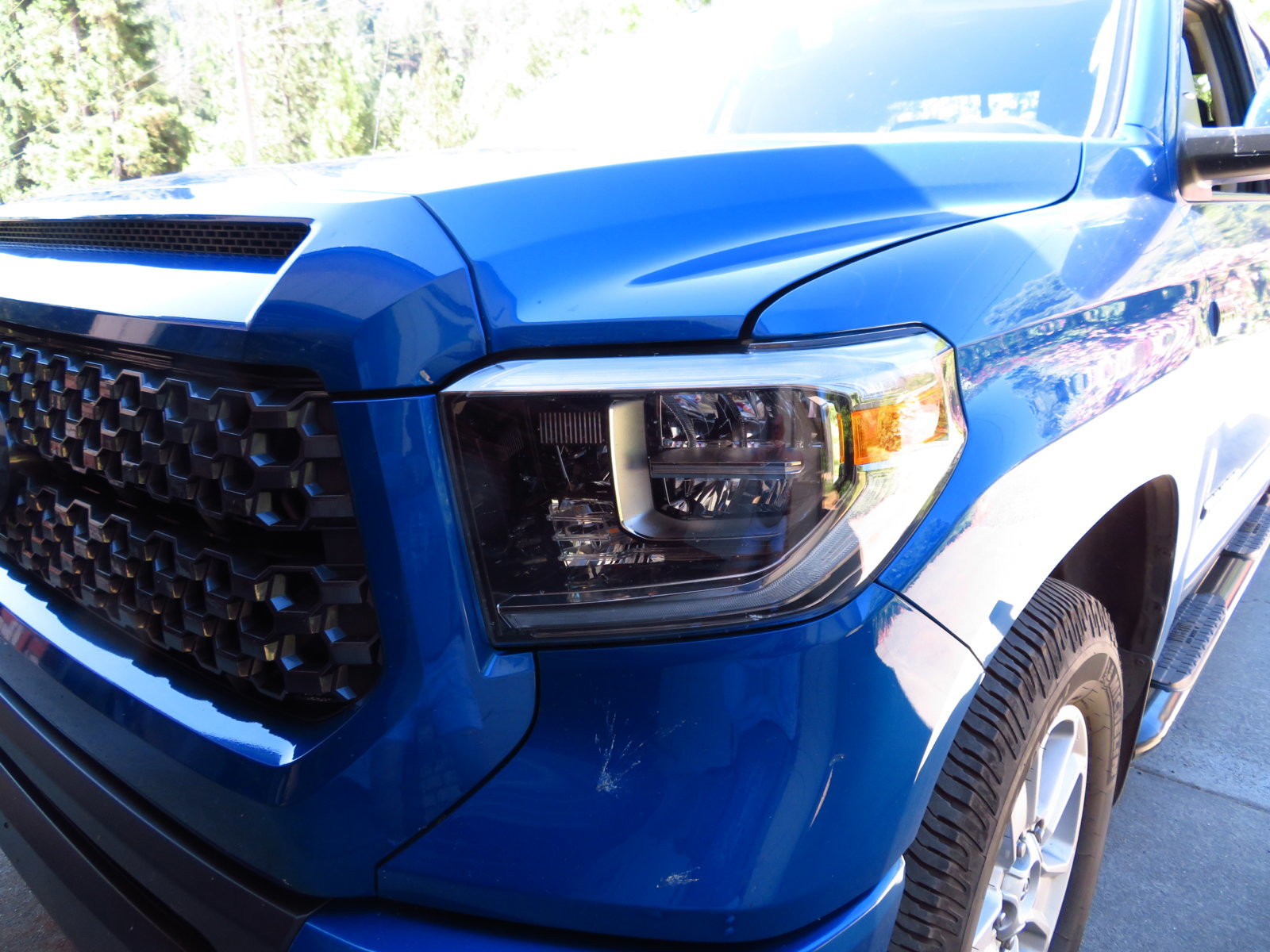

    After more than six years my 2018 lenses (LED headlights) are perfectly water clear.

    I understand, sorry. I just wanted to post a report on clear lenses where in the past, my headlight lenses had fogged over terribly (my 2006 Tundra did this). It seems in my case that Toyota finally solved the issue (Tundra is garaged since new).

    Your driver's side looks fine, but the passenger side not so much.
    I polished and polished my 2014 halogens and no matter what the tops looked like your passenger side and the fronts clouded over.
    In 2016 I swapped them out for TRD pro halogens and after 2 years they did the same thing.
    Seems the more I polished them, the quicker they clouded up again.
    I know getting OEM LED headlights isn't the info you asked for, but my OEM LED headlights haven't shown any wear or clouding up for the 2 years I've had them.
    They offer better light output and physically better looking in general.
    If you are ever interested, get @iHacker to hook you up with the harness..

    My 2019 did the same thing.
    I ended up selling it lately but it was inside for sure. I was the second owner and PO had installed LED bulbs. The rubber boot behind the headlight didn't fit correctly with the aftermarket bulbs. I'm going to assume that somehow was letting moisture in.
