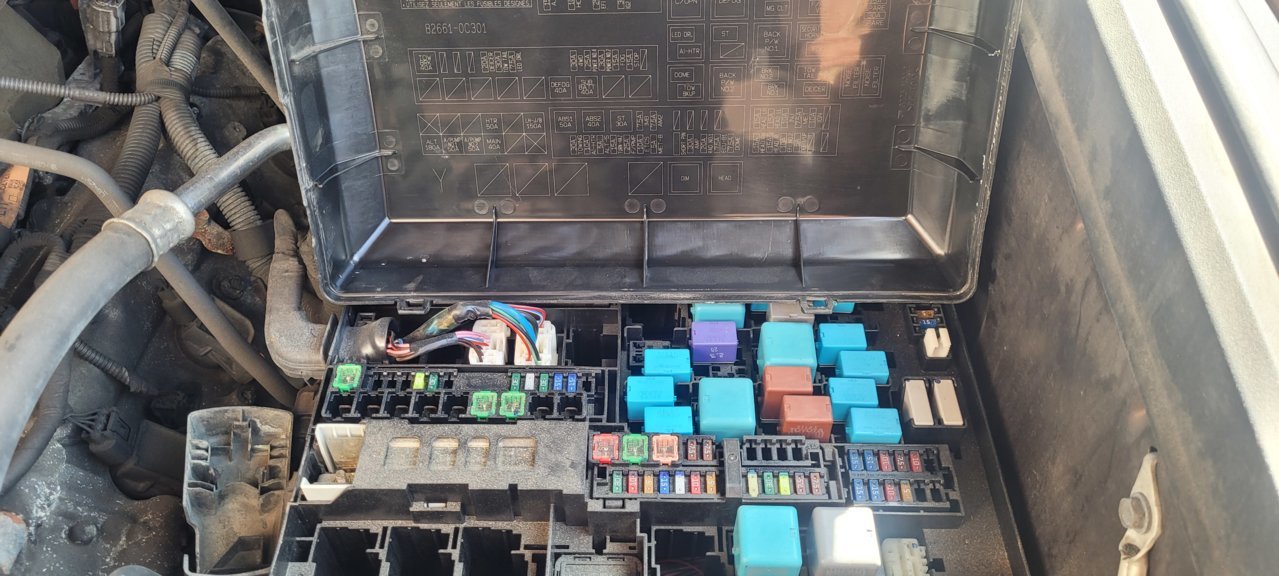

    I have 2015 tundra limited with navigation.
    I get the head unit (radio touch screen)randomly resetting while driving too. Nothing specific corresponds to it.
    Sometimes it won't boot at start up and i get skid and airbag lights on dash and blank head unit. Then after 5 minutes or so radio will boot on.
    I updated software via USB. Paired and unpIred multiple different types of phones... no luck.
    My wireless key lock doesn't work sometimes too. When i approach vehicle and hit unlock and it didn't work... i know head unit will likely not kick on.
    7 month old battery fully charged.
    I just cleared 108,000 miles and maintenance required light is on, but that is a standard Toyota thing at different mile threshold.
    Any solutions?
    I'll try and post video of what happens.

    Took to dealer and of course it didn't happen while it was there. They saw my after market starter and blamed that.
    I have removed remote starter and head unit still freezes and interior lights and wireless entry won't work from time to time.
    Will take back to dealer.

    Well, I completely went through all of my fuses under the hood and found a non labeled fuse loose. After several hours of back and forth between audio dealer and Toyota service, I found it myself.
    I have since reinstalled aftermarket starter and I'm back in business.
  12. Sep 29, 2023 at 11:45 AM
    DawgLB
    DawgLB New Member
    Nov 18, 2020
    #55069
    8
    Slips
    2015 Brown Tundra LTD
    LED Back-up Light HArd Tanoe cover
    loose fuse was labeled as "short Pin"
