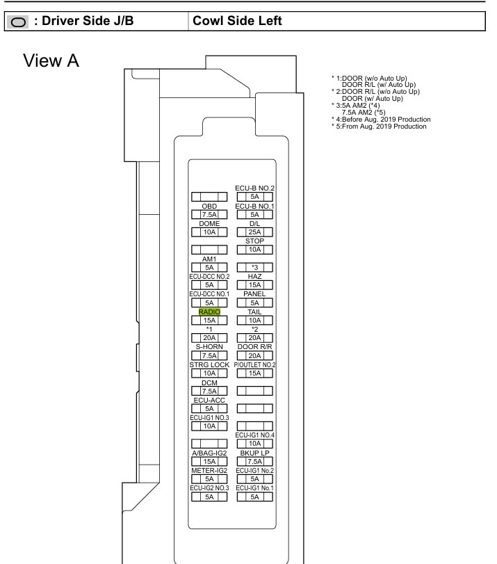

    Ok weird thing happened...I have the boost auto mirrors and was going to adjust the mirror and when I pushed the button to adjust it and the head unit (factory radio unit) went out...I assume a fuse blew but I don't know the location of the fuse...the mirror is also not working...I am going to look at fuses first and go from there.

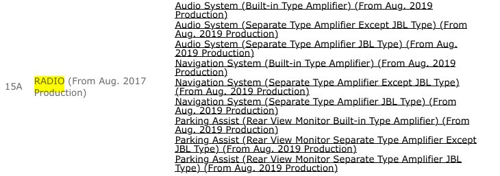

    The radio fuse is under the dash on the driver's side.
    I'd be concerned why the mirror control blew that radio fuse.
    Are the mirrors a recent install, or have they been on the truck for awhile?

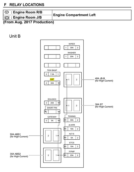

    There is also an AMP fuse under the hood for the amp under the passenger seat.
