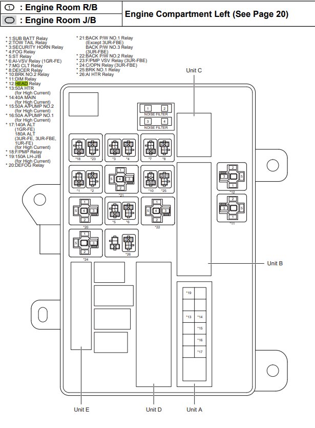

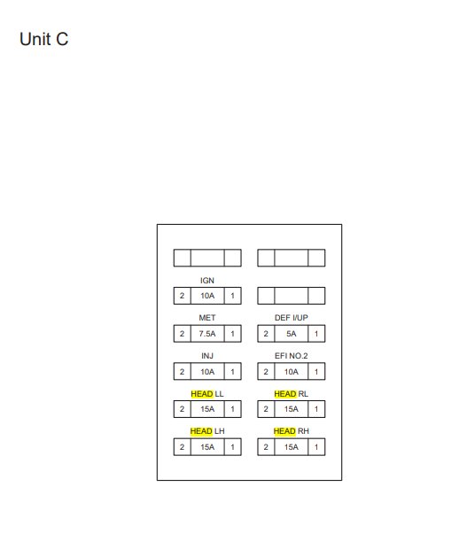

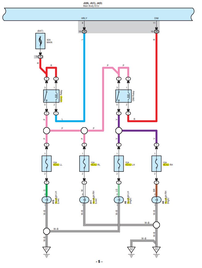

    DId you recently change anything on your headlights, any bulbs, or other lighting wiring?
    There are 4 headlight fuses, 2 hi and 2 low
    Should be in the under hood fuse box.
    Top right corner.
    Also relay 12 is the headlight relay.
