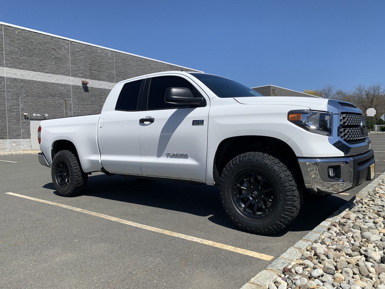

    mv133 [OP] New Member
    Mar 14, 2021
    #60401
    41
    21 tundra SR5
    Brandy new
    Damn i didn’t expect that, probably only going to the middle setting which is like 1.5 inches or so. Almost feel like pulling the plug haha truck is brand new. I really don’t want to do uppers if that’s the case I’ll just lift the whole truck.

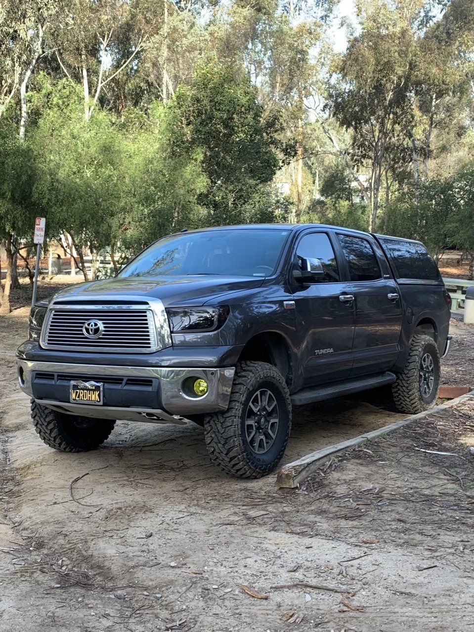

    I put 6112’s up front and the 5160’s on the back end. New uniball upper arms and it eats earth.

    truck looks great that’s what i might do down the road. What size tire is that ?

    I got Toyo mt’s 315/70/18. Had to trim n chop but they fit n don’t rub.

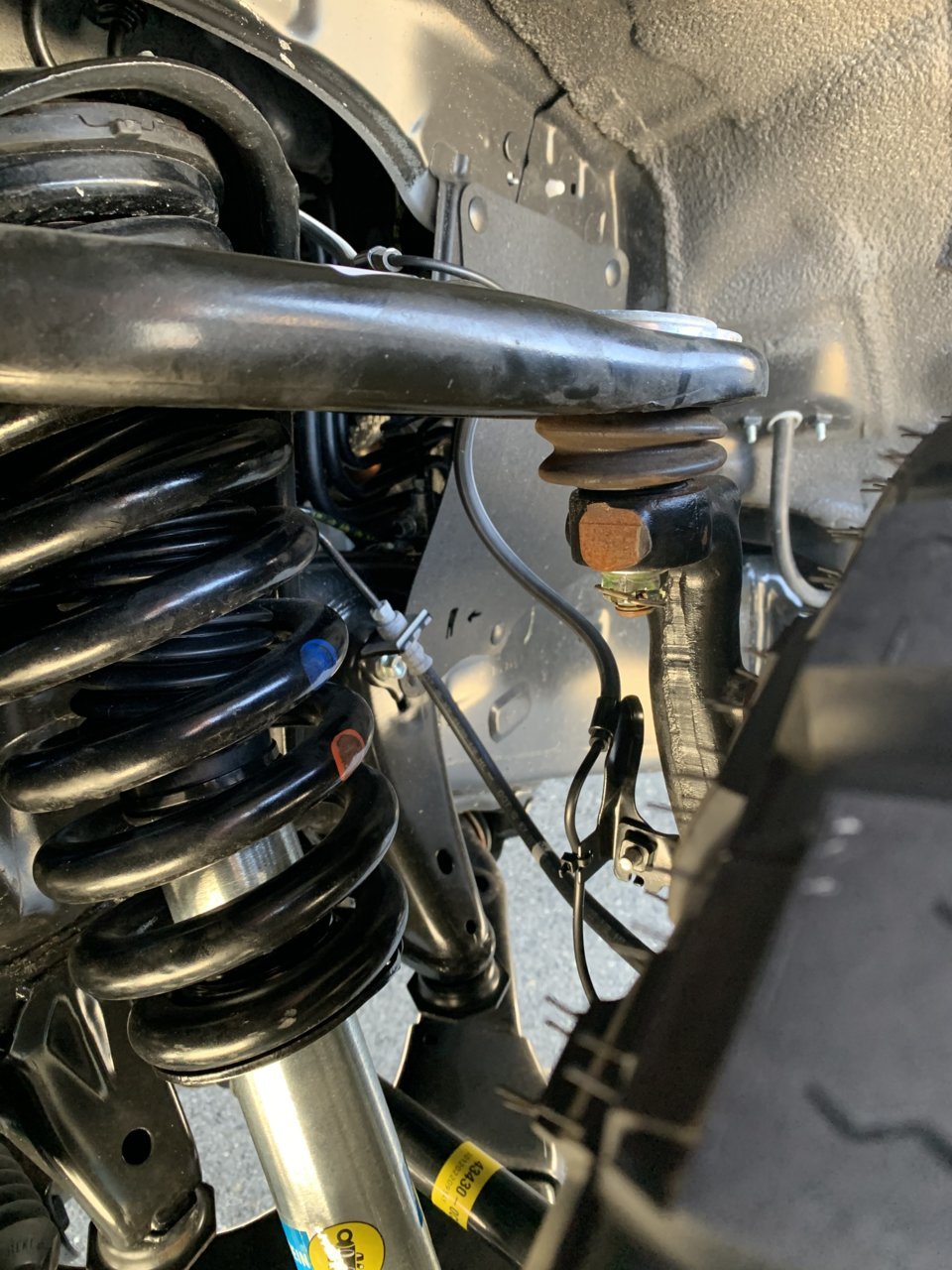

    My plan is install the 5100s middle setting if the upper ball joint don’t look stressed, run it .... maybe down the road do a 6112/5160s with new uppers, down the road. I jacked the truck up two inches this morning to get an idea hhahah it looked fine, actually looked like it was more level on the ball joint if that makes sense

    Ok all done ! 5100s installed middle setting .. the place that installed them by my house is literally called the front end shop . Mechanic told me not to waste money on UCAs he said everything is in spec with room to move either way nothing maxed out . Super happy and it rides way better then i thought. Then again i am not rock crawling . Just a daily driver haha
