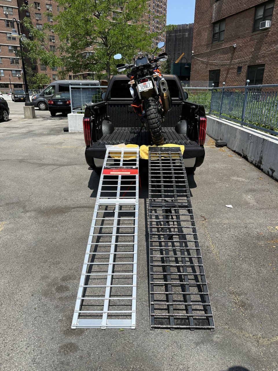

    I have had no issues hauling my KTM 1290 which weighs in at 524 lbs.

    I use 2 wide ramps. Walk up one and drive the bike up the other using the clutch to modulate. Had a buddy spot me the first couple of times but I’ve pretty much got it down now. Just don’t forget to strap the ramps to the truck. Lots of good you tube fails there.
    BoulderGT3[OP] and 49ºNRTH like this.

    I have done the two ramp thing a lot as well. Works fine but I think I have watched too many Youtube bike loading fails. Every time I do it I picture myself whiskey throttling the bike and launching it through the cab. I do still have a scar on my shin from when my foot went between the steps on my walking ramp.
    I also stick a chock in the bed to help stabilize the bike. I can't remember what brand I have but my ramp folds into a bed extender after loading.
    HMNYC[QUOTED] likes this.
