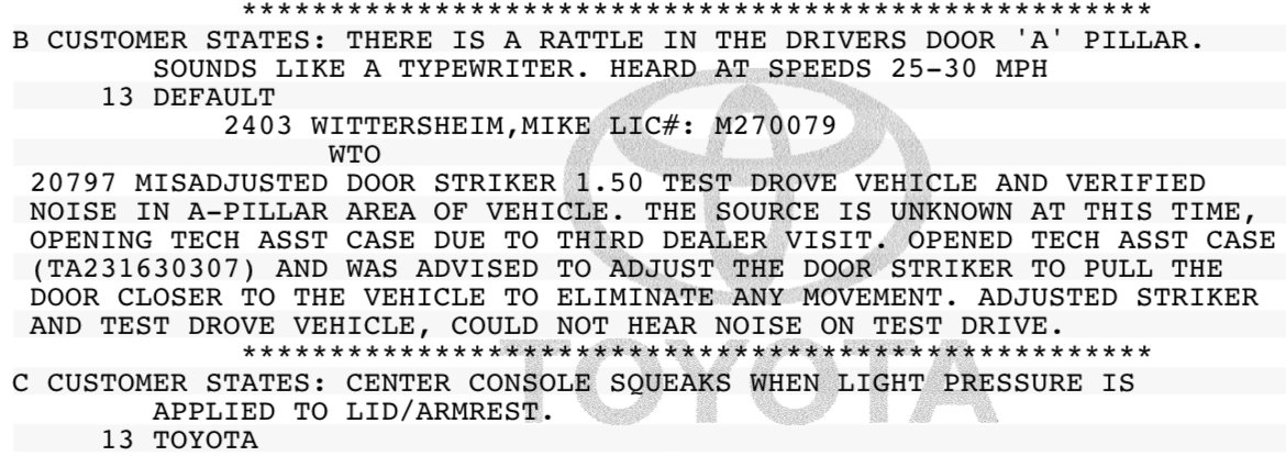

    Yes, I have it on both doors. 2022 Tundra with almost 23,500 miles. It only presented itself initially on the drivers side and has been “repaired” by the dealership a few times now. Within the past 3,000 miles or so, I now can hear it on the passenger side door.
    Originally, the dealership replaced the seal twice(they thought it was defective), which didn’t do anything. Most recently, they opened a ticket/TAS with Toyota. Toyota had the dealership tech adjust the door striker, pulling the door tighter against the seal. That repair made sense, as I could pull on the door handle to make any noise go away while driving.
    Adjusting the door striker helped for a bit(maybe 1000 miles)? But the noise has returned.
    I’ve included the master techs notes from the RO.
