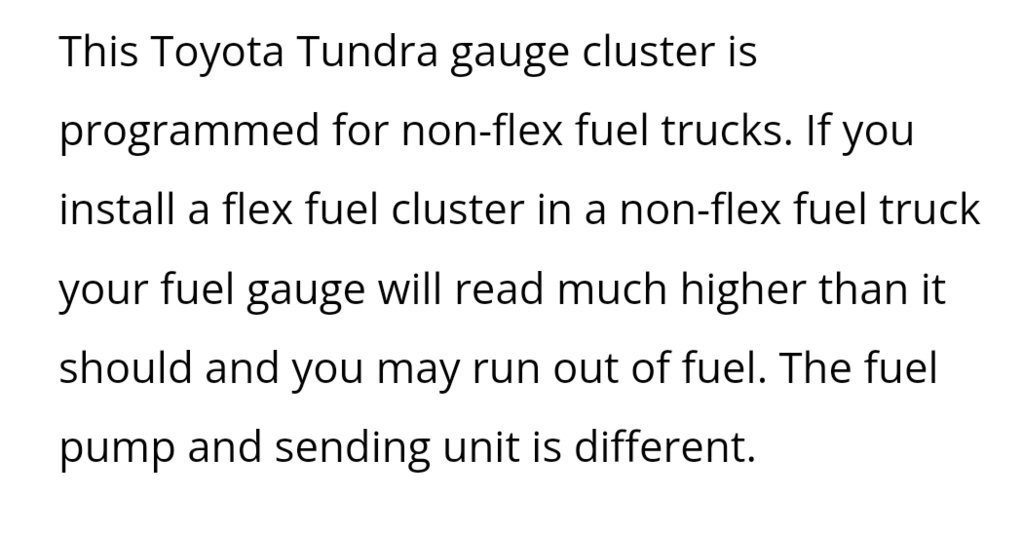

    Also make sure you verify part numbers. Don't mix and match Flex Fuel vs Non Flex Fuel clusters
    Wynnded[QUOTED] likes this.

    Good note on the non/FFV cluster.
