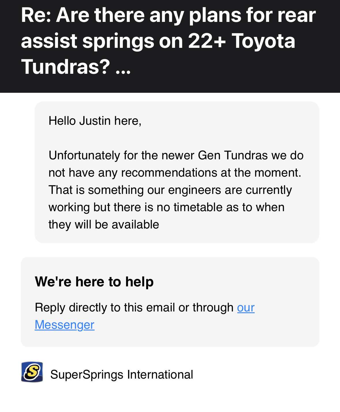

    Just reached out again, they state there are not rear sumosprings for the ‘24 Tundras. From them “the ‘24 Tundra must have something engineering noticed that is different from the ‘23 so they do not include it in the application”. I asked if they can verify with engineering if they haven’t verified the 2024 is the same as 2023 so they don’t approve the application OR they know the 2024 is different from the 2023 so they don’t approve the application. Important difference.

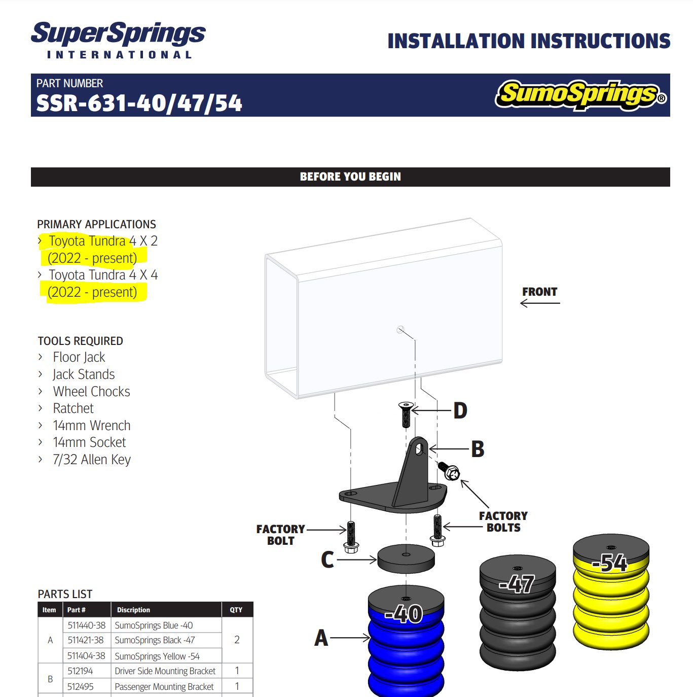

    Ok, one more time. Engineering reached out today. They made an error, there is no difference and the sumosprings for the 2023 will fit the 2024 model.

    I received that exact message from the same person. When I pushed back and asked for clarification they confirmed that message is incorrect, the rear sumo’s listed for the 2023 tundra absolutely do fit the 2024 tundra.

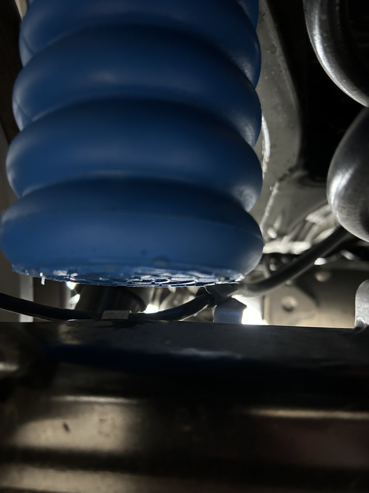

  24. Aug 7, 2024 at 9:02 AM
    #24
    Paulswagelock
    Paulswagelock New Member
    May 12, 2024
    #116733
    43

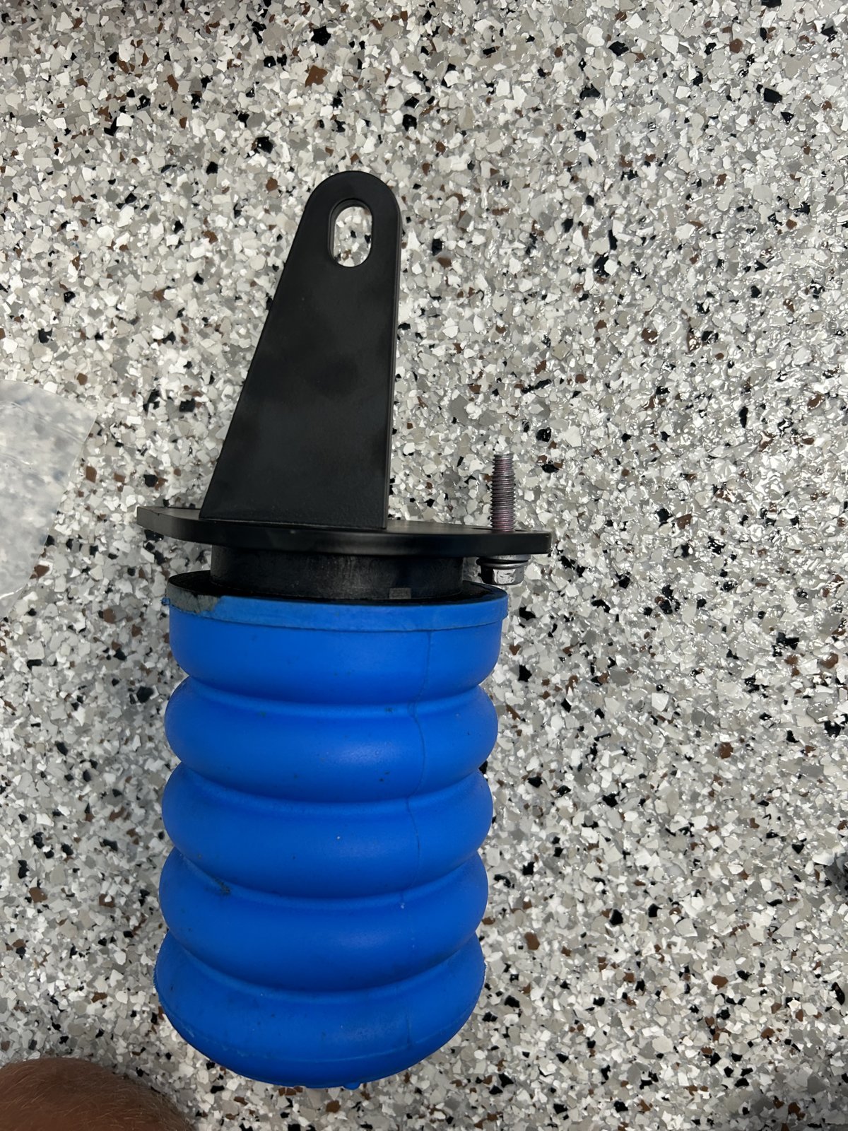

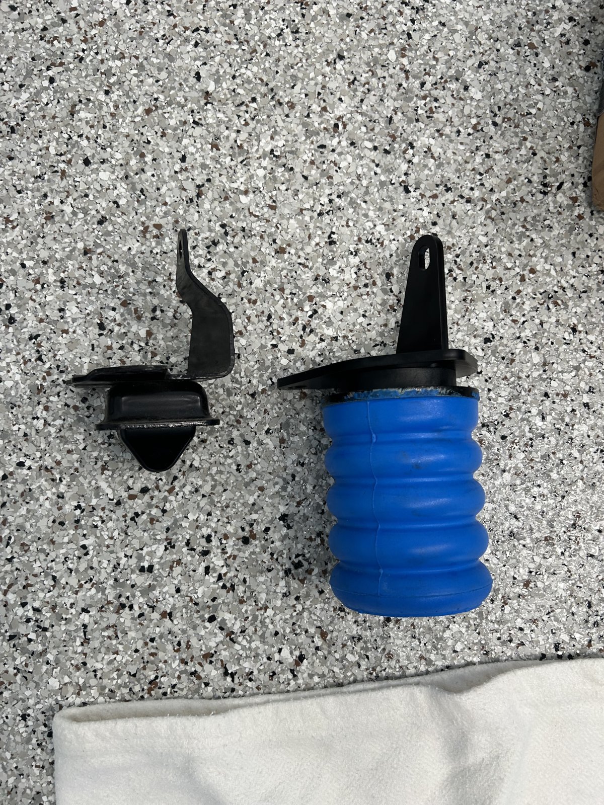

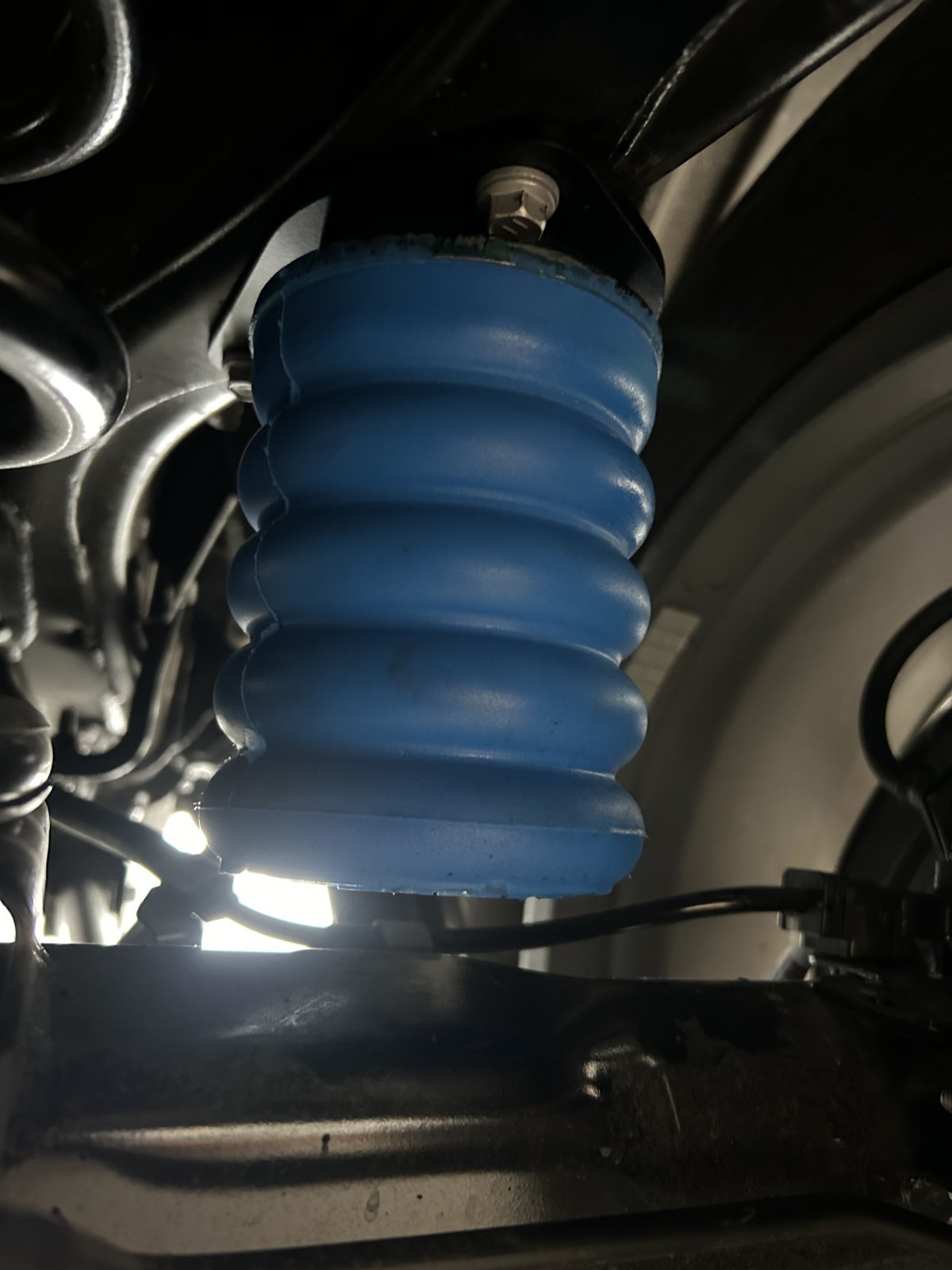

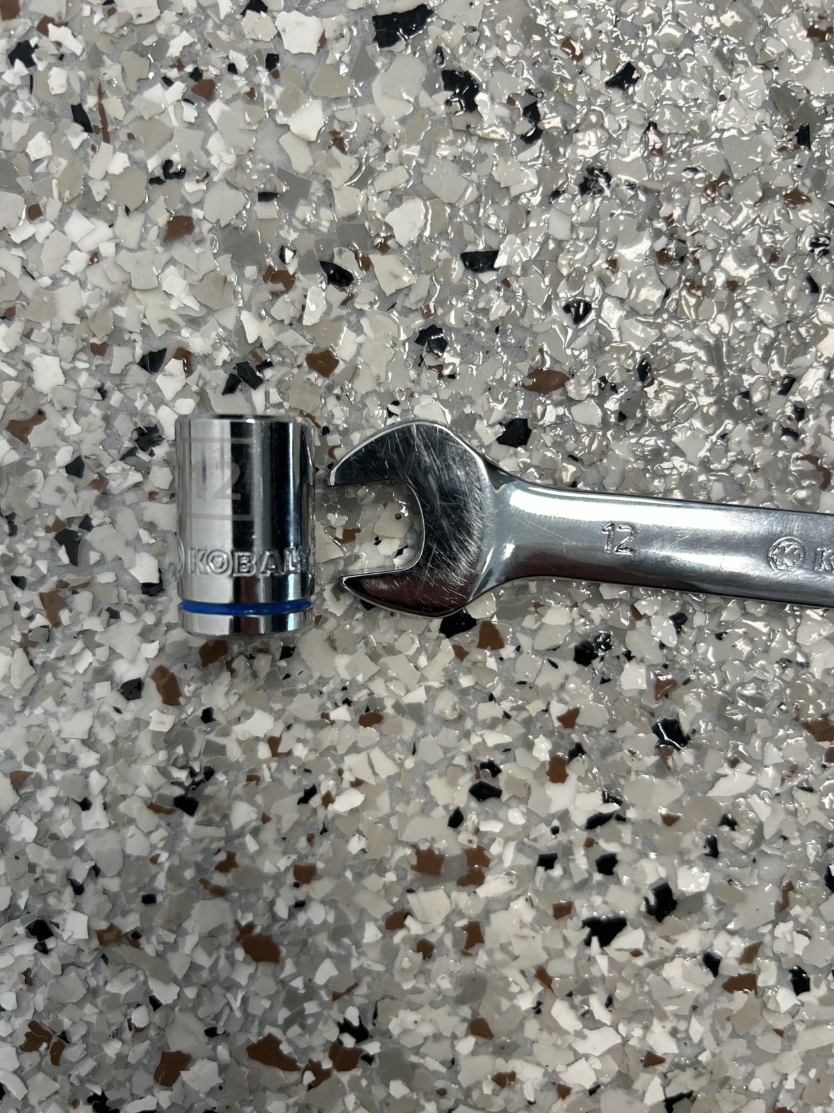

    I installed them today.
    I tow a 8000lb boat with 800 pounds of tongue weight on occasion. It drops the back end significantly. I have used Sumosprings in the past on my Ram, so I decided to give them a try.
    I have a 2024 Tundra, but the website only lists options up to a 2023. I spoke with their engineering group and confirmed they are ok for the 2024 as well.
    I installed the blue version today. Takes about 20 minutes. Can do the entire job laying under the truck without jacking it up or removing the tires. Easy install. There are (3) 12mm bolts on each side. All easily reachable. Once the old ones are off, you assemble the Sumosprings per their instructions. One tip, place the one bolt in place before assembling as you see in the picture. It doesn’t fit in once assembled. You will need an open end wrench to tighten that one bolt.
    Once installed there is slightly more than a 1” gap allowing the suspension to flex without engaging. I am 225 pounds. If I sit on the tailgate they almost touch. If I bounce full weight on the tailgate they just engage.
    I took a 15 mile ride unloaded. Except on a deep dip in the road with a fast recovery they do not alter the ride at all. In the deep dip they engage on the way out, not obnoxious but I could tell they were touching the axle. So unloaded ride is great.
    It will be a week or two before I have my boat back on, I will update once I do. I expect they will perform the same as my Rams did, and stop the squatting while maintaining a decent ride.
    Sacul[OP] and NORTHof54 like this.

    I’ve been looking into these, will blue be enough for reducing squat from an 8000lbs trailer, would the denser black sumos be better? I have no idea.

    I used the blue ones on my Ram trucks for the same weight, so I rolled the dice on blue again. I will report back once I tow it.
