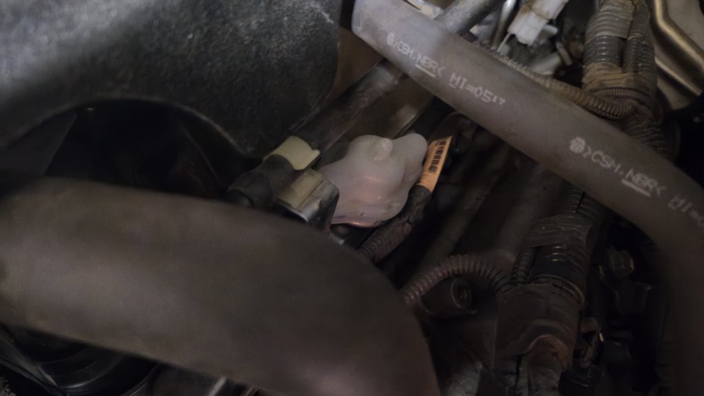

    It seems that Toyota, in their infinite (infinitesimal:() wisdom, doesn't have a schrader valve for testing fuel pressure.
    And while I've got you on the line, what is this plastic covered do-jiggy mounted on the fuel rail (see attached photo).

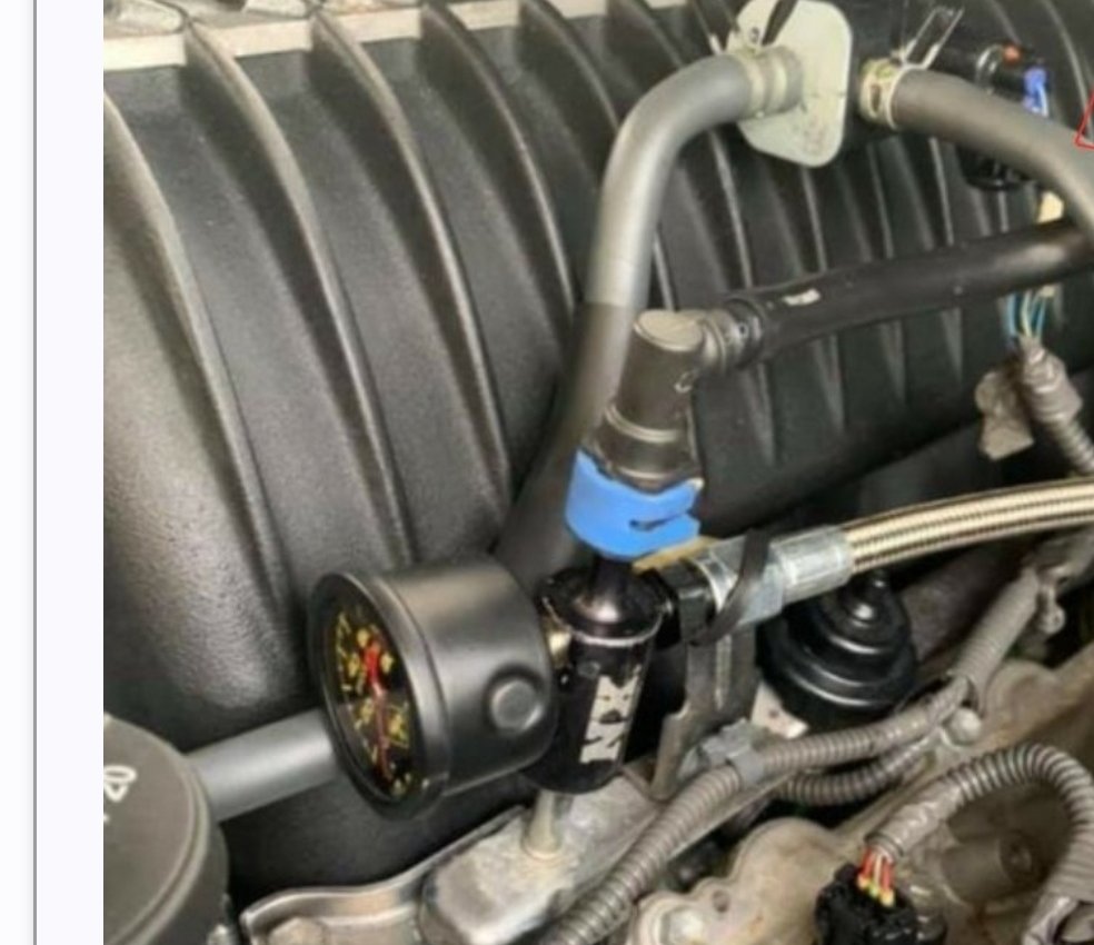

    For flex fuel regulator.
    https://www.racetronix.biz/p/adapter-qdf-5-16qdm-5-16-1-8-port/qda-56f56mp
    You can search on Amazon for similar setup. Just get a decent gauge too.

    Hey, I'd still like to know what the part covered in plastic is.
  5. Aug 3, 2025 at 7:45 AM
    HulkSmurf14
    Aug 9, 2019
    #34377
    2,855
    2014 Tundra Limited
    Tastefully enhanced...
    It's the OEM fuel line connection locking "harness." Actually fairly standard for all...

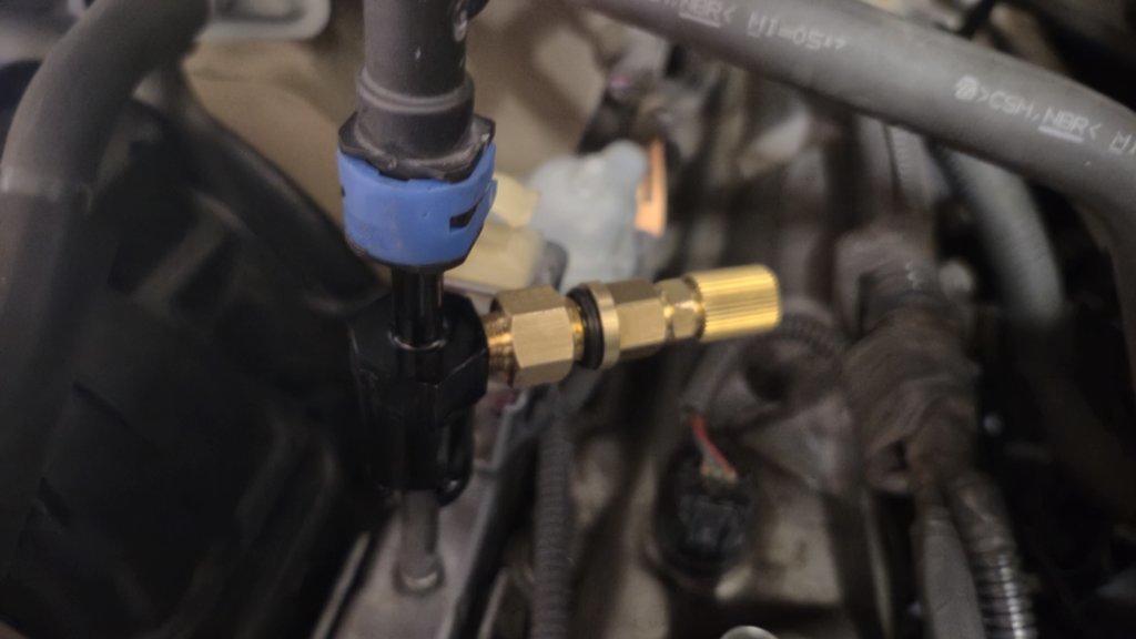

    Here's my install, using a schrader valve instead of a gauge.
    Fuel rail adapter from Racetronix: $31.77 including shipping.
    Schrader valve from Amazon: $15.97
    Had to buy an adapter from NAPA (P/N 202 X 5) because the schrader valve didn't fit the Racetronix: $3.49
    Bought fuel compatible O-ring for the adapter (P/N 2-12077): $8.29
    The Racetronix fuel rail adapter didn't fit well. I ended up forcing it onto the fuel nipple with pliers. Suggest you call Racetronix to see if they have a slightly different sized adapter.
