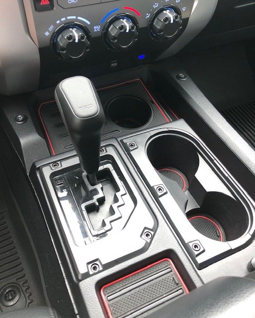

    So the plastic welds is for the shifter surround. Only way to get the stock piece off. So AJT/Meso/ or any aftermarket piece will all require the same work. I had to grind mine to paint the piece, just use some hot glue to re-assemble.

    Maybe for the cup holder trim, honestly I don't remember.
    @RobertD pretty much sums it up.
    A Dremel will do it.
    The AC vents are simple stick-on with included double-sided tape.
