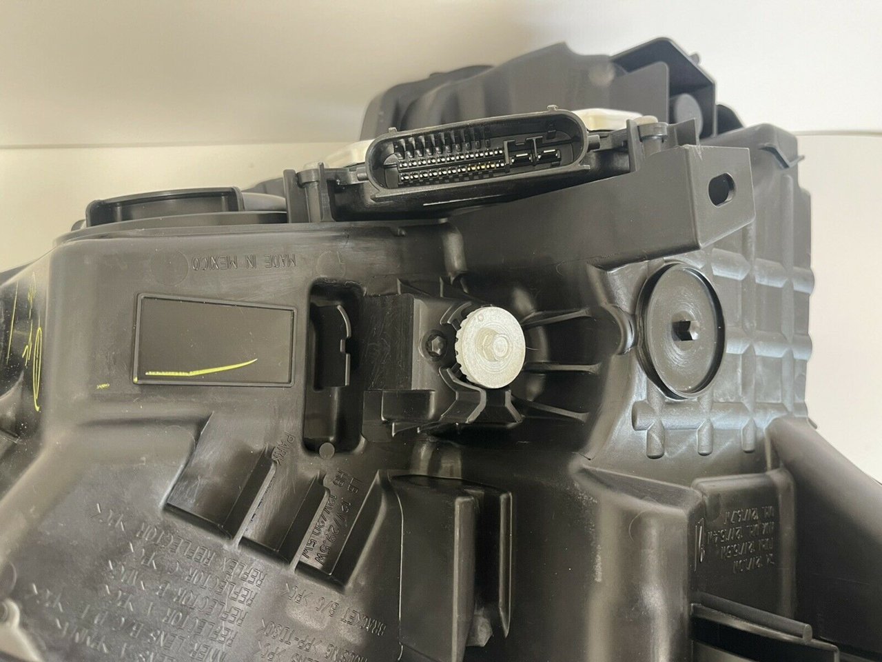

    I don't know.
    Here's (see pic) the connector from OP's part number, and it's exactly the same on my Platinum.
    What does your/SR5/Limited wiring for headlight looks like?
    -99

  11. Jul 14, 2022 at 11:08 PM
    Buellride
    Buellride [OP] New Member
    Mar 15, 2022
    #75857
    376
    Olympia
    THE BOULDER
    BD Lights, Banks PM, Fuel Vector 18" on 295/70R18 Cooper AT3 XLTs, Black-Out badges, TRD front grill
    This is the picture that got me thinking about my SR5 headlight connector, thus asking my original question.

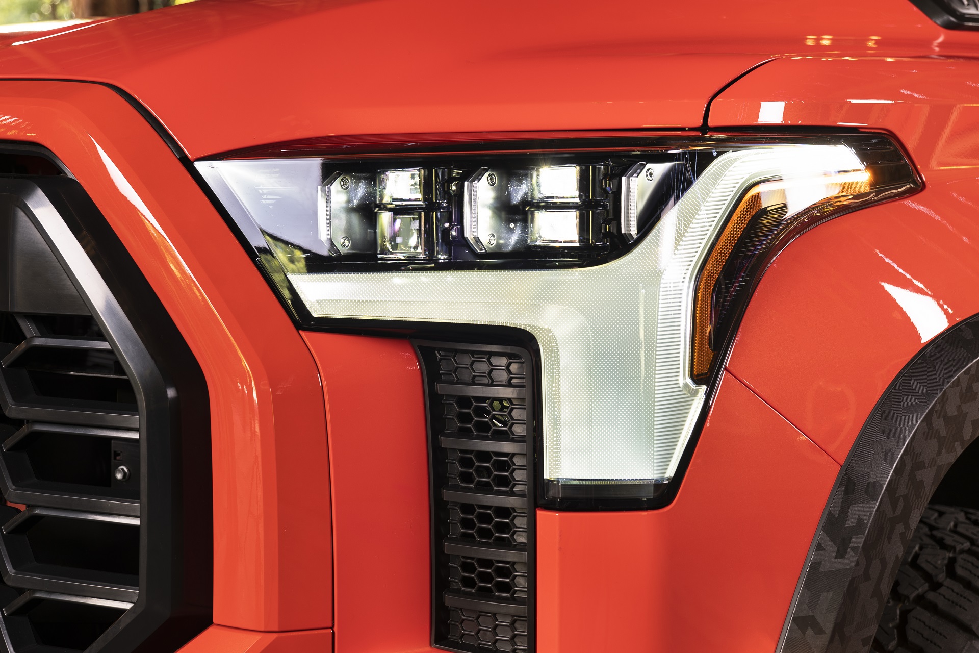

  14. Jul 15, 2022 at 9:23 AM
    j.b.
    j.b. New Member
    Jun 20, 2022
    #79754
    152
    Jake
    2022 Platinum MGM
    They are both LED
    But the higher trim lights have a big white glowing piece at night, and they are all LED.
    The lower trim have halogen style turn signals, and I believe the main headlight housing is a reflector style, while the upper trim looks more similar to a projector style. Whether that makes any difference in light output, I don't know. But the upper trim ones do look fancy at night.
    There is also something about auto leveling, but thats probably just a gimmick. Oh, and the turn signal on the upper trim lights is sequential, instead of just a regular blinking light.
    Upper trim:
    Lower trim:
  15. Jul 15, 2022 at 10:13 AM

    Thanks jb. That's a great breakdown. I can see why one would want the higher trim versions.
    j.b.[QUOTED] likes this.
