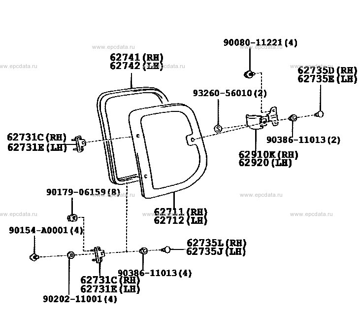

    yeah, the anchor hardware. I'm more concerned about finding the parts, but I guess I could try the Sienna hardware before I try a pick-n-pull if OEM is too expensive

    Look at this picture to ID the part you need and inform us once you read this reply fully and figure out where in the diagram the parts are which you need.
    If the number next to that part is 10 digits and a hyphen (i.e. XXXXX-XXXXX), that number is your part number. If it's 5 numbers or 5 numbers w/letter after, that's just an index number. Tell me the index number, I'm happy to pull the part number for you.
    OEM isn't expensive if you know how to get legit OEM parts, direct from Toyota, at a discount. But nothing will beat simply hitting a junkyard and pulling the parts, you'll pay less than a few bucks, or potentially they may let you have for free.
