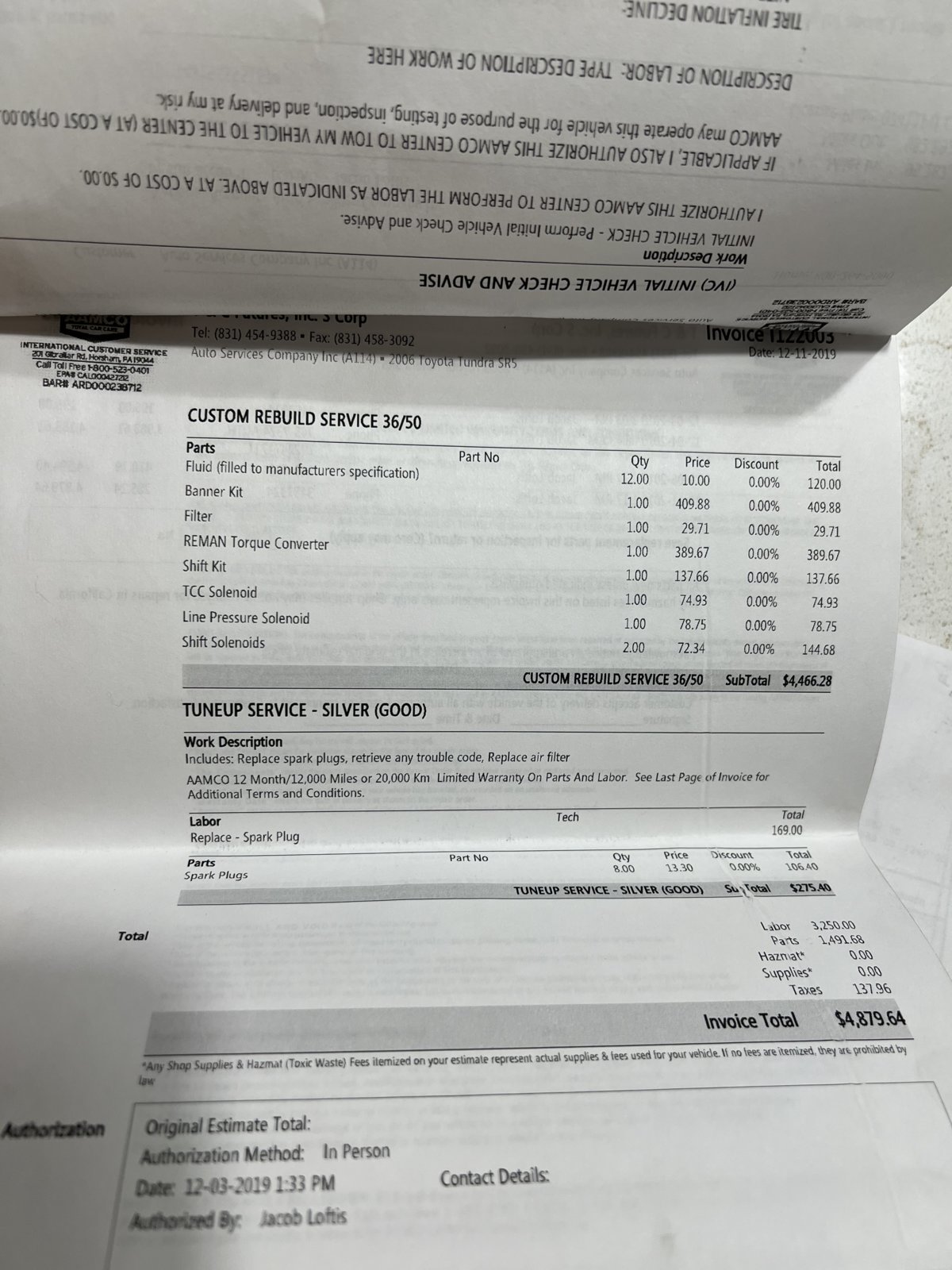

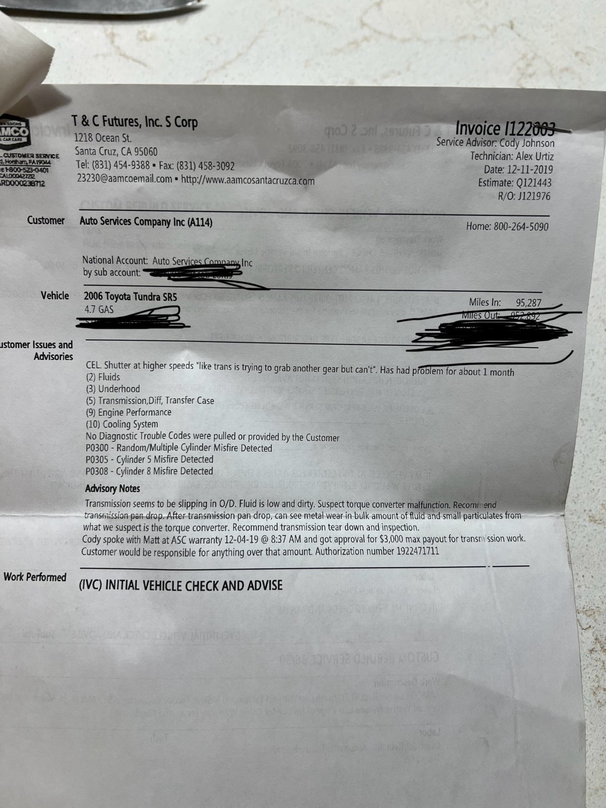

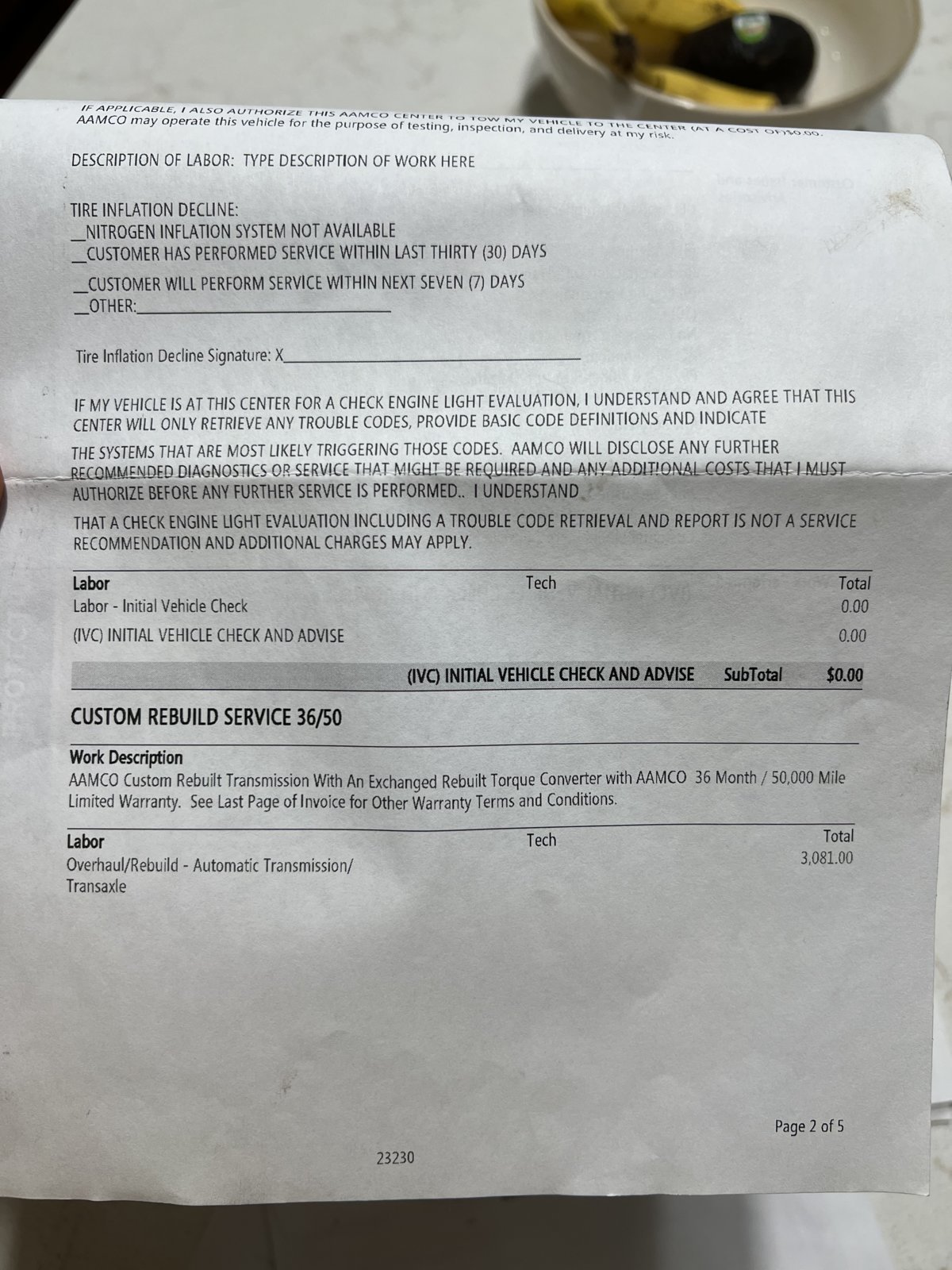

  10. Jan 31, 2024 at 5:06 PM
    Saibot
    Saibot [OP] New Member
    Aug 4, 2023
    #101519
    3
    2006 Tundra Dbl Cab 4WD
    Thanks for the suggestions- I think I’ll try a full fluid flush to make sure it’s the right fluid. If that doesn’t work maybe I’ll try and figure out how to do a solenoid. Would the solenoid be acting up even if I don’t have a code? Also found the paperwork on the transmission work:
