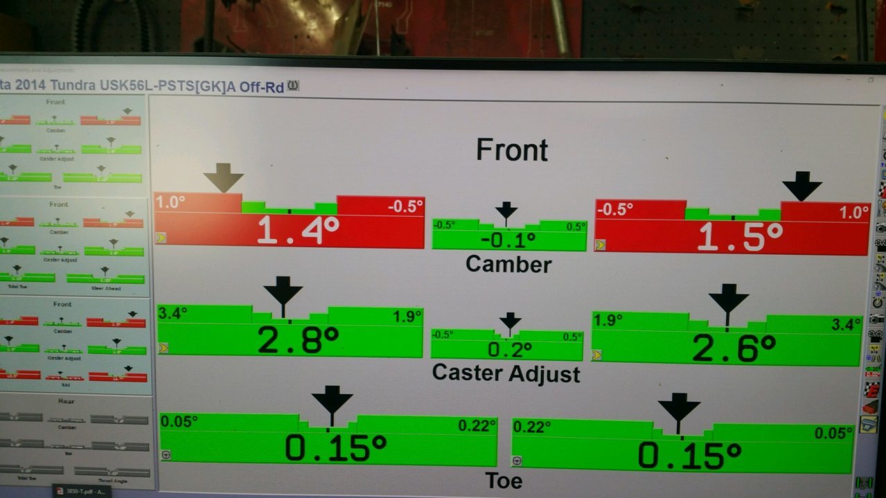

    Also here’s the alignment specs

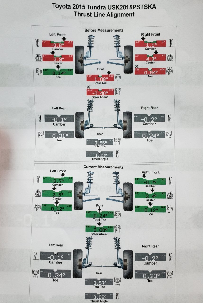

  3. May 3, 2020 at 4:34 PM
    TXTundra2722
    TXTundra2722 Pipe Hitters Union
    Nov 26, 2018
    #22236
    1,763
    2015 Black Tundra
    This was my last one.

    Camber is suppose to be at 0.1 for both sides and as mush caster as possible 3+ but keep camber at 0.1 and 0.5 more caster more on passenger side than driver side. Their a whole ride up on it. Sometimes when its in the green dosent mean right.

    Excuse my ignorance but if the chamber is off it’ll cause the tire to look cocked either in or out correct, like the bottom looks further u see the truck than the top of that makes sense. Sorry for the dumb questions, I’ve just never had to deal with this stuff before.

    Yea im not really to sure. Im not an expert but I know some stuff. Bring the camber down close to 0.1. And caster looks good just bring the passenger up 0.5 more than the driver side. Toe looks good.
