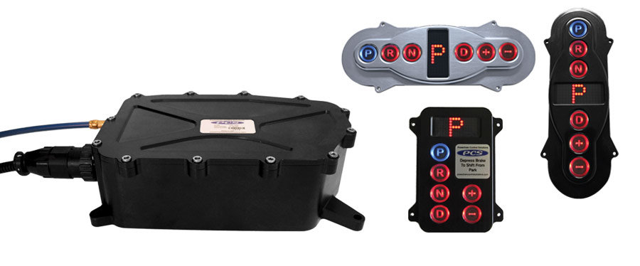

    Contact your local VA hospital/clinic and ask about being assessed for an adaptive vehicle equipment grant. If medically necessary for you to drive, the VA will pay the complete cost to retrofit your vehicle so that you can drive with any service connected disability. It is a lengthy process that starts with your doctor determining your level of disability and need for driving adaptations, but it is well worth it. Vehicle adaptations are not cheap due to the insurance/liability concerns and certification process. I had the VA install an electronic left foot accelerator in my Tundra. The cost from the shop was like $2900. For your situation, I know there is a push button shifter setup that they can install.

    Or if you've got the financial resources, you can have the push button shifter installed and then request reimbursement through the VA. The only risk with that route is that you run a risk of the VA determining your disability isn't serious enough for a vehicle adaptation.
    You'll probably have a good idea of approval after you see a doctor, because they will use your medical records and a physical exam to assess your limitations. Once they determine your limitations, they write a prescription for exactly what equipment is needed to accommodate safe driving. When you see that doc make sure you explain to him/her how difficult/painful it is to operate a normal shifter and show them the adaptive push button control that solves the problem. Not all the docs are familiar with the process for adapting vehicles.
    From what you said about your condition I think it should be a slam dunk. Just do some googling for adaptive vehicle shifters or find a local adaptive vehicle outfitter near you to educate yourself. There are companies that specialize in all these adaptations from wheel chair lifts, shifters, pedal setups, automatic doors, etc. Most of them are experienced in dealing with the VA too.
