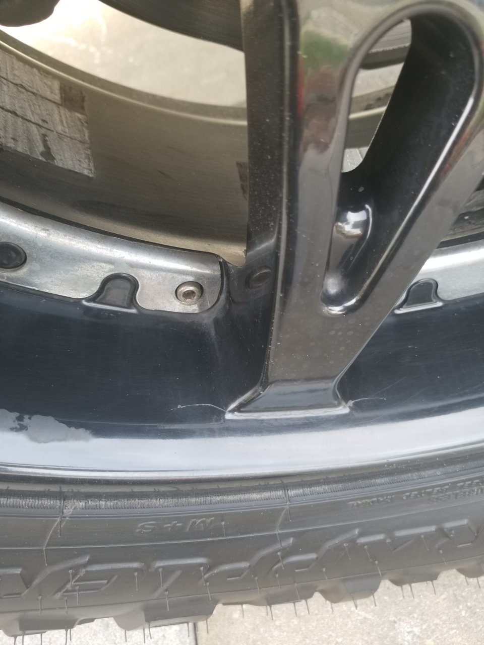

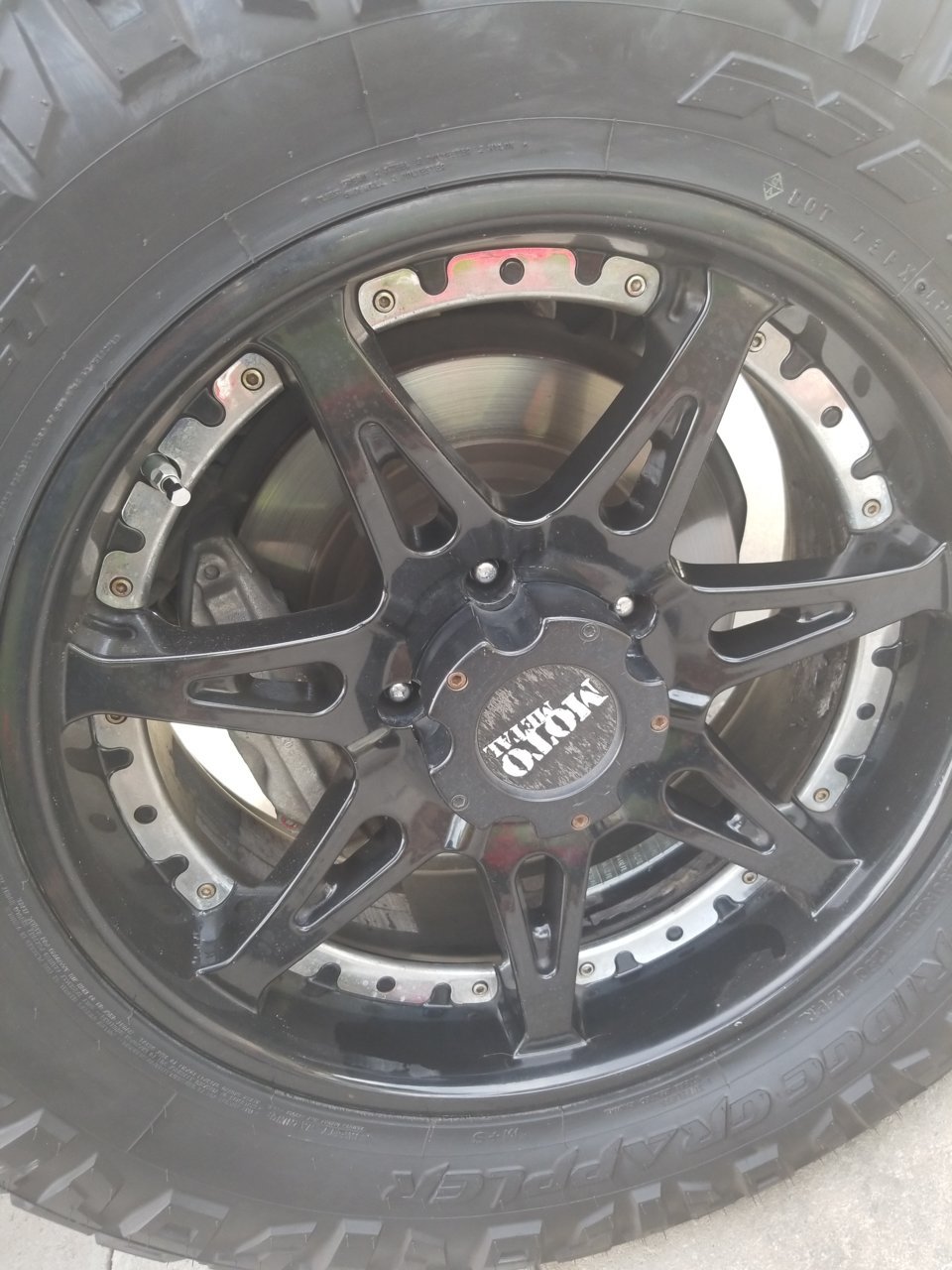

    Attention wheel experts. Should i be worried? I just got new tires installed last Friday (35/12.5r20 ridge grappler). Saturday i decided to polish my wheels (moto metal MO961 20×9) when i noticed hairline crack on one of the spokes. The crack is only at the front and nothing at the back. I'm not loosing air at all. I wash my truck and wheels almost every 2 or 3 weeks and never noticed this. Do you guys think its just paint? Is it possible for the tire dealer to have done this when they installed the new tires?

    That is not good. I wouldn't drive it.

    I know. I'm taking it back to the installer tomorrow and see what they have to say. I was hoping I can get some opinion from wheel experts here before taking it back.

    Could be just a crack in the paint/ outer coating.
    If you wanted to be 100% sure, I’d sand it to metal and check. Then re finish.

    I'm no expert by any means and it's hard to tell from a photo but if that were mine I'd replace it. Risks VS rewards. ~$200 for peace of mind and to be certain. BTW, I'd contact Moto Metal to see if they'll replace it.

    If it is indeed the aluminum that is cracked, and that is what it looks like. 3rd pic down appears to show the crack in the aluminum and not just the paint. Replace it soon! It will spread!

    doubt the tire install did that. not much sidewall on 20"s so they take more beating than 18"s. I would get a replacement one. at least it's just the rim, you already got new tires :)

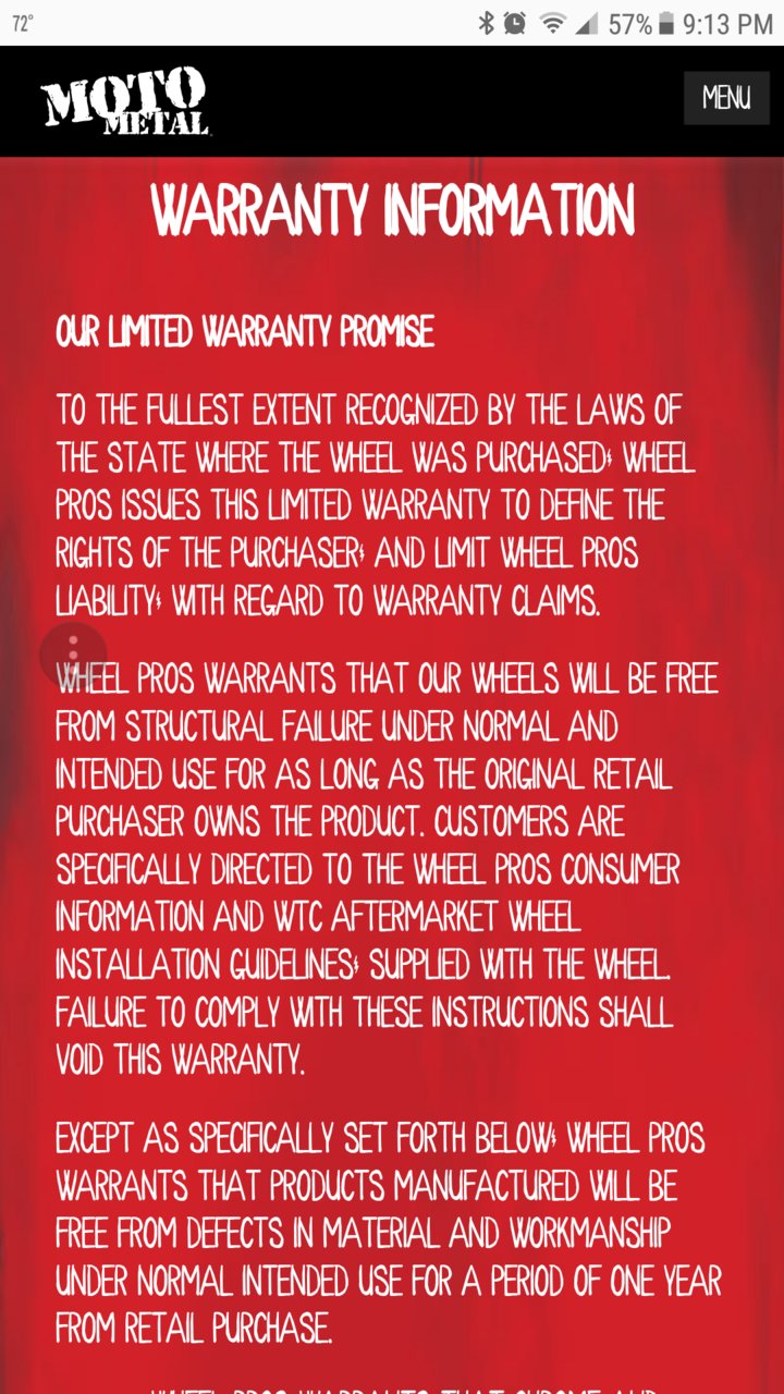

    If you are the original purchaser of the wheels, looks like it should have a lifetime structural warranty.

    I could not tell if these are scratches or cracks from the pictures. If they are indeed cracks, I would definitely check with the manufacturer.

    Those are obvious signs of microporosity my friend. Complete structural issue based on the casting of the wheel. Im willing to bet those things missed a cooling cycle during manufacturing or the recipe was wrong. Either way. I’d be getting rid of them things ASAP.

    OP, Moto Metal has lifetime warranty on their wheels as far as I know. If you think these are cracks, definitely contact the company. I would not drive on them.

    So I called manufacturer about the warranty and they told me to go to one of their dealers to check on the wheel. After visually inspecting the crack, dealer told me that it's only the paint and just advised me to keep on eye on it. It has not gotten worse since I noticed it last Saturday thou.
    Guess I have to start saving money for a new wheel now.

    Sure looks like a crack to me. Paint just chipping off does not follow a line without a crack... common sense tells me that.

    I'd ask the dealer to put that in writing if he's so sure it's just the paint. I bet he won't since it will make him liable if/when things go bad.

    I see cracked wheel the pictures. Not just paint.

    Just because someone sells wheels, doesn't make them an expert. I would have asked to see their Metallurgy Degree specializing in stress fractures, along with their physics degree.
    I'm not really sure why companies put themselves out there like this. If I were the owner of MM, I would just replace the wheel.

    Word! I'm looking at this on a phone and I can still see a crack in the 3rd pic. I'd go to another shop that sells their wheels and get a second person to look at it.

    All of this. The "scratch" coming off both sides of that spoke looks like a crack to me. If something "scratched" from one side toward the spoke, it would be knocked aside by the spoke and so would not be in contact with the wheel to continue scratching from the base on the other side. Just doesn't happen like that.
