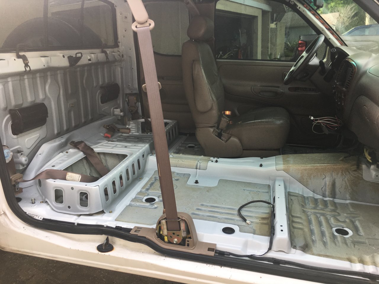

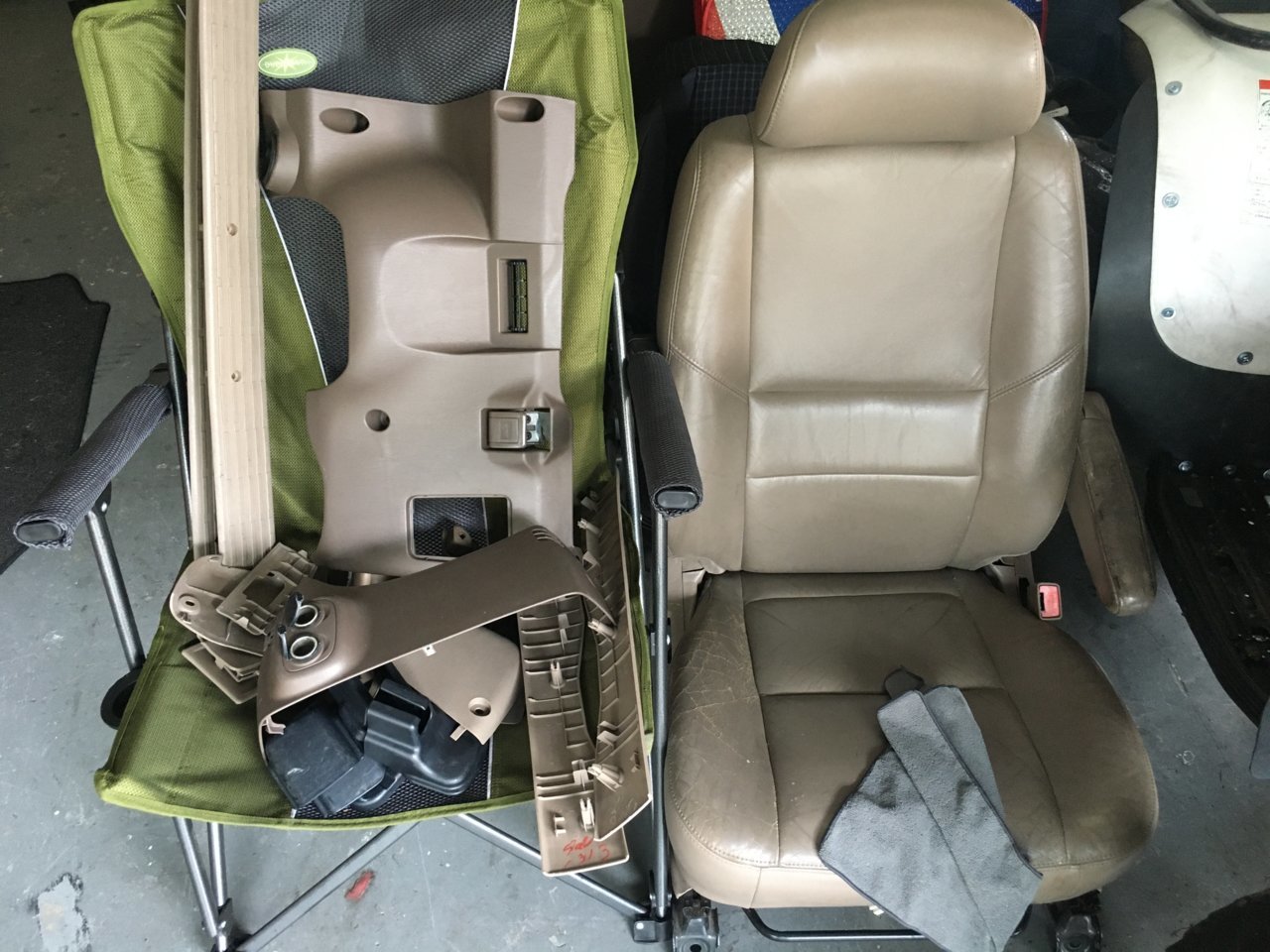

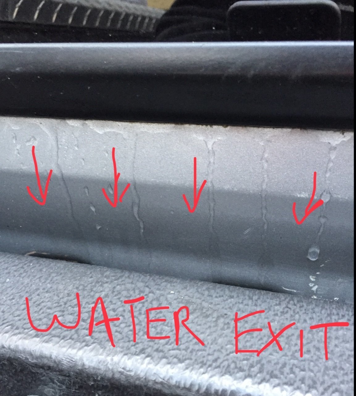

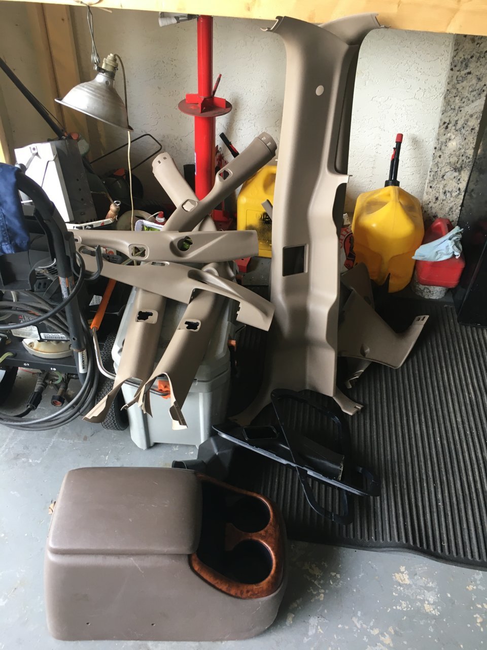

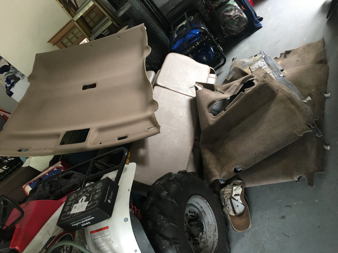

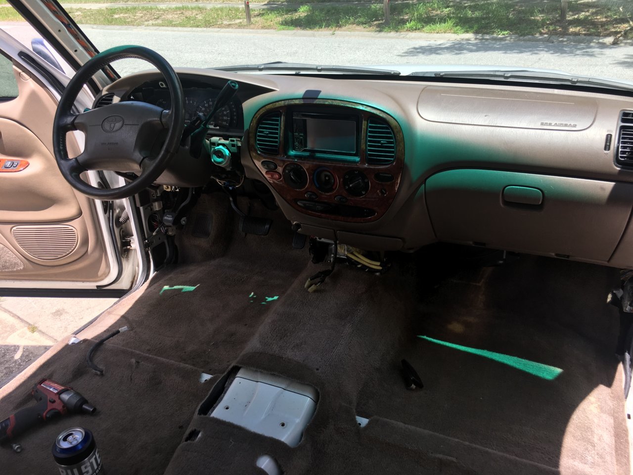

    Just wanted to post my findings. Been lurking and thought I would contribute. Pulled out of the driveway the other day slowly (after heavy rain all night) so I could release the kraken of 55 gallons in my bed liner and on acceleration to my surprise, water pissed all over my coffee cup and phone playing light the torch- die alone (great song) At the u turn which takes 5 min, I whipped out my pocket screw driver and pulled down the map lamp to find the sponge soaked. I drove to work pissed knowing that in the hot sun later on lunch break my truck is going to smell like a dogs ass. This weekend I pulled the interior trim, carpet and headlining and reinstalled the seat knowing I’ll have to drive this way for a few days. Upon inspection no water staining was obvious but with a water test I verified the leak was coming from the front windshield at the top. Also low and behold I found the rear sliding window had water near the driver side creeping in and running down to the tool area. The third brake light was the culprit for the rear and I resealed with Toyota seal packing rtv I had left over from past repairs. Great time to pressure wash the carpet and clean all the interior pieces before installation. Enjoy your week boys hope I helped someone.

    You sir, have the picture (gutted floorpan) i wanted. *knock on wood* my sequoias sunroof hasnt leaked yet, but i would appreciate pics as you go.
    my bad, i guess thats shiny sound deadening in the ceiling.

    Oh and for those of you who want to do a “weight reduction”.... the sound deadening from the factory is top notch. I can’t believe the noise with no interior.

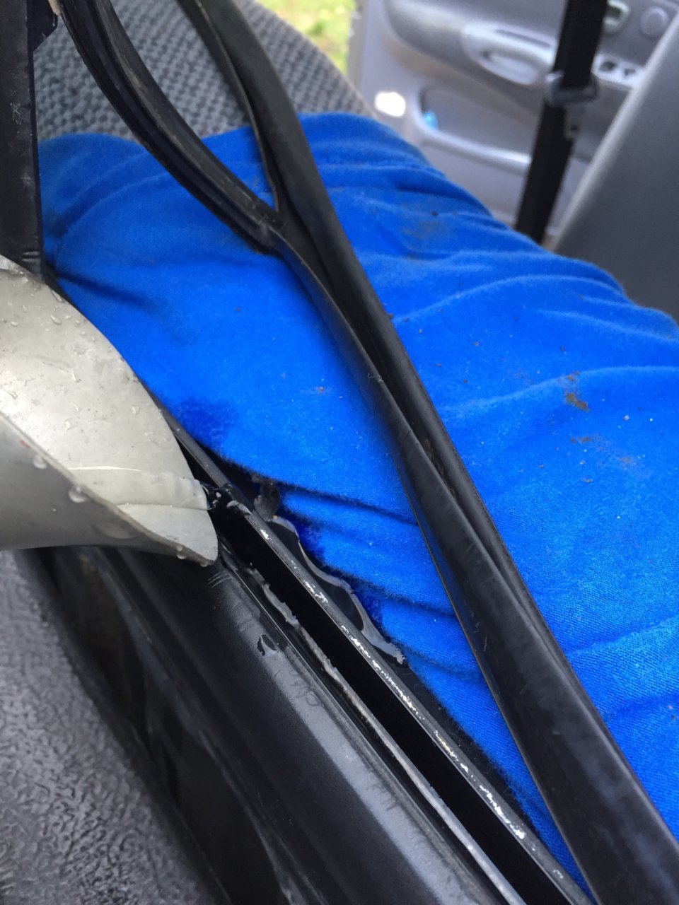

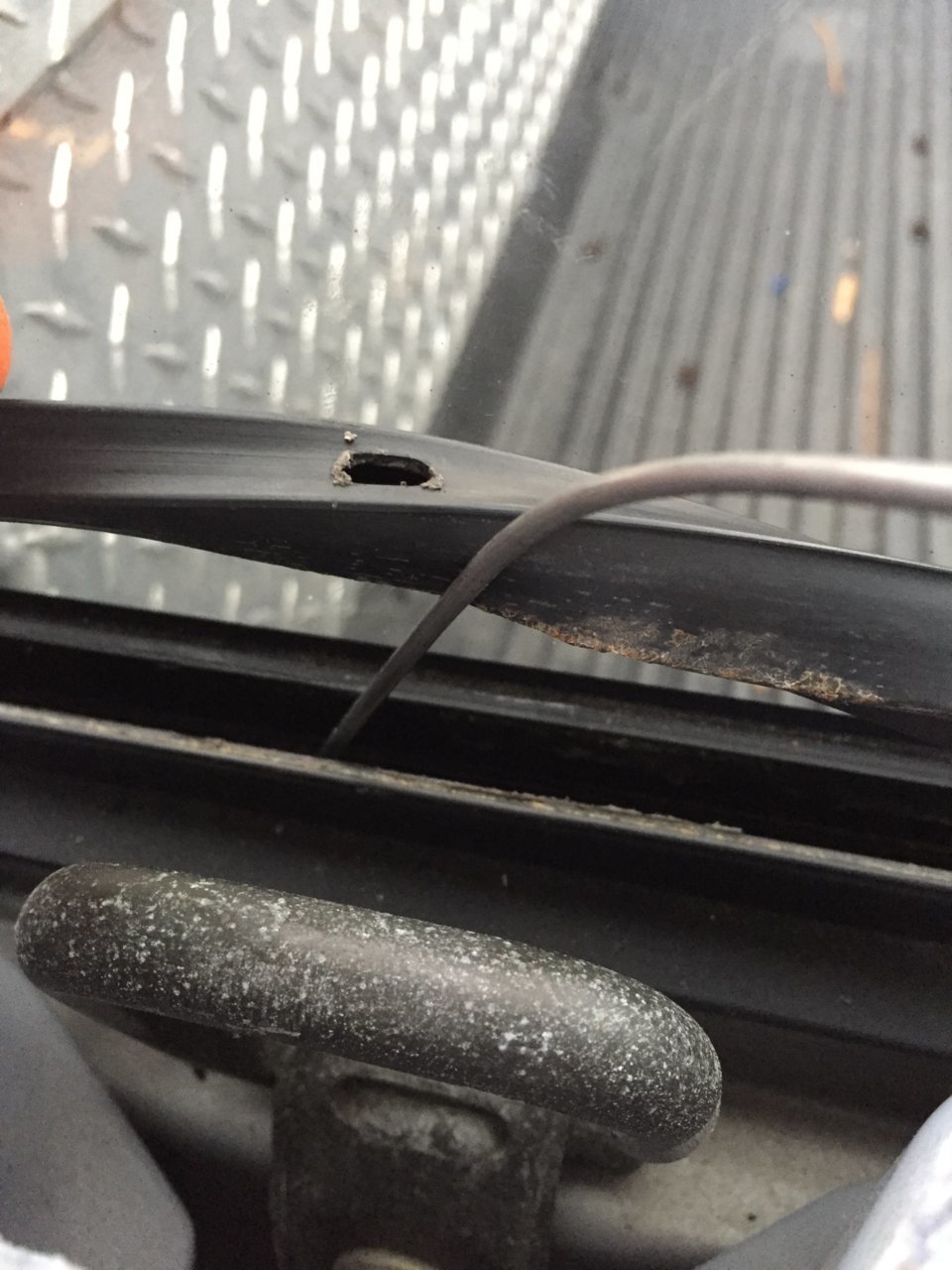

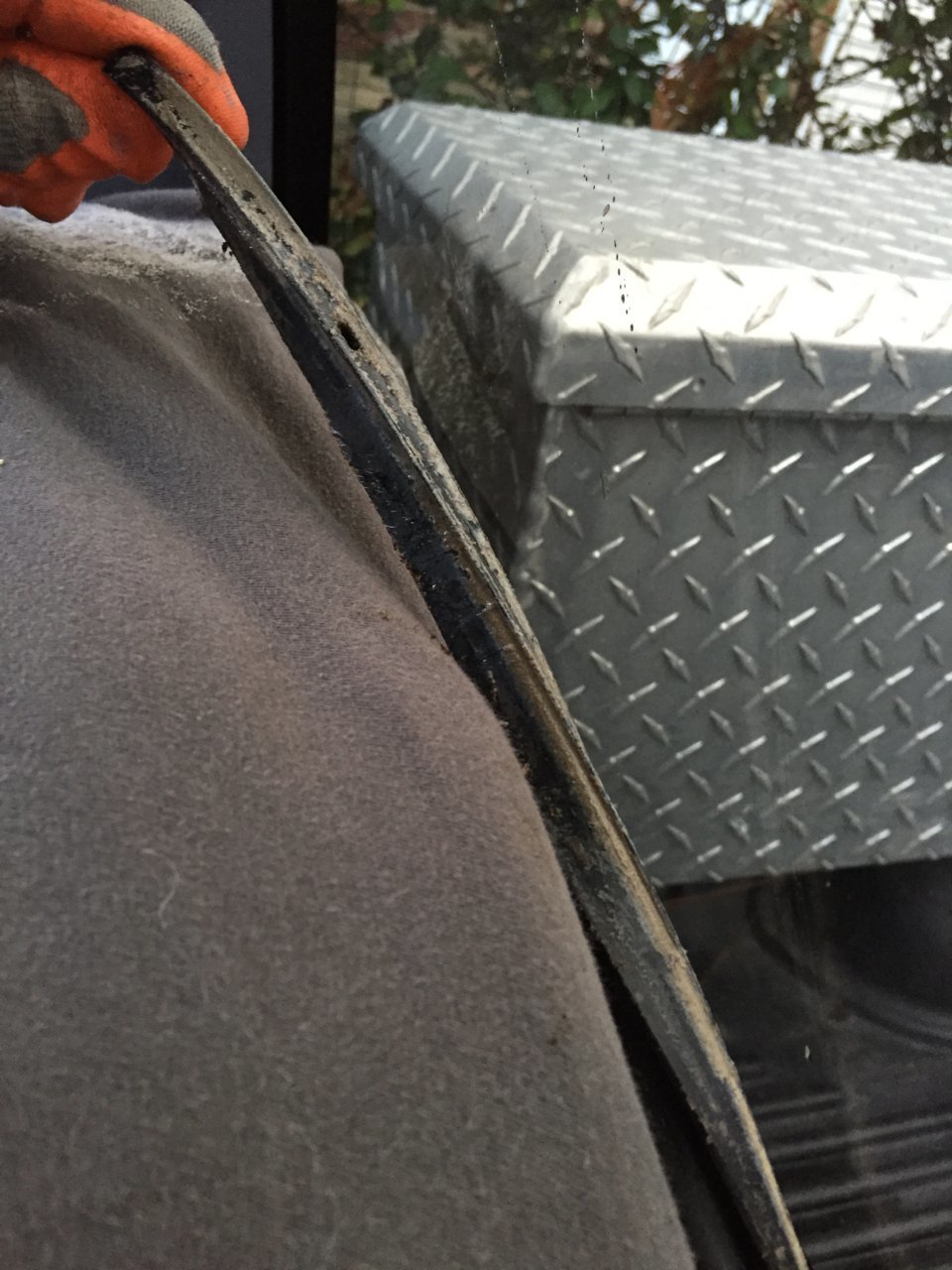

    Pull and Clean that Rubber Gasket of the sliding rear window and clean/blow the weep holes. Should drain out of the invisible gutter system (behind bottom window trim).

    Thanks for the tip on the hidden drains 2 if the 4 were clogged. I woulda never known they were there!
