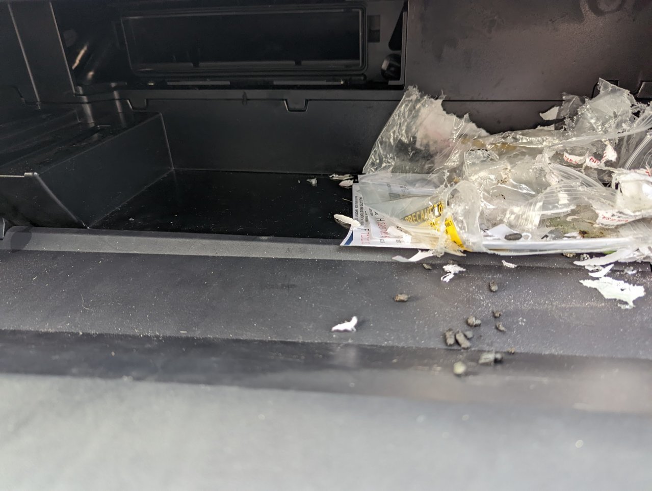

    I pulled the cover in the glove box and the filter looked like it blew itself up, a piece about the size of a softball was missing and got shredded in the fan blades.
    At first i thought that it was a rat, but we dont really have issues here and i couldn't see any chew marks or any other nesting material in the filter or any pee smell

    I used a shop vac to clean out the squirrel cage until i couldn't hear anything bumping around.
    I'm worried that a rat got in there and chewed something on the heater core, but couldn't find any evidence of it. We did just get back from a week long vacation and the truck was sitting outside like it always does.

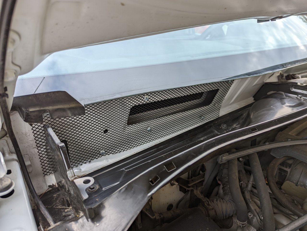

    Might wanna rethink that just to prevent what could be a bad deal. Not too hard or expensive. The opening is about 2"x about 7". I used 1/4" hardware cloth and self drilling sheet metal screws to fasten it to the firewall. Took about two hours but I'm a bit short and my truck is a bit tall. So, a little awkward but it brings peace of mind if nothing else.

    I may have to do that....
    Any pictures on where the inlet is?

    Directly behind glove box a few inches below the bottom of the windshield.

    I ordered a bosch hepa filter to replace the destroyed one. I left door open to the cabin air filter and the little shit head left me a present over night while i was waiting for Amazon to deliver the new filter. I found a single rat turd on my engine cover, but no other signs of intrusion (other than the glove box). I tested out the defrost again and no gurgling sound so i think the heater core had emptied itself over summer.

    To home depot i go to get some wire mesh....I also noticed there is a hole on the drivers side a well. I covered that one with the remaining mesh.

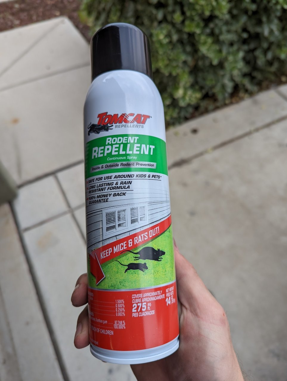

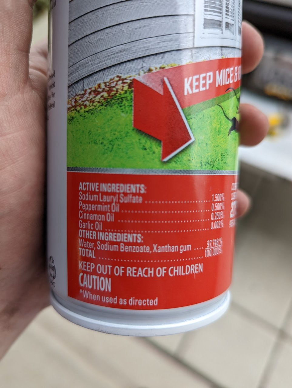

    While i was at home depot, i grabbed some bait boxes for the front of the house and found this stuff
    BB3wiQhzpmvyIbEjzQBOYkx1jnQb--OIazVHaPRR_c6c2779c6ee50e36b0d12c30797302abde9308b4.jpg
    fS_e8zfvFDhbeQW5mL597f4To_gGtLepw4oy7jpd_d031411f5ce67f4b5f35522787def92fe4d9f13f.jpg
    I doused some cotton balls and tucked the under the cowl kinda away from the intake for the cabin and also doused the perimeter of the engine bay and wheel wells.

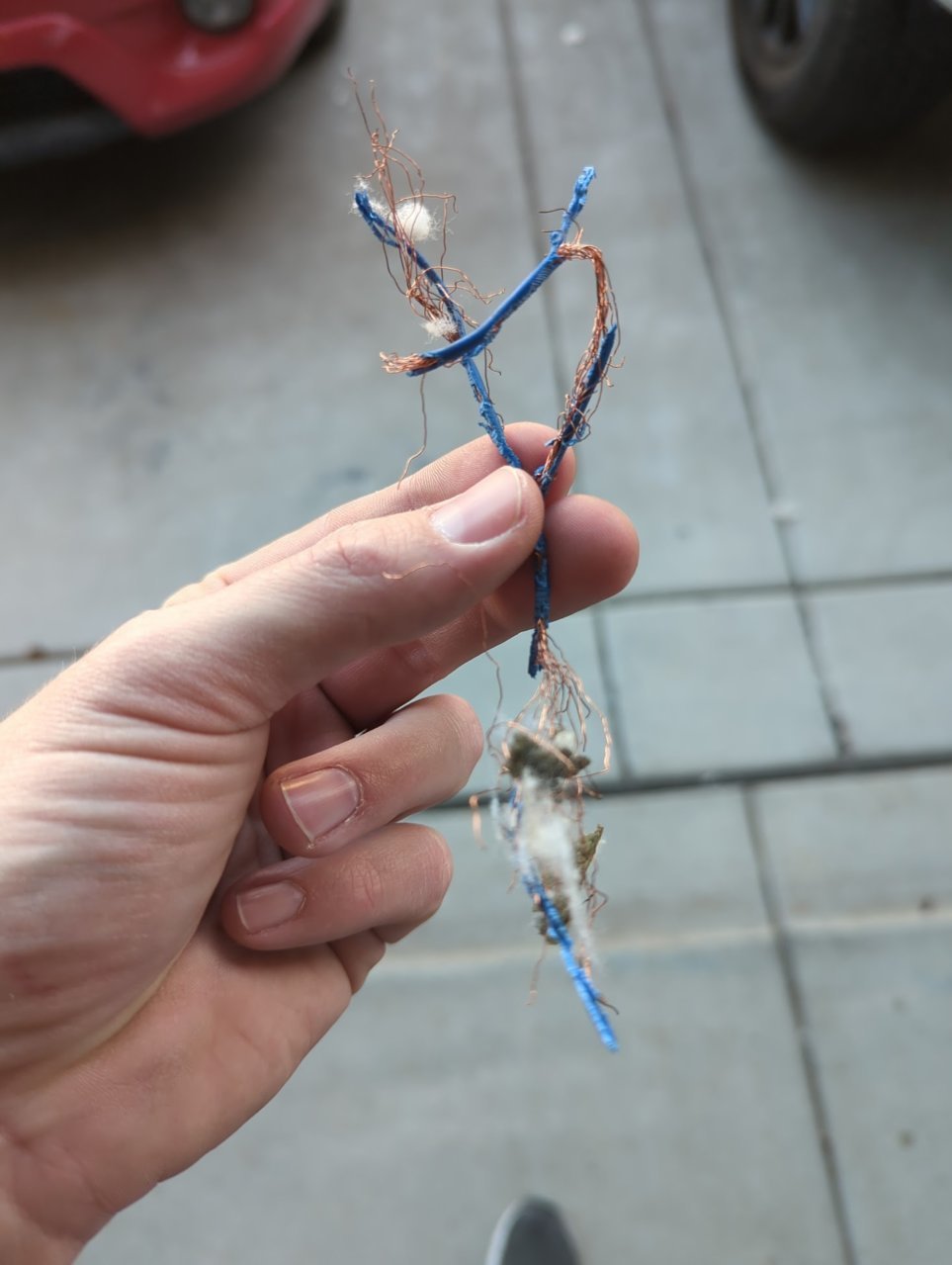

    Well, little fucker is still there.
    I noticed some little pieces of black stuff under the front of the truck on the ground.
    Popped the hood and found this. luckily it was just a headlight wire that was easy to patch.

    Yeah, they didn't seem to care about the peppermint/cinnamon/garlic spray.
