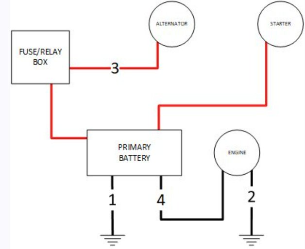

    Anyone knows where are the ground points in a 2010 Toyota Tundra. I am wonder if I am missing one that is making the vehicle not to start in the morning.

    1. Right next to the battery bolted to the body
    2. Passenger side near the air intake
    4. Near the oil filter and connects direct to battery
