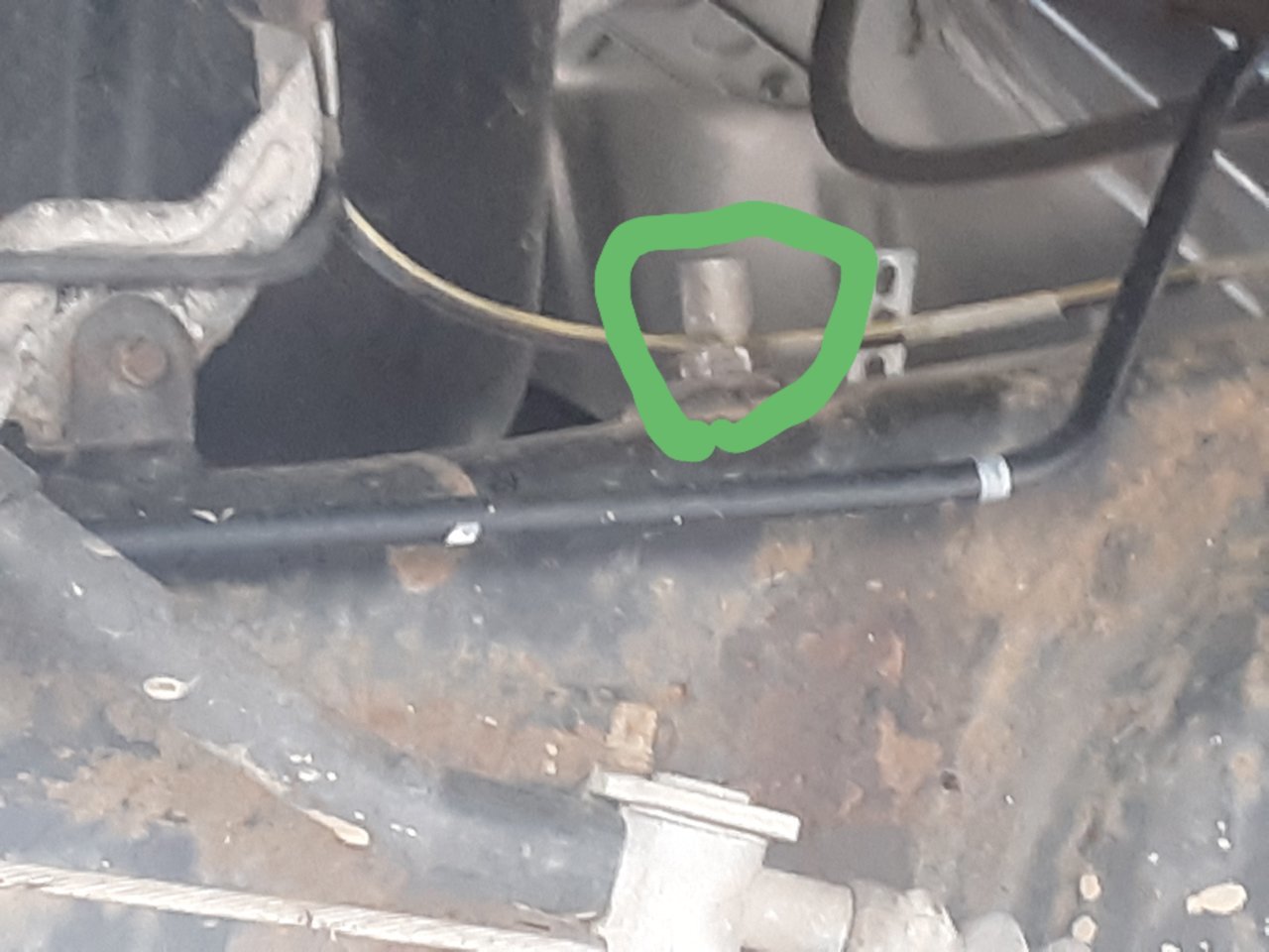

    Another thing people have mentioned is the breather plug on the rear diff. I think it kind of acts like a rocker top on a pressure cooker but not sure. Anyhoo I guess they can get filled with gunk and stop working. There is a mod posted on here that people do to put the vent higher up I just unscrewed mine and ran brakecleen and little compressed air through it. Seems to work fine
    3.4Tundra[OP] likes this.

    Ok, when I unscrewed the fill plug, it was pressurized. The diff was cold when I did the work, it kinda sounds like my breather may be plugged...

    It's normal for the diff to be a little pressurized because that breather has an internal spring.
    But check your breather to make sure it functions and isn't stuck shut!
