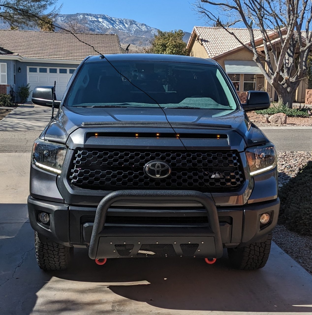

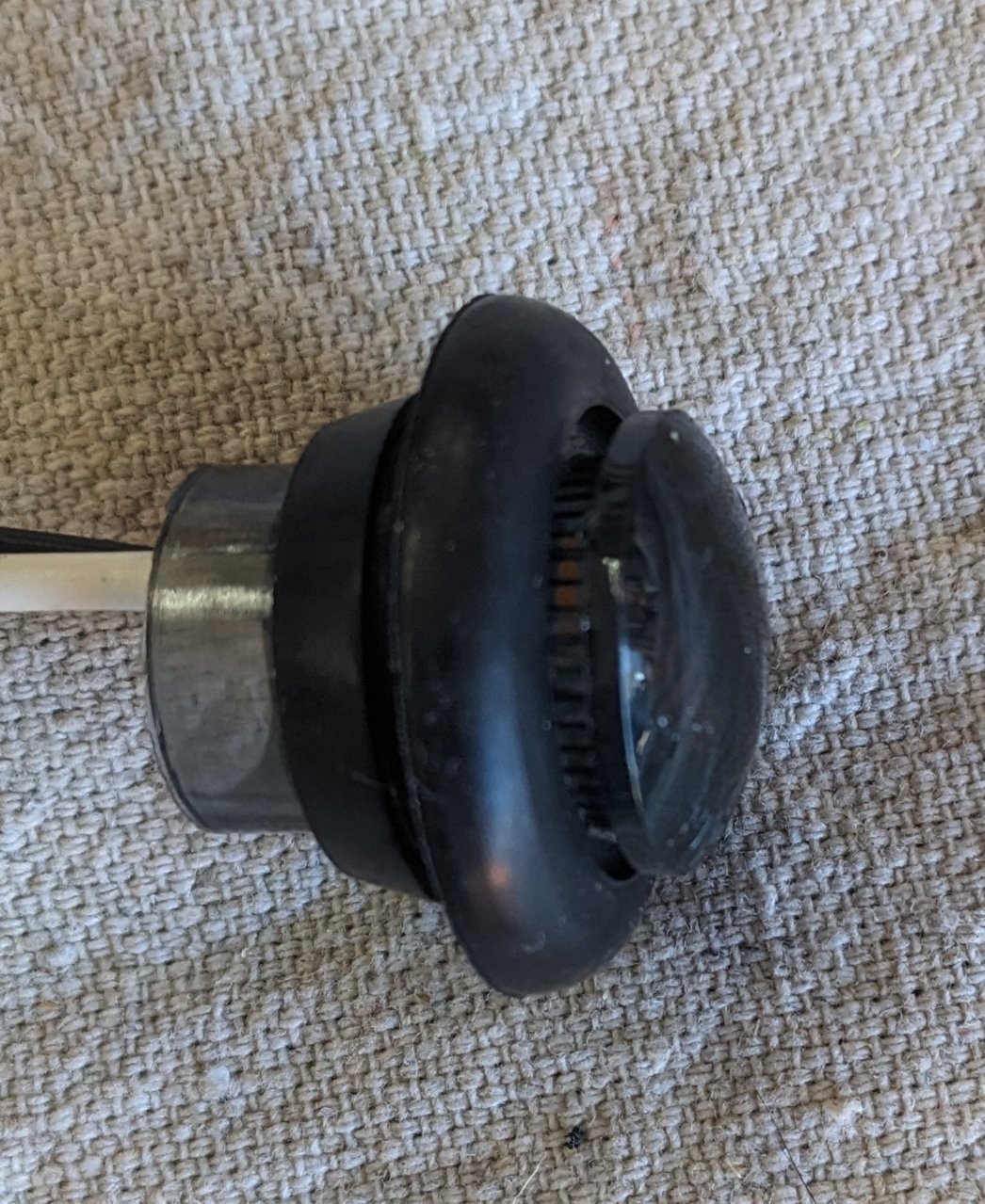

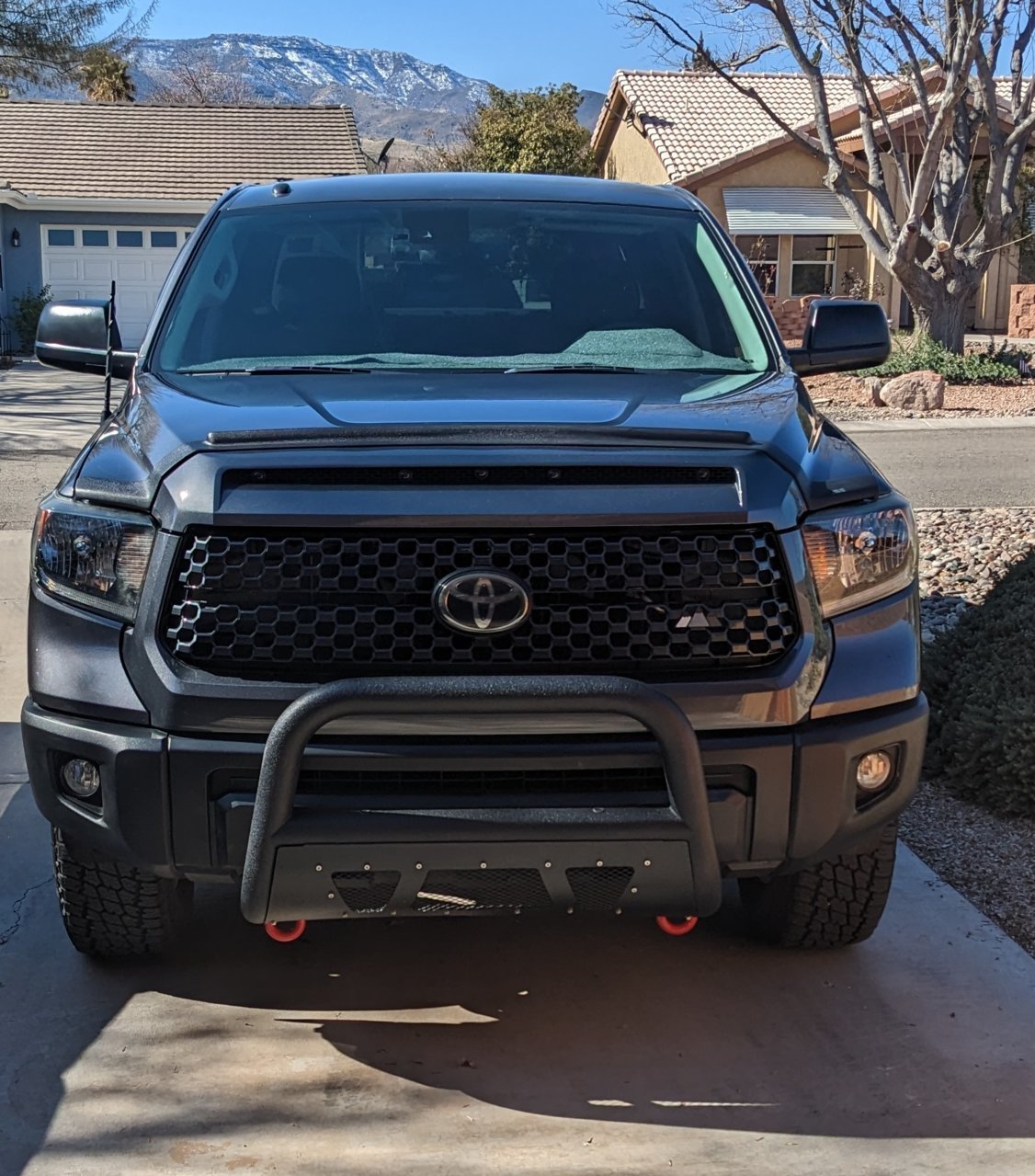

    After a lot of indecision and crap posting asking how to wire grille lights I just went ahead and installed them today.
    It took me about 3 hours and 3 beers. I went with the little 3/4 smoked button lights because it it hard to tell they are there when the truck is off. They also installed easily with just a 3/4 inch hole drilled into the bulge mesh. I ran the wires through the back side of the bulge rear cover and zip tied the wires all up. The wire to the fuse box is ran though the hood inside wire loom covering. I finally just decided to hook them the the IGN fuse using a fuse tap. The lights were $16 for 10 so I have spares, and if they go to crap I can always just replace the whole bulge mesh screen.
