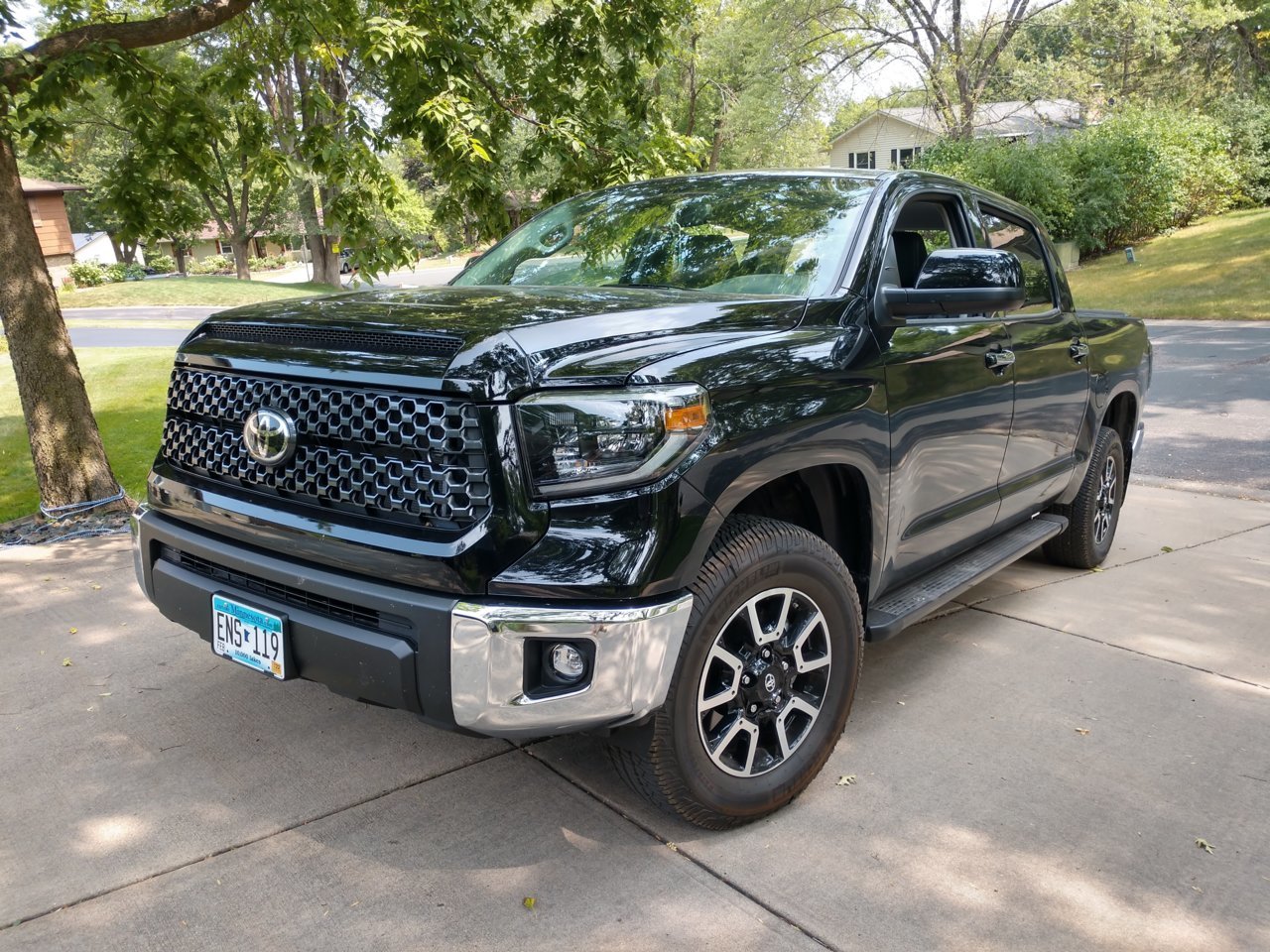

    I bought the black Platinum grill to replace the chrome Limited grill on my truck. The emblem/garnish swapping over to the new Platinum was very easy, and it looks great! IMG_20210817_134737436_HDR.jpg

    I replaced the chrome grill on my 21 SR5 with a new Platinum grille with the glossy gray honeycomb (53101-0C041). Used the existing sensor with no issues and very easy to do as others have said.
