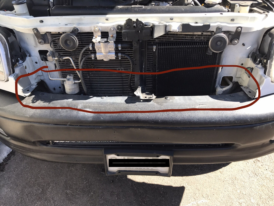

    I too was going to replace my grille with an insert. After watching how ‘easy’ it was, I opted to keep looking. I finally found a few guys that had updated their grille to the news style with only slight modifications.
    I bought this grille here:
    https://www.ebay.com/itm/EAG-Fit-fo...od-Grille-Black-Stainless-Steel-/284126634674
    This emblem:
    https://www.ebay.com/itm/Toyota-Lan...rille-TOYOTA-Emblem-75311-90K00-/282708209809
    Cut this piece with a dremel in five minutes:

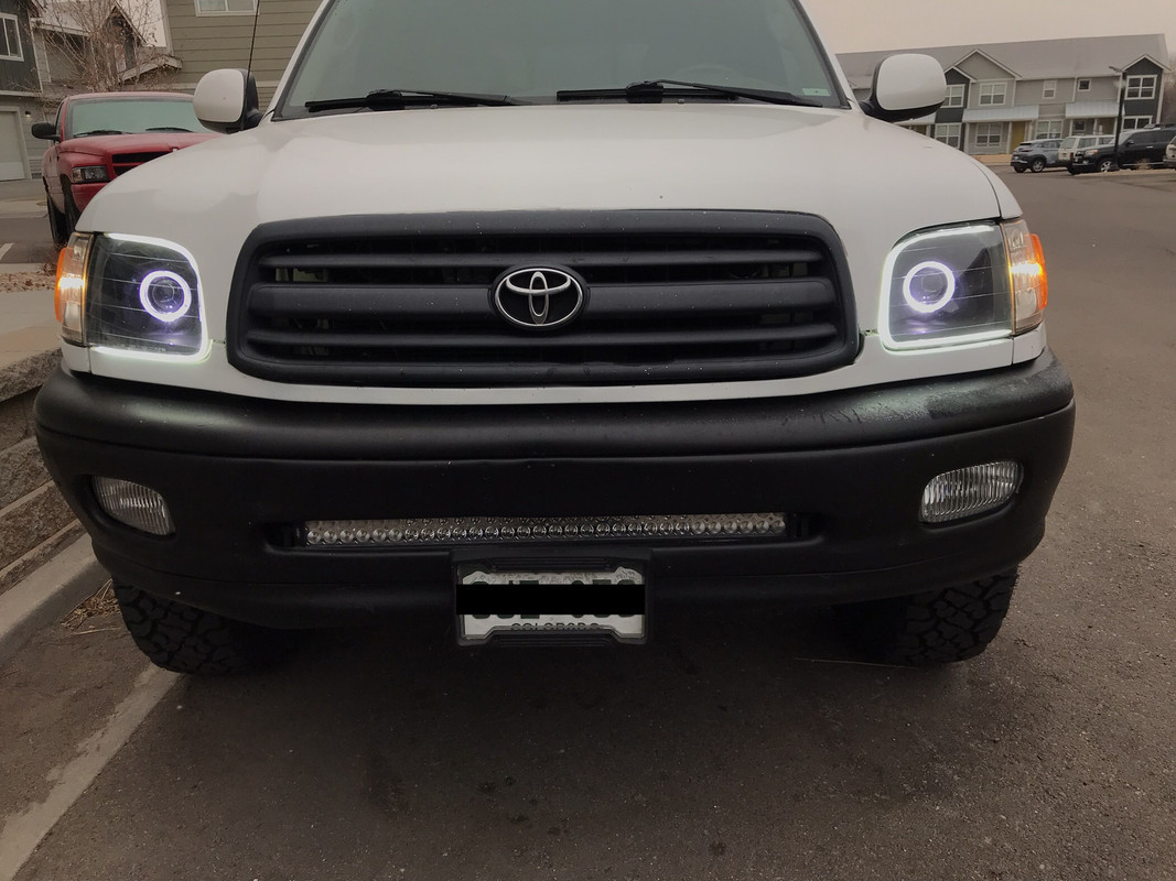

    And went from this:

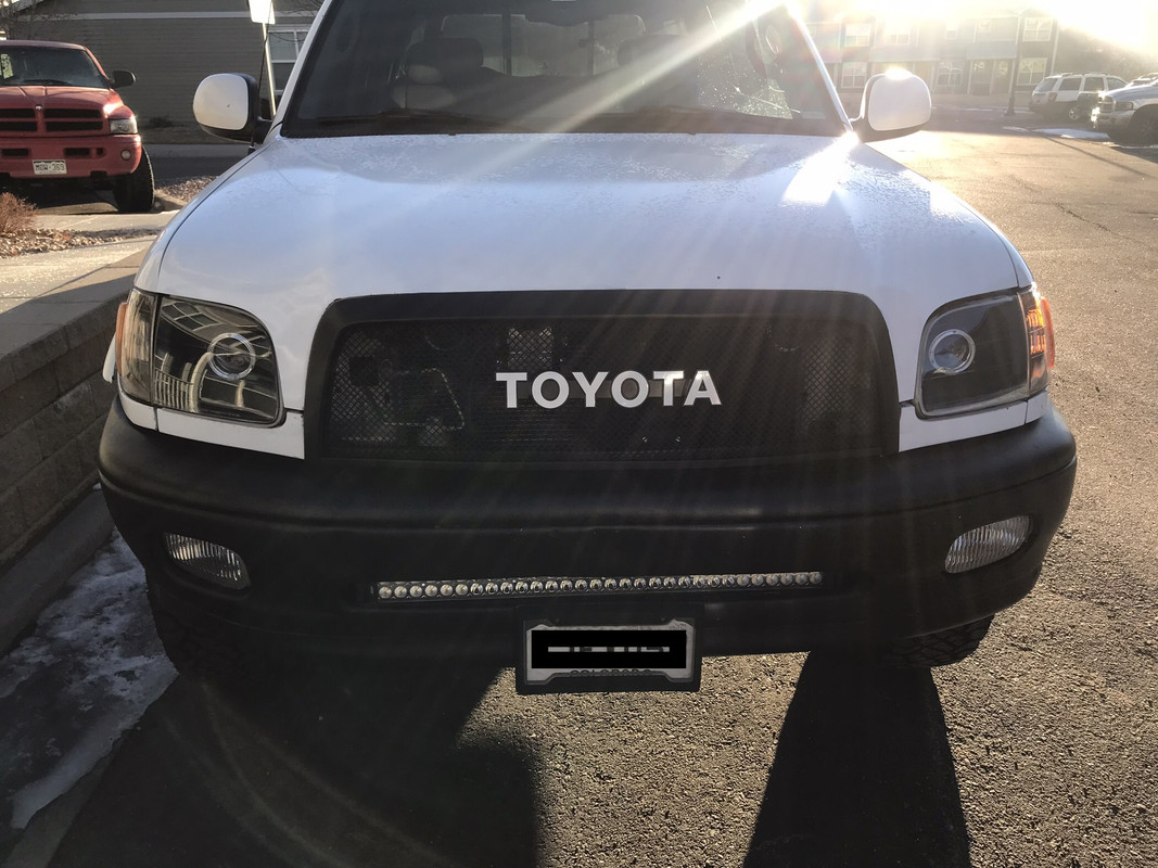

    To this:
    Other than dremel work and using longer bolts for the catch handle, it’s a direct fit. Install only took a little over an hour and I was milking it.
