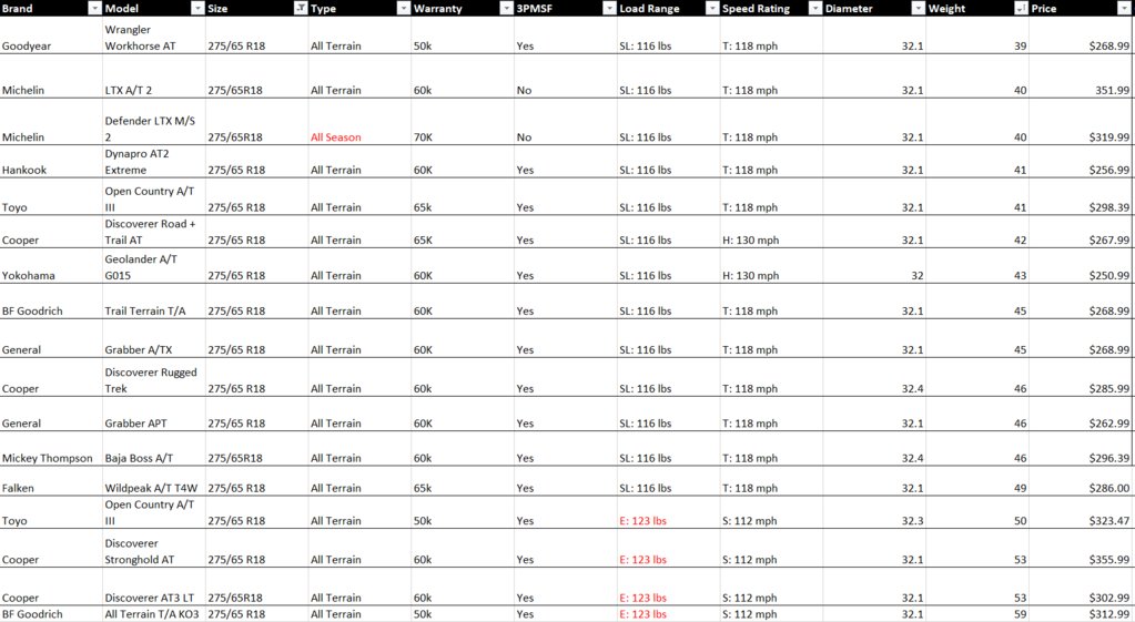

    Quick search on a third party site so double check but,
    275/65-18 tires under 50 lbs:
    40lbs Michelin LTX AT2
    42 lbs Bridgestone Dueler A/T Revo 3
    44lbs Cooper Discoverer AT3 4S
    Had a buddy with the Discoverers on his Jeep that swore by them in the winter.

    This is an amalgam of all terrain tires in size 275/65R18 from lightest to heaviest. Jumping from an SL up to XL, C, or E load range "significantly" increases weight. I know a lot of people like the Toyo Open Country's. New from Cooper that piqued my interest are the Discoverer Road + Trails. Lots of options but there's always trade offs.
