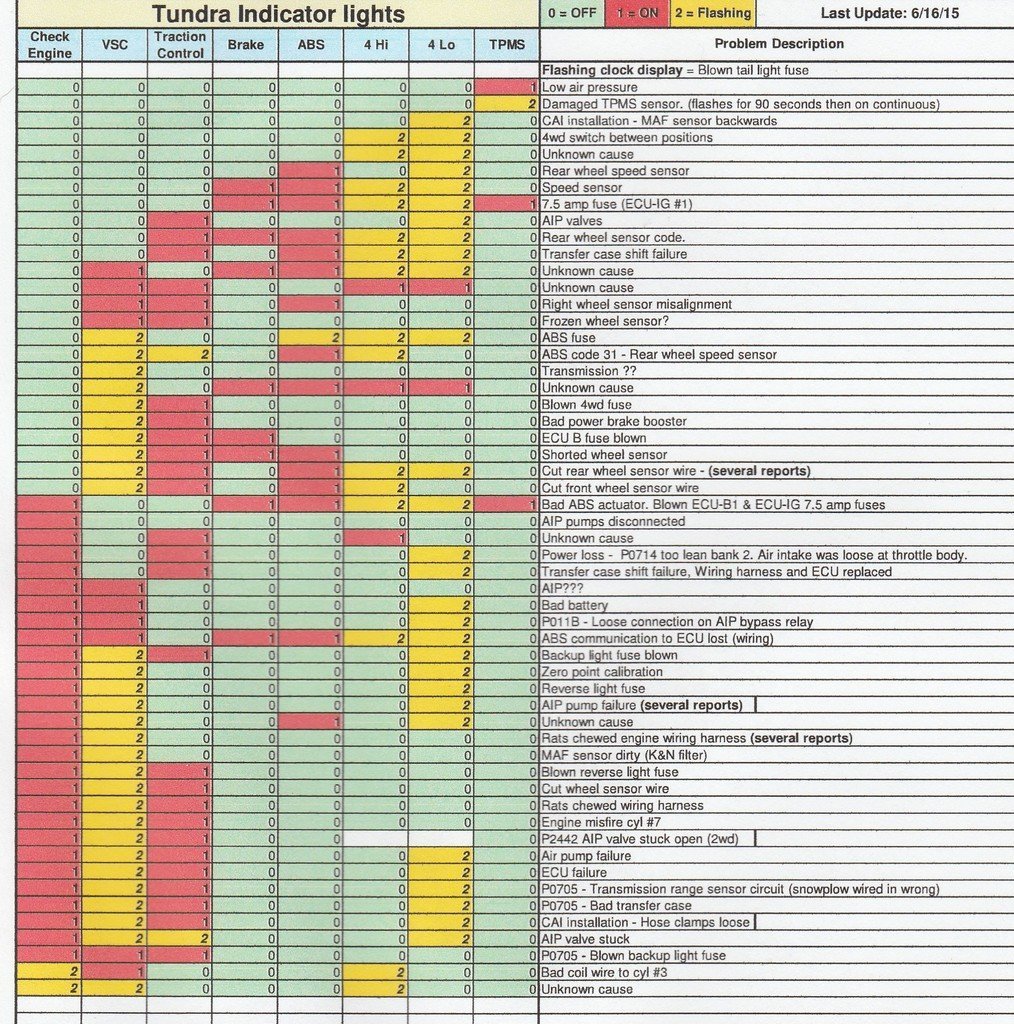

    Somewhere in this forum is a code breaker chart showing what all the lights mean. Just a guess but I think something got pinched during the rollback ride. Get your dirty duds on and crawl underneath.

    I found this somewhere(?) so might as well make it available again. :)
