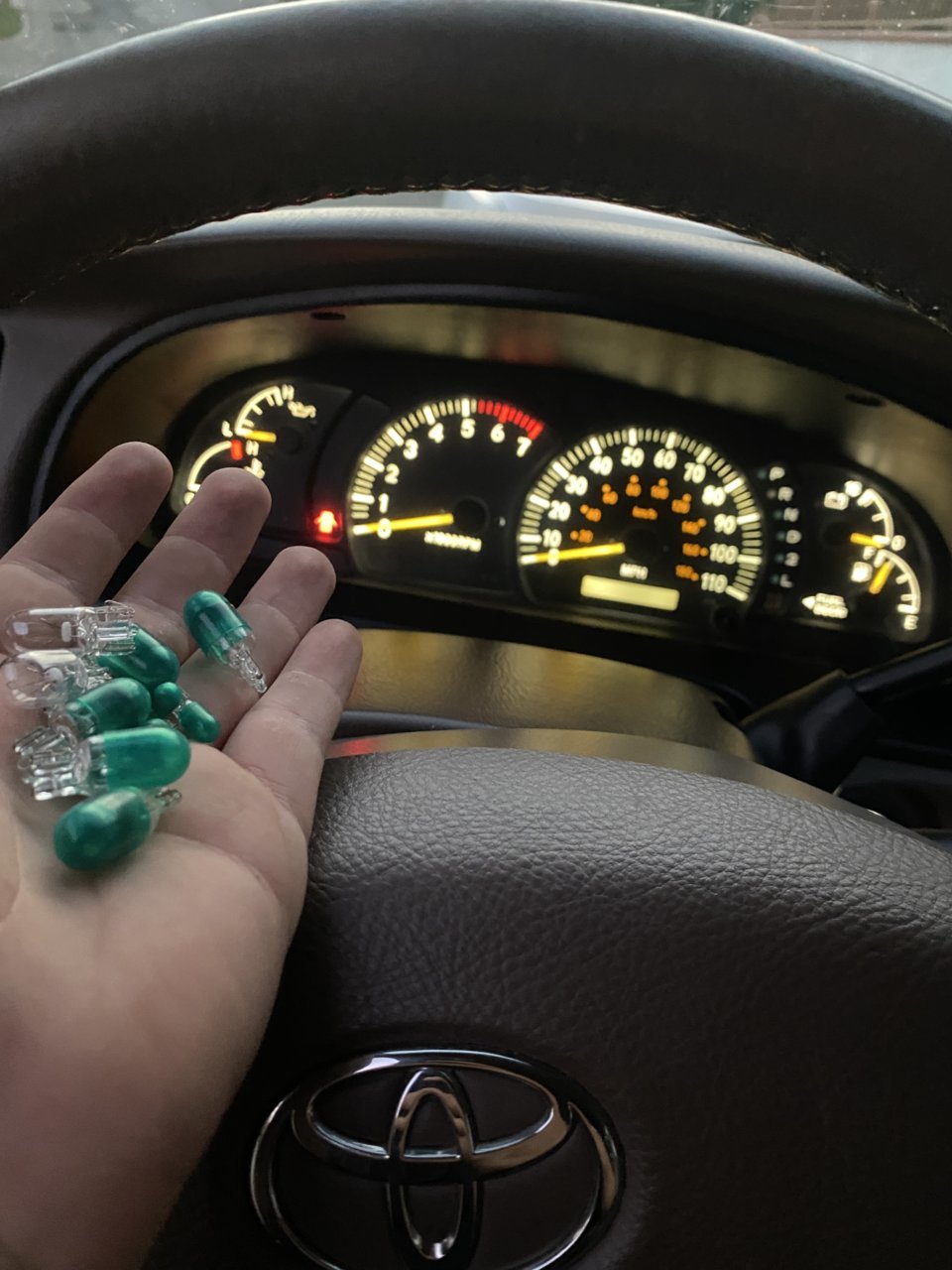

    So I just got a 2004 Tundra DC Limited, and I’ve already done one mod, interior LED conversion. (check photos)

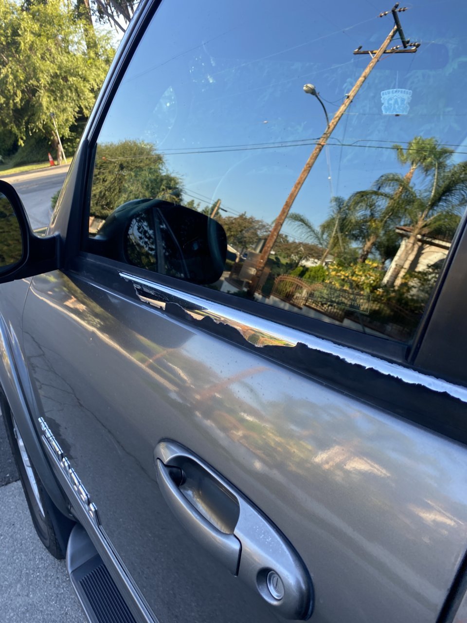

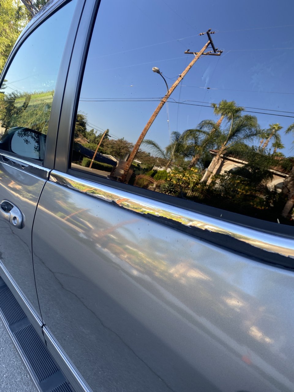

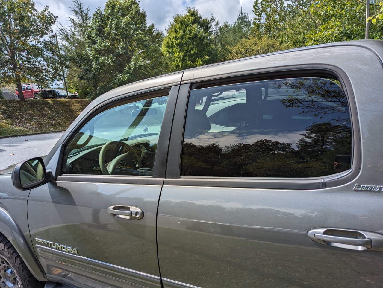

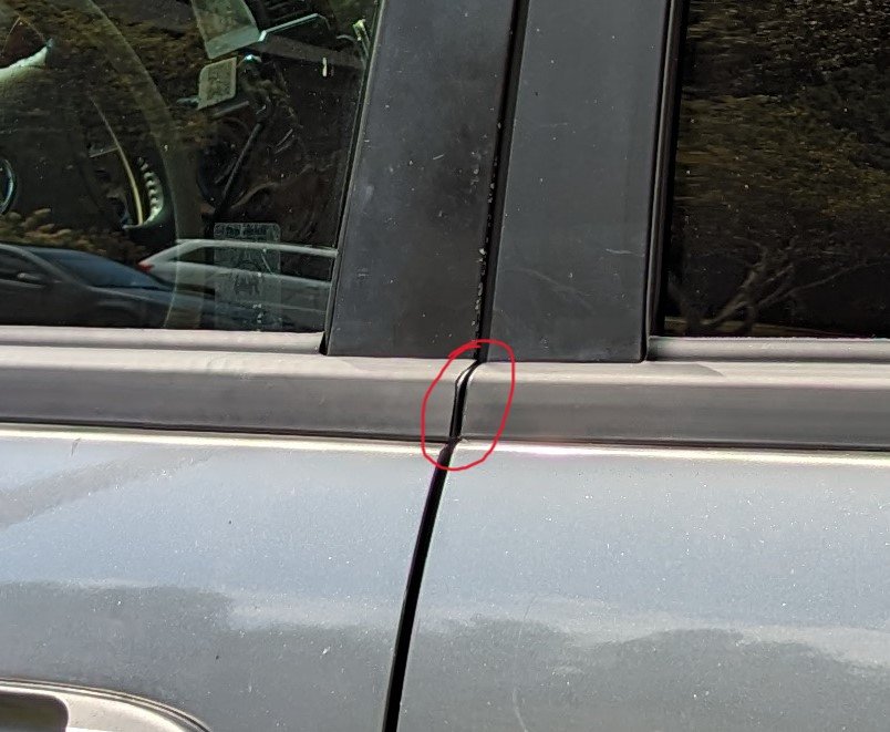

    Also, how can I fix this window frame peeling off? (check pictures)

    Possibly but it may not look great and may not hold up well. I think a few people have tried painting or coating it.
    Myself and others opted to replace them instead. They are pricey though.

    What about talking them off and sanding them and then painting them with like bed liner or something like that?

    (3) For your window trim, watch this video.

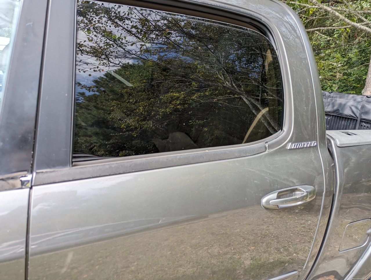

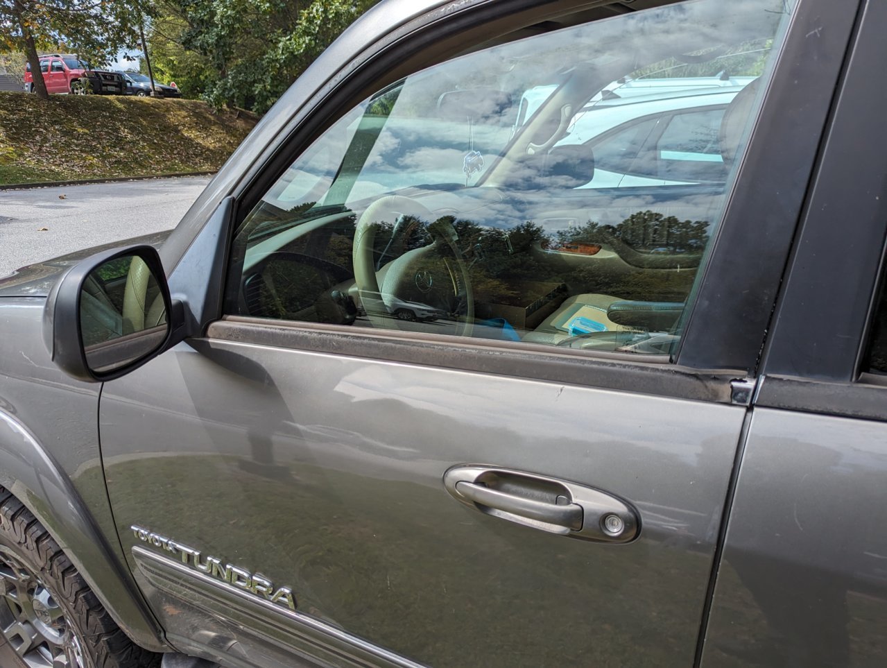

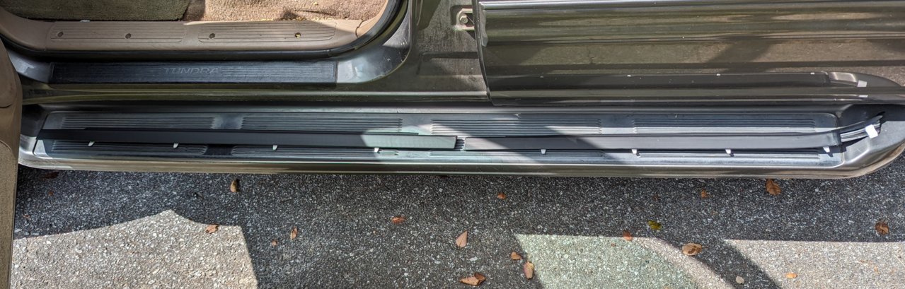

    I got aftermarket replacements yesterday evening. Saw your thread so I went outside and swapped them out. I'd give these 4 out 5 stars. They fit great and sweep the windows perfectly. Finish isn't perfect in one spot but good enough for a 19 year old truck. I would not have spent $600 for OEM molding but $100 is worth it to not have to sand and paint if that even holds up long term.
    https://www.millsupply.com/auto-bod...rip-kit-4-pieces-left-right-side-39700227.php

    Lol am I the only one who’s a fan of the original retro green dash lights? Maybe I’m just weird.

    I do like the retro green dash lights myself!

    Nope, looks like an old ferd danger dash to me. Had to go.

    I think it reminds me of the instrument clusters on some of our jets so I f’k wit it lol. Not to mention y’all be blinding me on the roads already with your Godzilla headlights so I’m happy with how dim it keeps my cabin ;)

    I tried blue for dash color, absolutely terrible. Tried red. Meh. Just off white was the most pleasing with the needles painted red.

    The window trim is spendy as hell, I'd sand or strip the remaining off, scuff-sand, mask it off and respray with Rustoleum satin black outdoor paint. Costs you nothing but time.

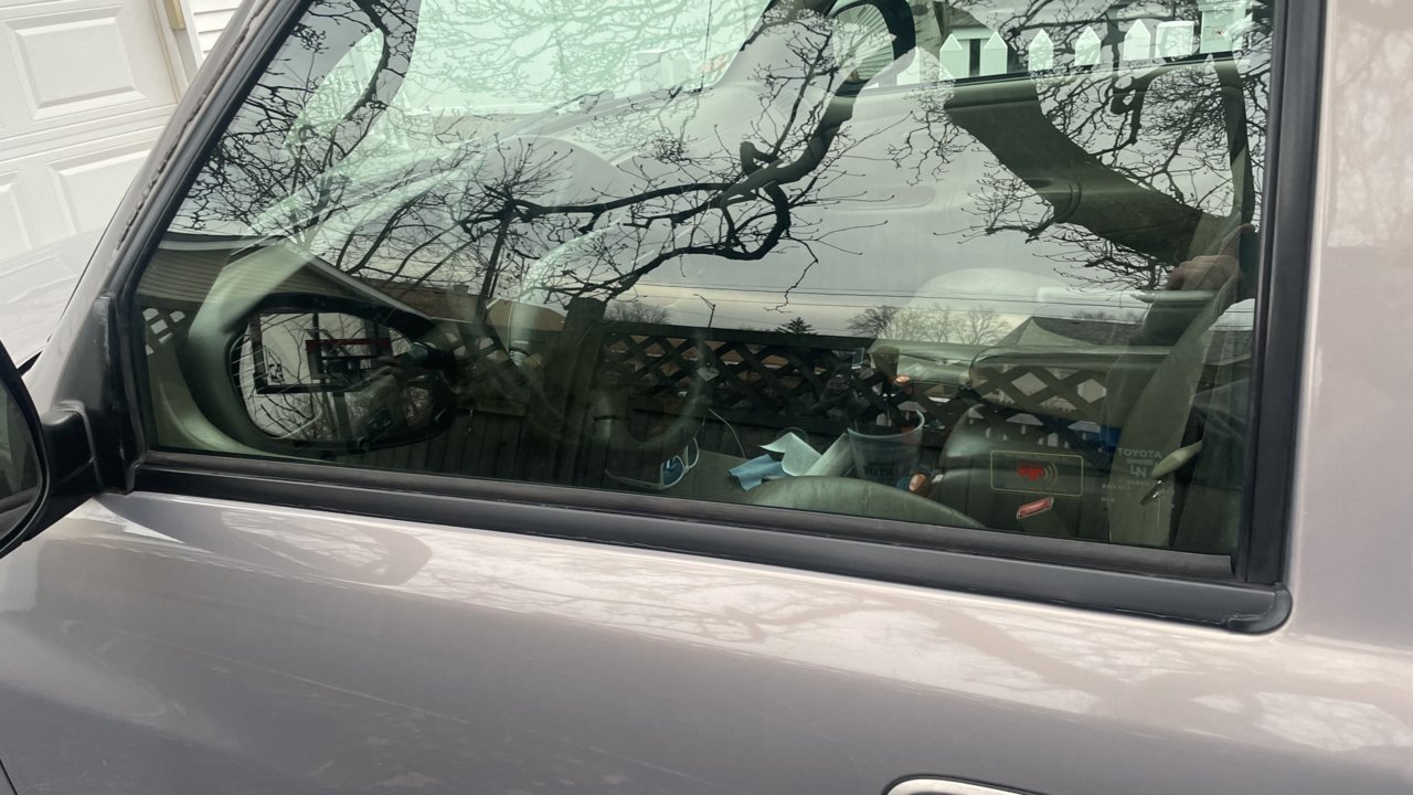

    I repainted my trim pieces with them on the truck, and it was a major pain. Just pull them off if you’re going to repaint.
    With them off the truck, it’s easy to sand off all of the old stuff, and even easier to put the new paint on. I used plastidip. I think it looks great, and they’ve held up well since January.
