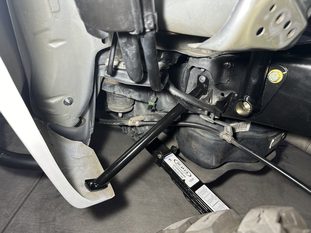

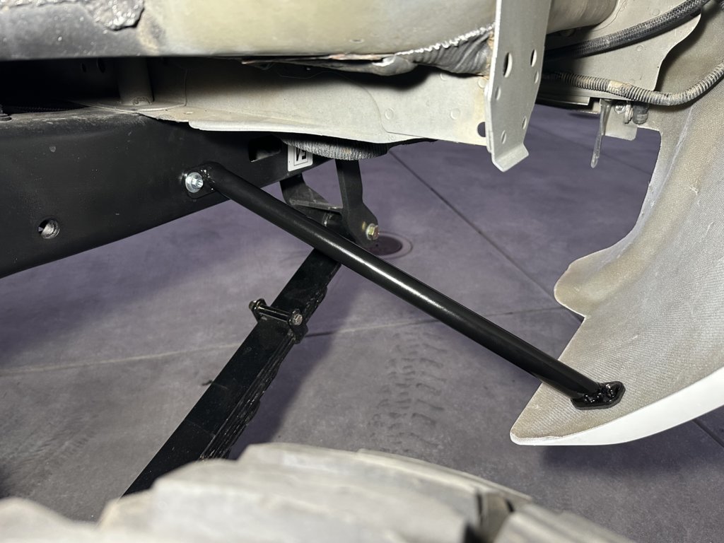

    Here is my version of beside supports. 1” 4130 tube and 1/8” plate. I used some 1/8” rubber material in between the fiberglass just because. Bolted to the frame with the factory drilled holes.

    Soon you’ll be out https://youtube.com/shorts/m14UpfiMRZk?si=fIURP7BU3XuhgYOl

    Highly recommend that you build a coil tower brace….

    I really do want to built an engine brace but I need to at least buy the Camburg Bypass mount because I would probably add on from the top of that mount. I guess I could just buy the mount with no bypasses for now to get things rolling.

    Oh and do motor mounts. Way easier to install before the frame gets all out of whack.
