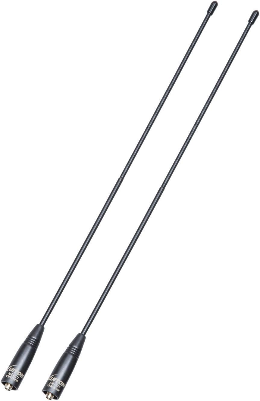

    these are the radios (I have upgraded antennas on them - pictured below)
