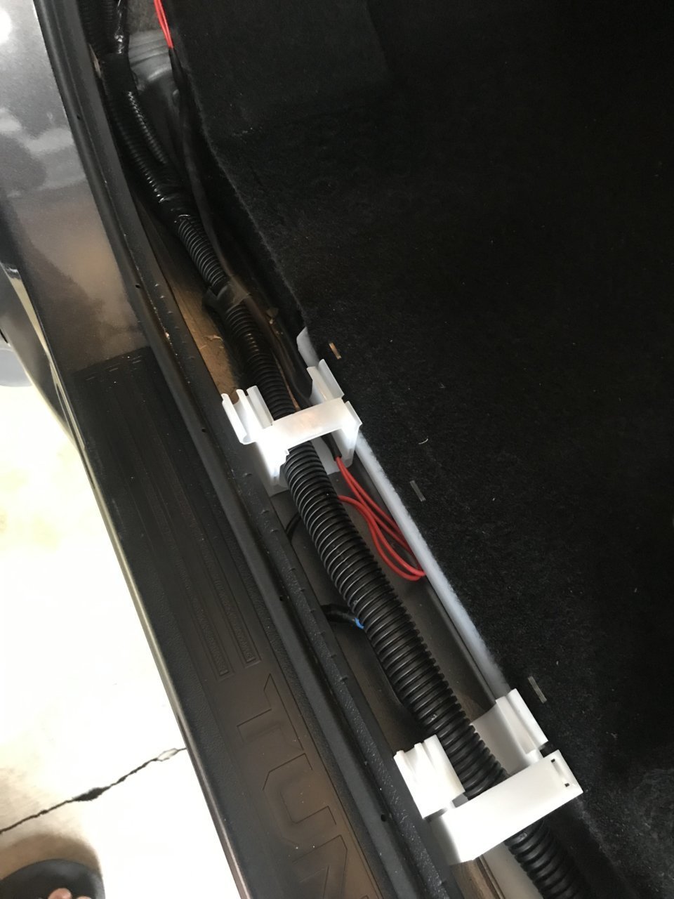

    One pink wire should work. You'll be tapping the same circuit as the rear bed light. Pull the driver side threshold/rocker trim and pull the wire loom open. You'll see a couple of pink candidate wires. I used a positap, and got lucky on the first try.

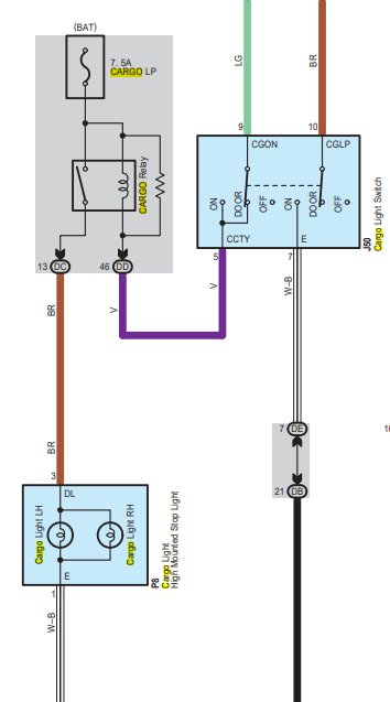

    Should be a brown wire that goes directly to the cargo light in that threshold.
    But I agree with @RobertD
    That footwell light will come on when you unlock the doors and time out when you close the door.
    It also dims on and off..
    I used it for my puddle lights..

    I appreciate all of the help, but my puddle lights stay on constantly when I tie in to the foot well light, and will not shut off for any reason. I looked for the brown wire, running in the door seal. And I believe their is at least two if not three brown wires there. I am definitely hesitant to start tapping into each wire, especially the real small ones and possibly fail. I really need some help. I’ve also watched the video which brings up why and or what are the blue wires for and what’s up with the white wires getting hooked up on the passenger side Trying to figure this out.

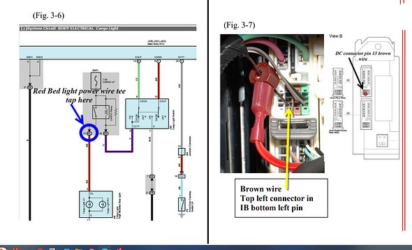

    Do you have bed lights?
    When I installed OEM bed lights in my 2014 I used these OEM instructions.
    It tells you where to find the leads you need under the dash to tap into the cargo lights for the bed lights.
    Page 7 but I would look thru the entire thing to get familiar with it.
    It is actually where the brown wire begins.
    Part Number: 00016-34021 (sparkstoyota.com)
    If needed I can get under there maybe tomorrow and take some pics if you want..
    I've since replaced the crappy OEM lights with better lights, but I used the same wiring..
