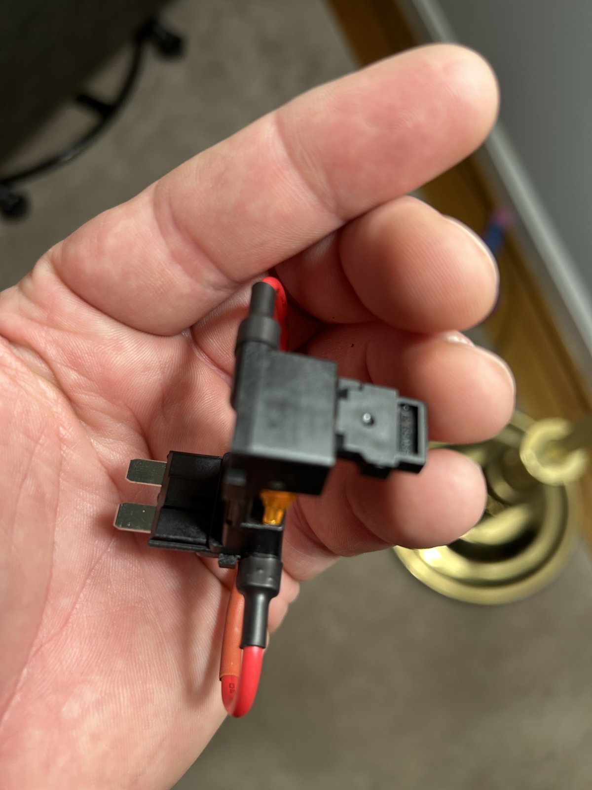

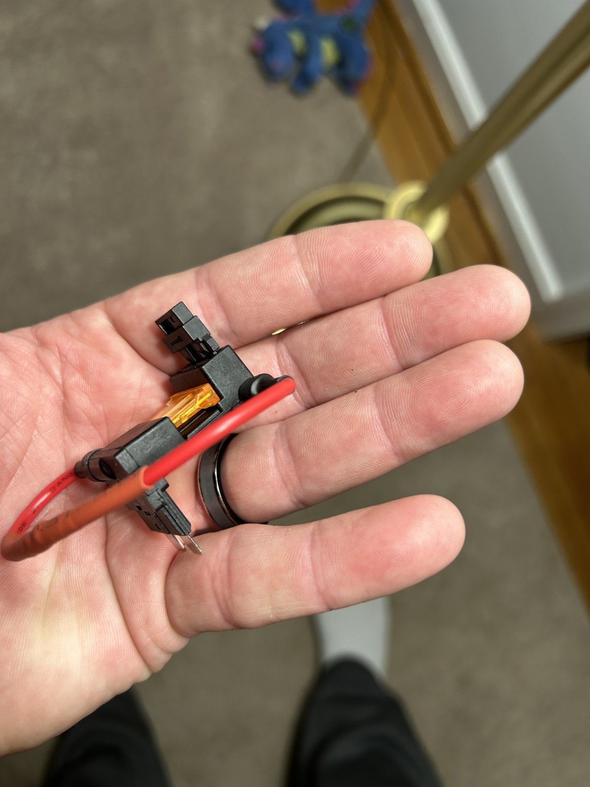

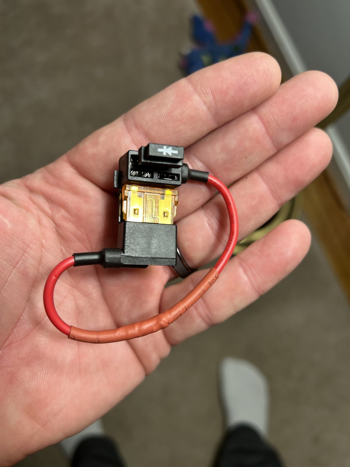

    Ok so I think I have this correct but checking for confirmation. @BiggHertz is this correct? IMG_0006.jpg
    HulkSmurf14 likes this.
