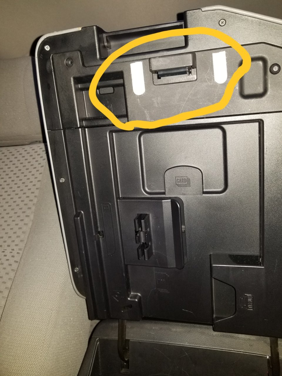

    Anyone notice there glove box rattling when they drive off road, or rough roads? Mine won't' shut the hell up. Glove box has made rattling noise since the beginning.
    Anyone have a remedy fix it? I've had enough.

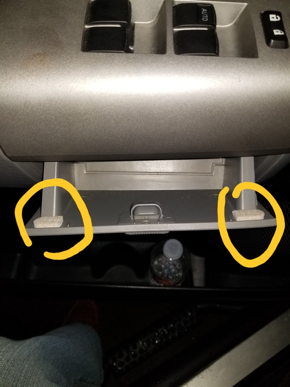

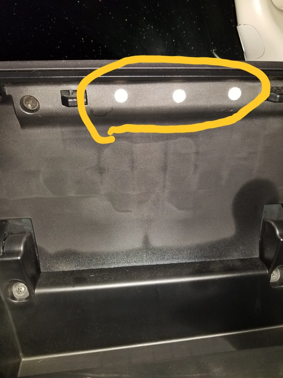

    I used some felt like material with a sticky side, stuff for furniture legs on hard floors. Basically places near the latch to take up some of the loose fit. It made more quiet.

    Sounds like mine coming from the plastic shelf. But the latch does make sense. When you get a chance can you take a photo where you modified it?

    Felt pieces added to make fit more tight, less rattles; upper glove box, center console, and door compartment.20181230_201541.jpg 20181230_201517.jpg 20181230_201452.jpg
