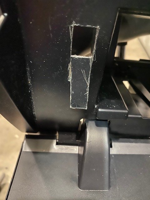

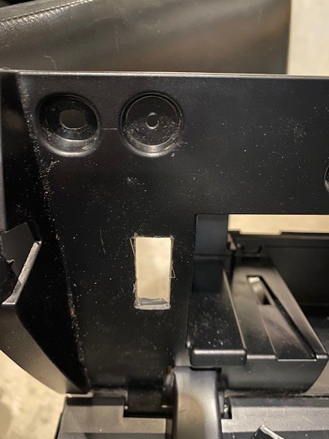

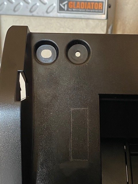

    3. Take the Glove Box Lamp (81260-33030) and take inside seating measurements.
    4. Mine measured to be approx. 1/2”x 1 5/8” and I transferred the measurements to a cardboard template to practice fitment.
    5. I took measurement of the “pin” on the switch. Using foil to the appropriate length, I taped it in various places to the left of the open glove box compartment. This was to figure out the best area to place the pin switch for complete depression when opening and closing the glove box.
    6. The measurements I went with for placement of the glove box lamp are the following: 1 1/2” from the grommet bump stop and 1/2'” from the left edge of the glove box inside space.

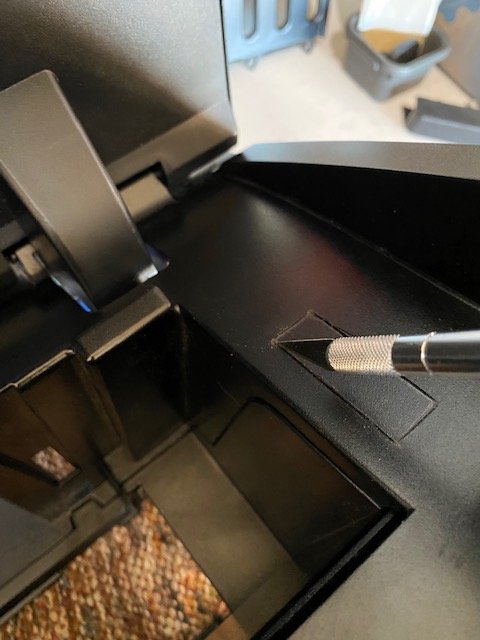

    7. Place the template into position and carefully trace the rectangle for the switch.
    8. Use a straight edge to make your cuts if using a sharp blade.
    9. A small Dremel or like tool can be used. I had run out of cutting wheels for mine…
    10. Make sure to double and triple check the measurement and make cuts within the lines. I did this and still made the rectangular hole two hairs too big! Patience will be your best friend here.
    11. Install your Glove Box Lamp and check for fitment. A sliver of double-sided under the switch’s mounting face plate can help with any slight play.

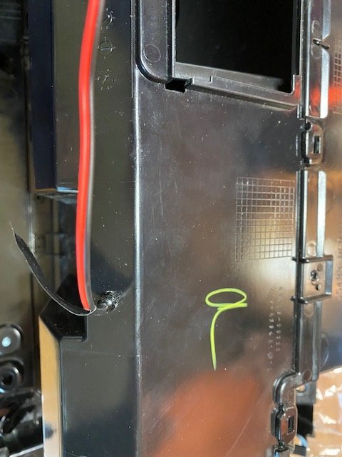

    1. Again, there are so many options for LED lighting. I had originally envisioned using a mini light bar like the one used in the footwells but decided to use what I had on hand.
    2. I chose the “slant back” surface plane of the glove box for two reasons: It provides for an angled shine of the light inside the glove box. It also makes removal and install clearance “easier” by having the wiring follow along the steel bar supports for mounting the dash and its components. I guess a third could be one less “thingy” in the trajectory of an airbag.
    3. I used a straight point dental pick as a counter punch.
    4. A small piece of tape was placed on the inside to help bore a clean hole on the inside of the glove box.
    5. I started a 1/8” drill bit as a pilot hole then I progressed to a 15/64 drill bit.
    6. Unscrew one of the two nuts on the LED bolt to allow for feeding the wires (starting from inside the glove box) into the freshly drilled holes.
    7. I simply used the sole nut to tighten the LED into place and found it to be plenty secure.
    8. The wires and LED bolt tails were then neatly taped and tucked within 1/8” wire loom approx. 20” in length.
    9. Three separate self-adhesive wire loom fasteners where used to secure the wiring loom

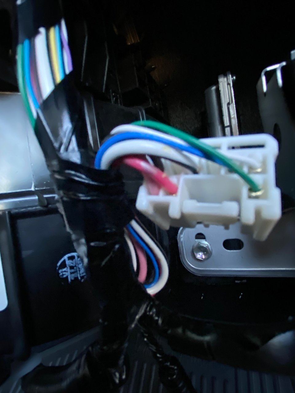

    3. With a test light, I easily happened upon a pink hot wire. This is the wire and route I selected to go with. I wanted to know the harness number to source an empty connector to pin the glove box leads to… and to maybe acquire additional options my truck does not have from that harness…

    1. The lower half of the Blue Posi-Tap was placed first on the pink hot wire, mentioned above, before reinstalling the Glove Box to ensure adequate room for large hands to obtain a clean connection.
    2. Slowly reinstall the Glove Box, carefully checking fitment/clearances while doing so.
    3. Once in the Glove Box is in place, insert the positive connector into the Blue Posi-Tap top twist on the pink hot wire for my power. There is sufficient room to do this part.
