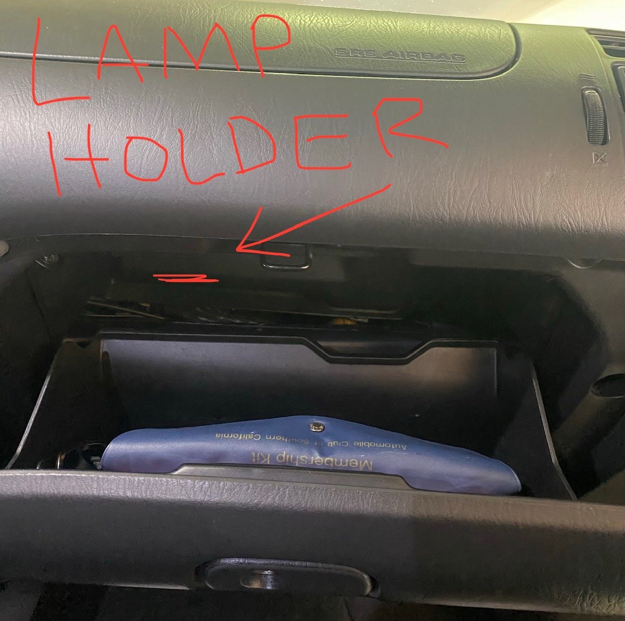

    Hey, Guys.
    So I just discovered my glove box light and the filament of the lamp was burnt out. So I bought and installed a LED lamp. Nothing came on, So I grabbed a new halogen lamp to see if that would come on, nothing. I tested for power, nothing. I tested all the fuses in my truck and all came out good.
    Is there a switch that I'm not seeing? I've searched the forum, google, even my owners manual doesn't say anything.

    TUINDRA 2006...can you post some pics of glove box light?? also what led are you using?

  8. Nov 11, 2020 at 9:31 AM
    trueblue1981
    trueblue1981 New Member
    Sep 30, 2020
    #52962
    41
    2006 white tundra sr5 dc
    looks like a t5 led goes into there.

    I used my Fluke multimeter and I wasn't getting power to the socket. I did check the polarity to the bulb and flipped it, still nada. I appreciate the questions and I would be asking too.
    Yeah, my glove box light doesn't look like that. If you look at the picture I posted earlier, it's just a lamp holder, almost the size of a quarter.
