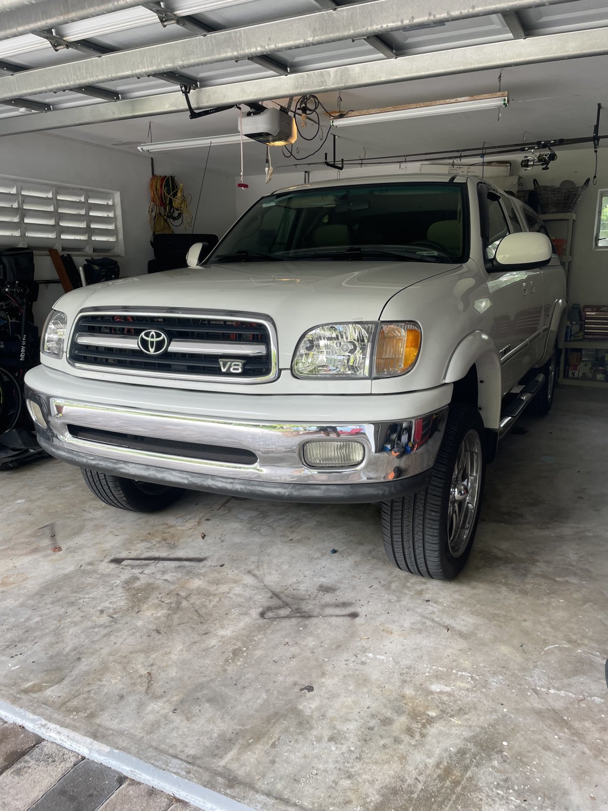

    I need some help deciding what I’ll need to purchase next to achieve a level on my 2000 Toyota Tundra. I just threw some Bulstein 6112’s from FirstGenOffroad a couple of days ago which gave me a 2 inch lift in the front. No rear shocks just the front struts. currently have a 1 inch squat when it should be level, and I’m guessing the culprit is the 24 year old leaf pack in the back
    Measuring from the top of the tire to the chassis I get 8” on the front, 7” on the back.

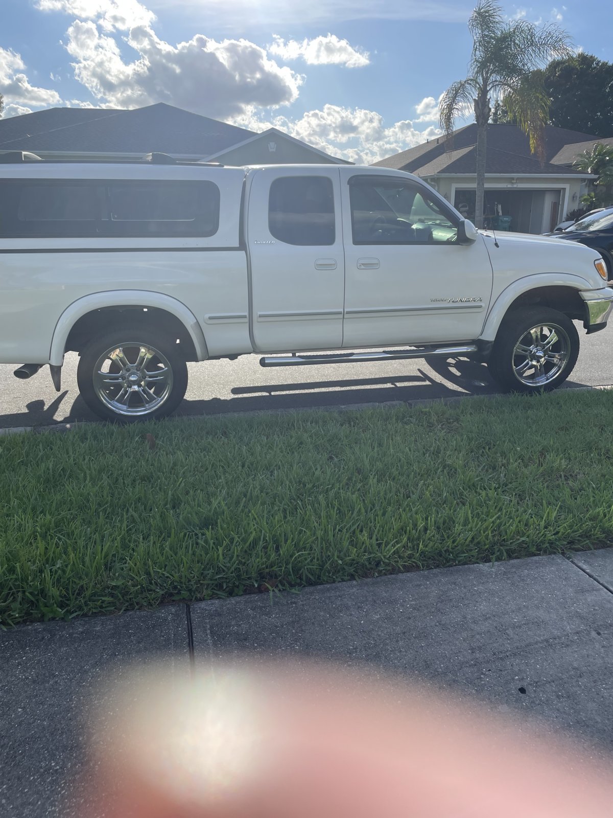

  9. Aug 10, 2024 at 11:51 AM
    michael.crg
    michael.crg [OP] Pothole Hitter
    May 13, 2024
    #116814
    199
    Michael
    2000 Toyota Tundra AC Limited 4x4
    Bilstein 6112's leveled (6/4), SCS F5 17x8.5 4.3' Backspacing on 285/70
  10. Aug 10, 2024 at 12:06 PM
    shifty`
    Jun 20, 2020
    #48239
    31,563
    ATL
    '06 AC Limited V8/4WD

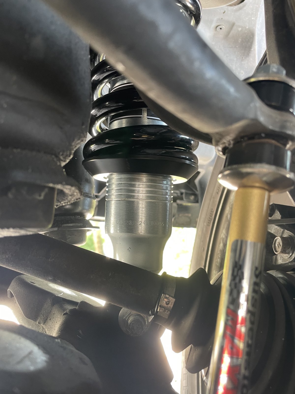

    No side shot?

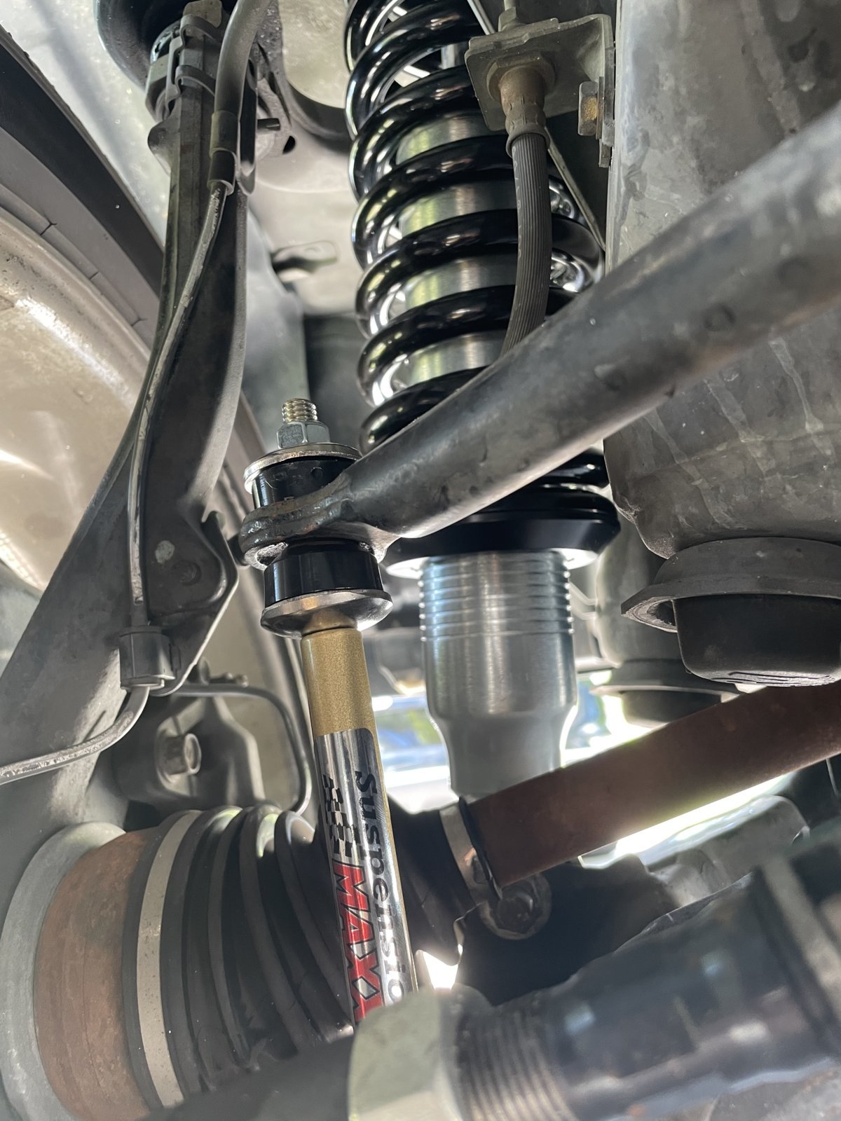

    What settings on each side did they use on the 6112?
    Don't bother with the ICON kit, it's garbage. Get the Wheeler's Offroad kit.
    OldGuy03 and ToyotaDude like this.
  11. Aug 10, 2024 at 12:13 PM
    michael.crg
    May 13, 2024
    #116814
    199
    Michael
    Updated the above post, side shot makes it look level since it’s on a sloped angle, I’ll try to get a better one when I get home along with some measurements.
    I’ll ask the salesman from firstgenoffroad too, they never specified

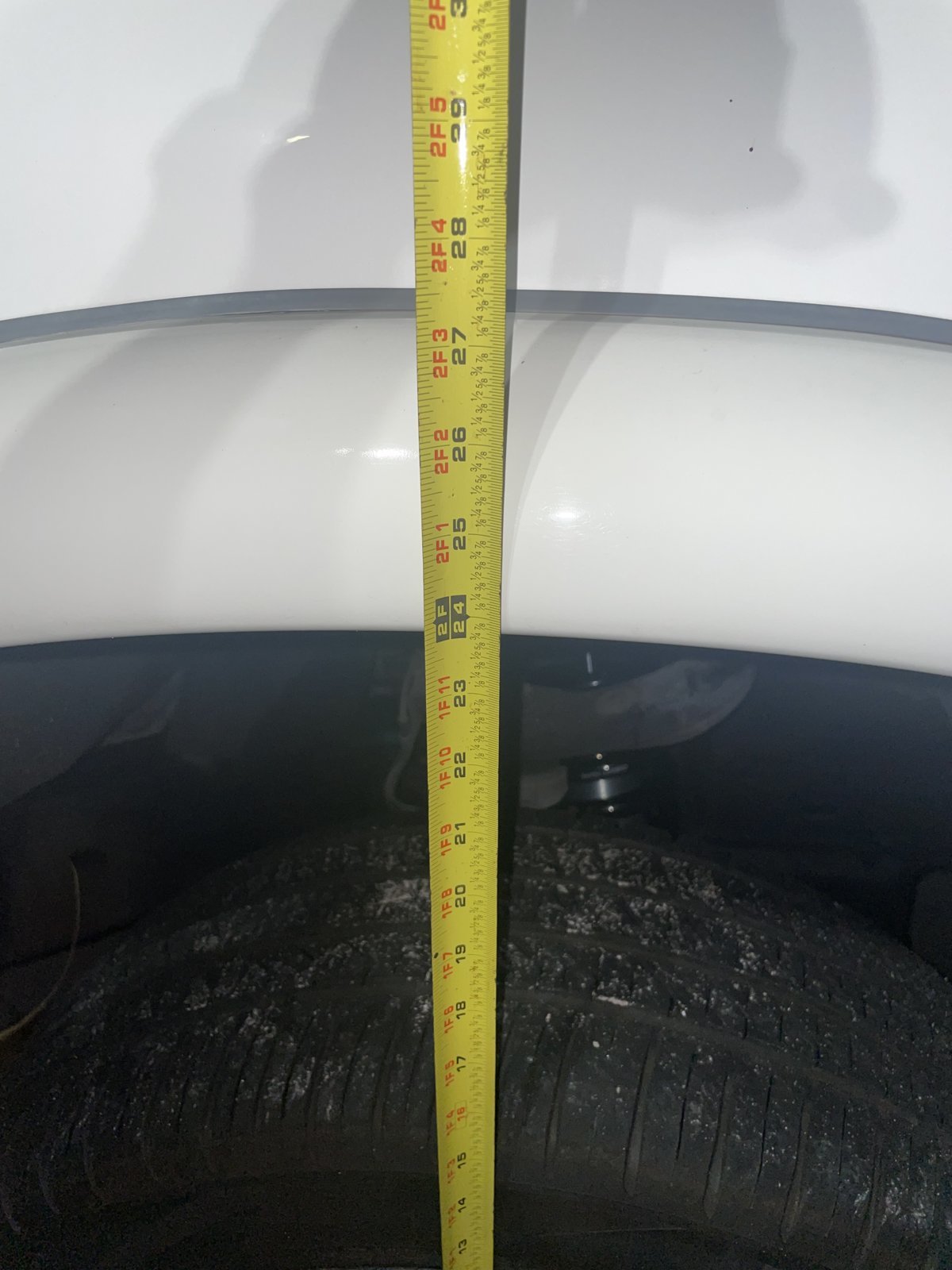

    You shouldn't be measuring top of tire to chassis to determine level or not. I'd measure on flat ground, from the ground to the edge of the fender flare.

    But back to the other question: Do you know what settings FGO used when assembling the 6112s? It'll usually be different per side. I'm only asking b/c I eventually need to set mine up and I do not want to be as lifted as you are. Seems excessive, like he set them up for a double cab to me. But maybe it's just the wheel/tire set that's on it now.

    I should hear back from FGO soon and I’ll update you on which clip it’s on when I do. know they’re properly set for driver side sag but that’s about it.

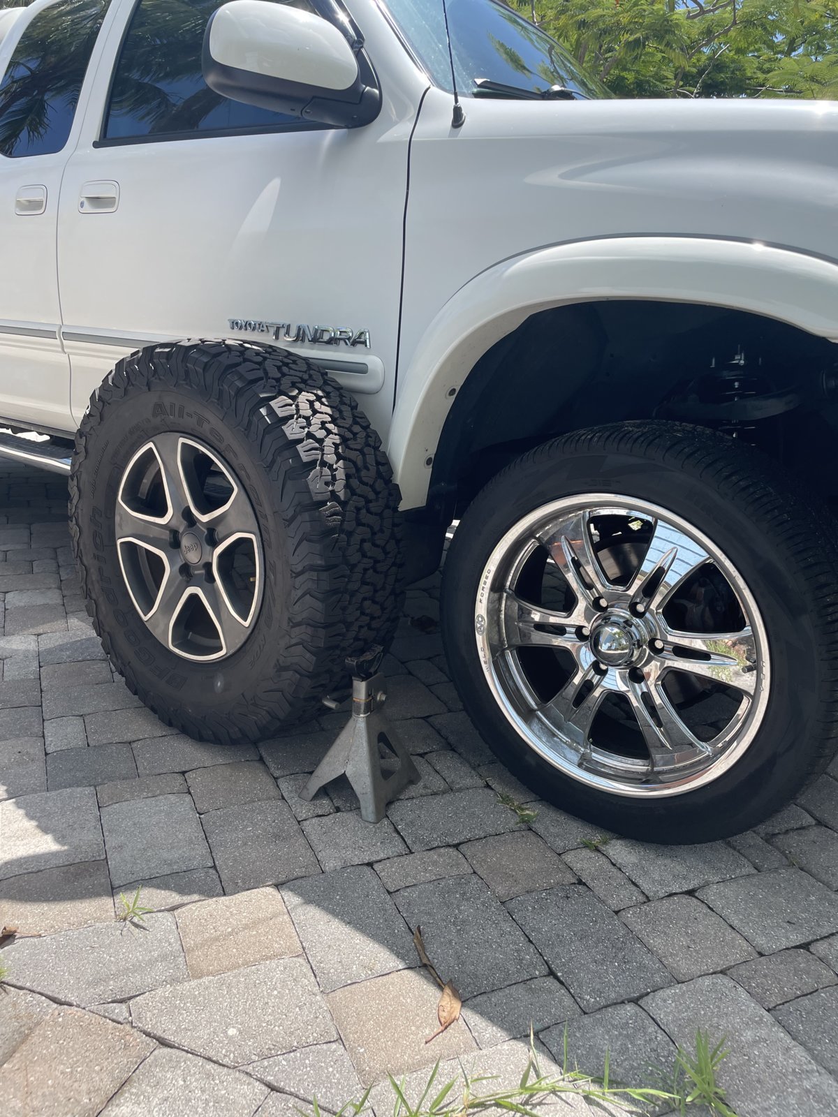

    I think it just might be the wheel, because I did the top of the wheel to chassis measurement (improper I know) and it did achieve 2 inches of lift. Again I’ll remeasure when I can. What’s the stock setting on height on a level surface? That’ll help me determine if I got more lift than I asked for while I wait for the FGO response in the meantime.
    We’ll see how it looks on Thursday when I throw the 285’s on.

    Typical measurement is center of wheel to edge of fender on all four corners.
    But if you want to know if the truck is “level” or not, measure from the ground to the edge of the fender flare. In theory, it should be same or similar to the above. Is it really accurate? Probably not, because I’m not convinced the fender openings are technically the same front and rear. I feel like one is shallower than the other, but whatever.

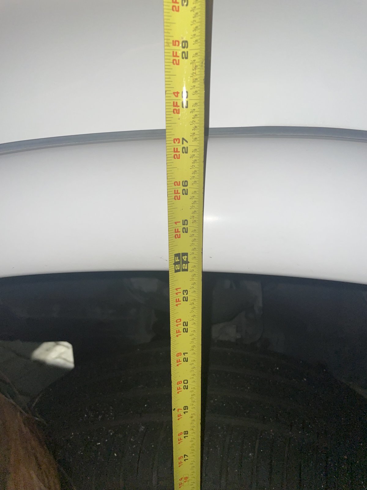

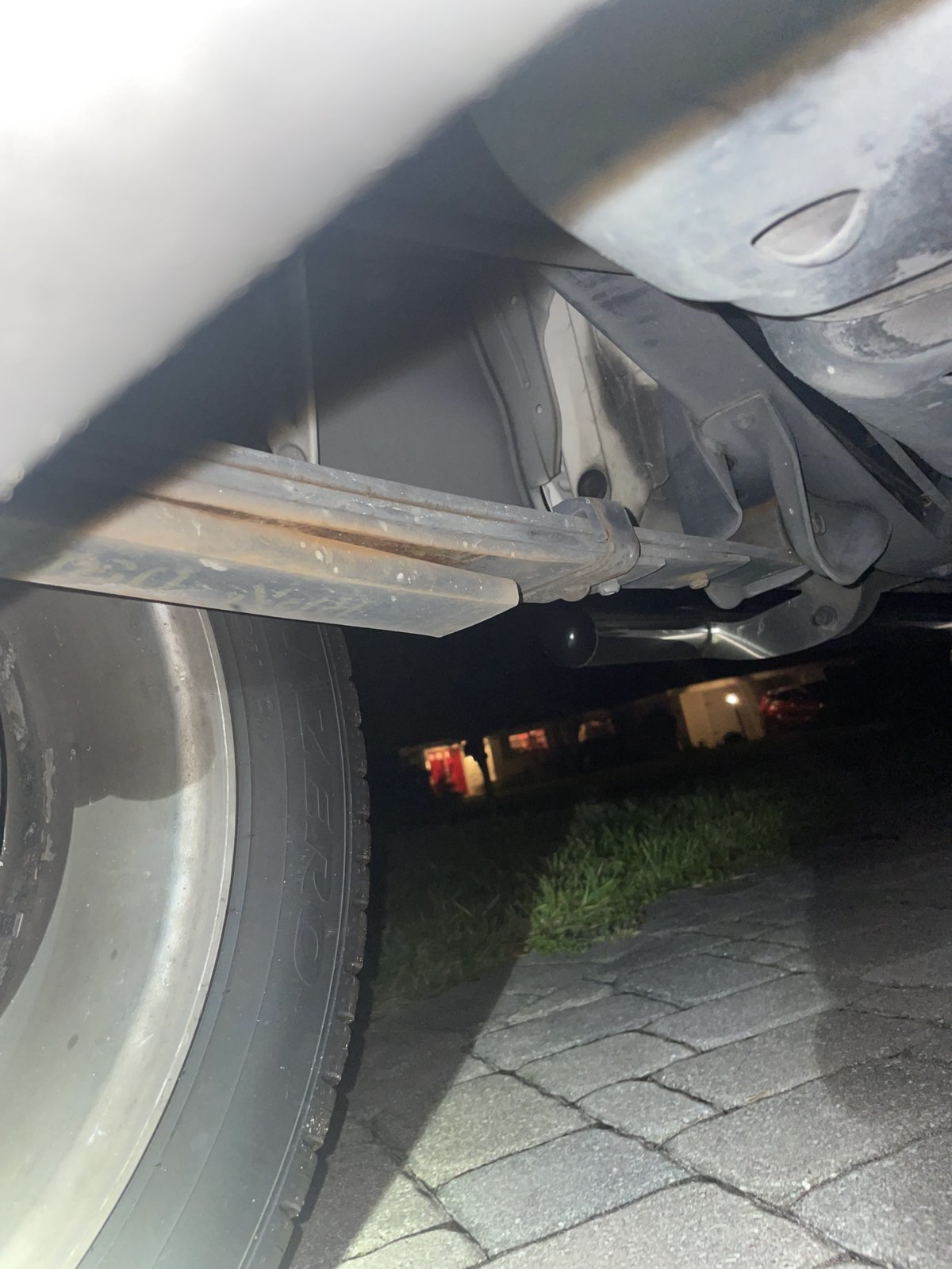

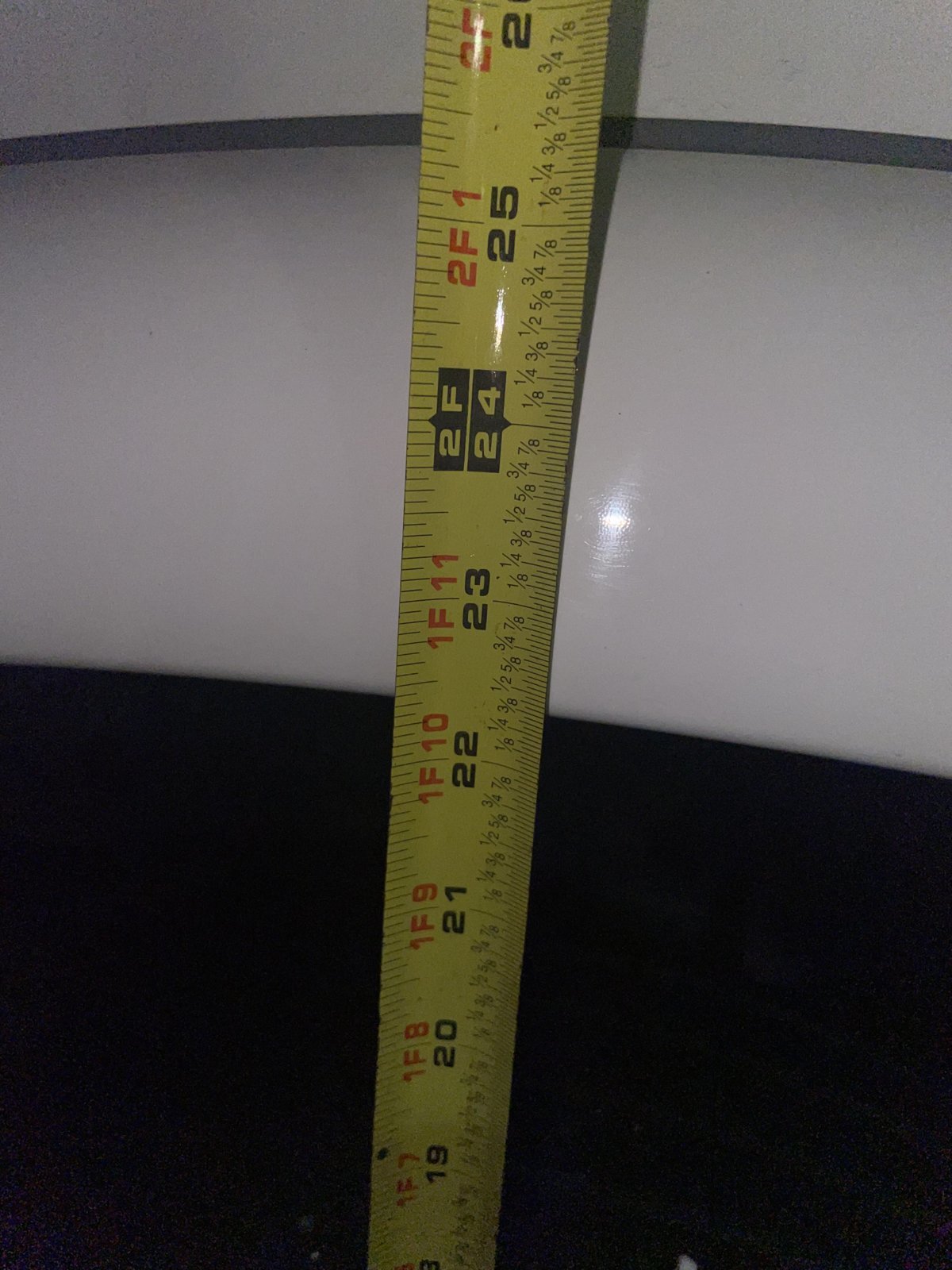

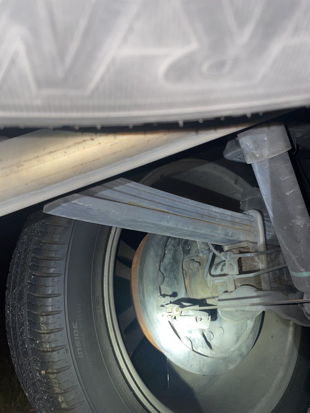

  16. Aug 10, 2024 at 7:05 PM
    michael.crg
    May 13, 2024
    #116814
    199
    Michael

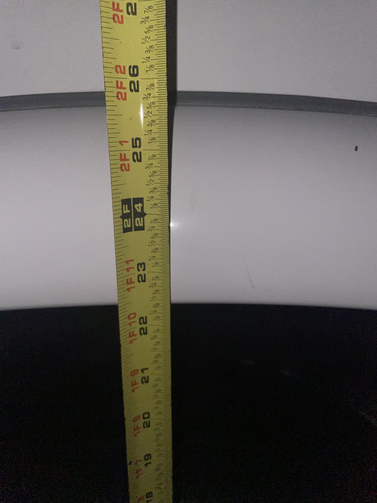

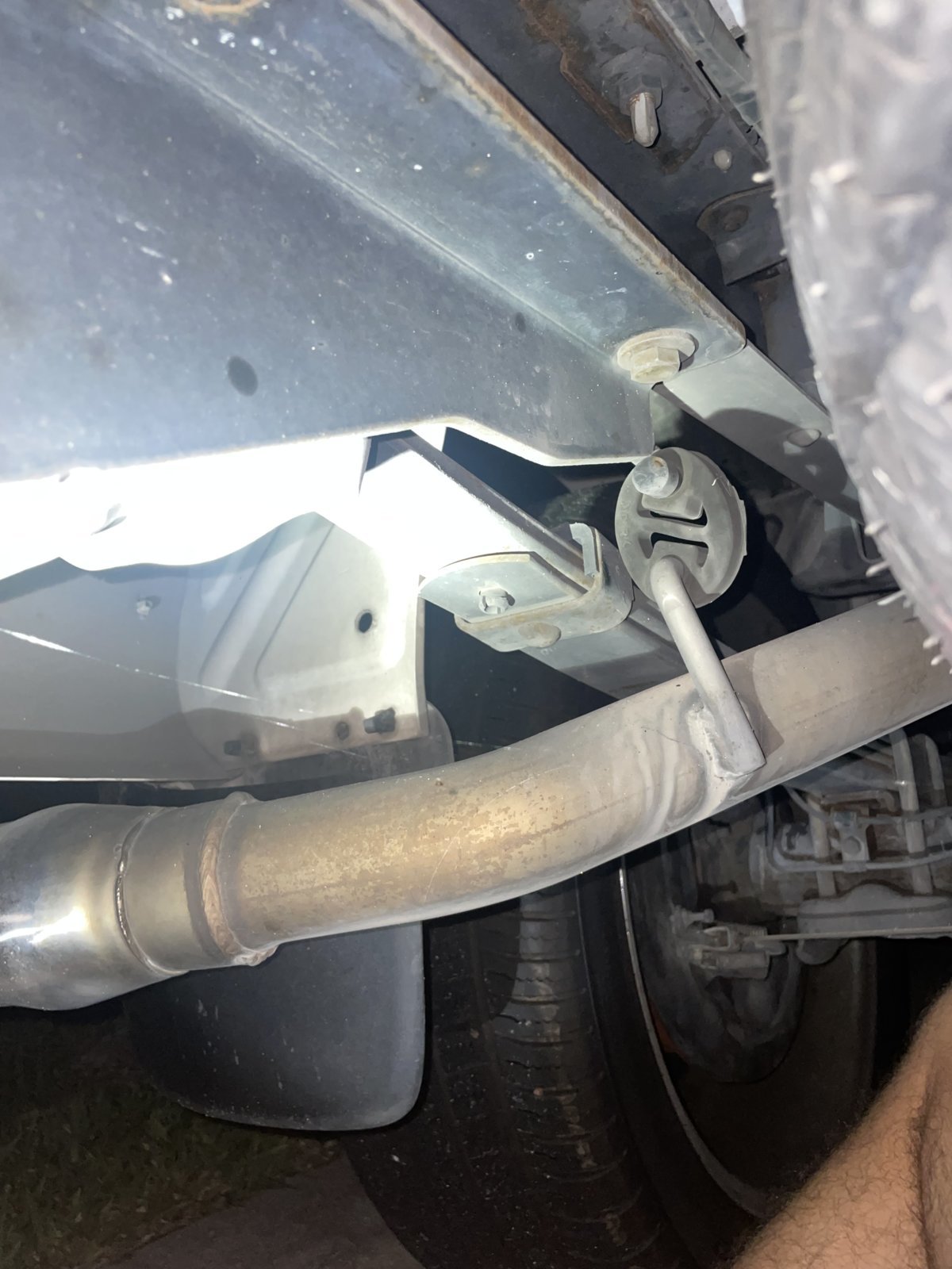

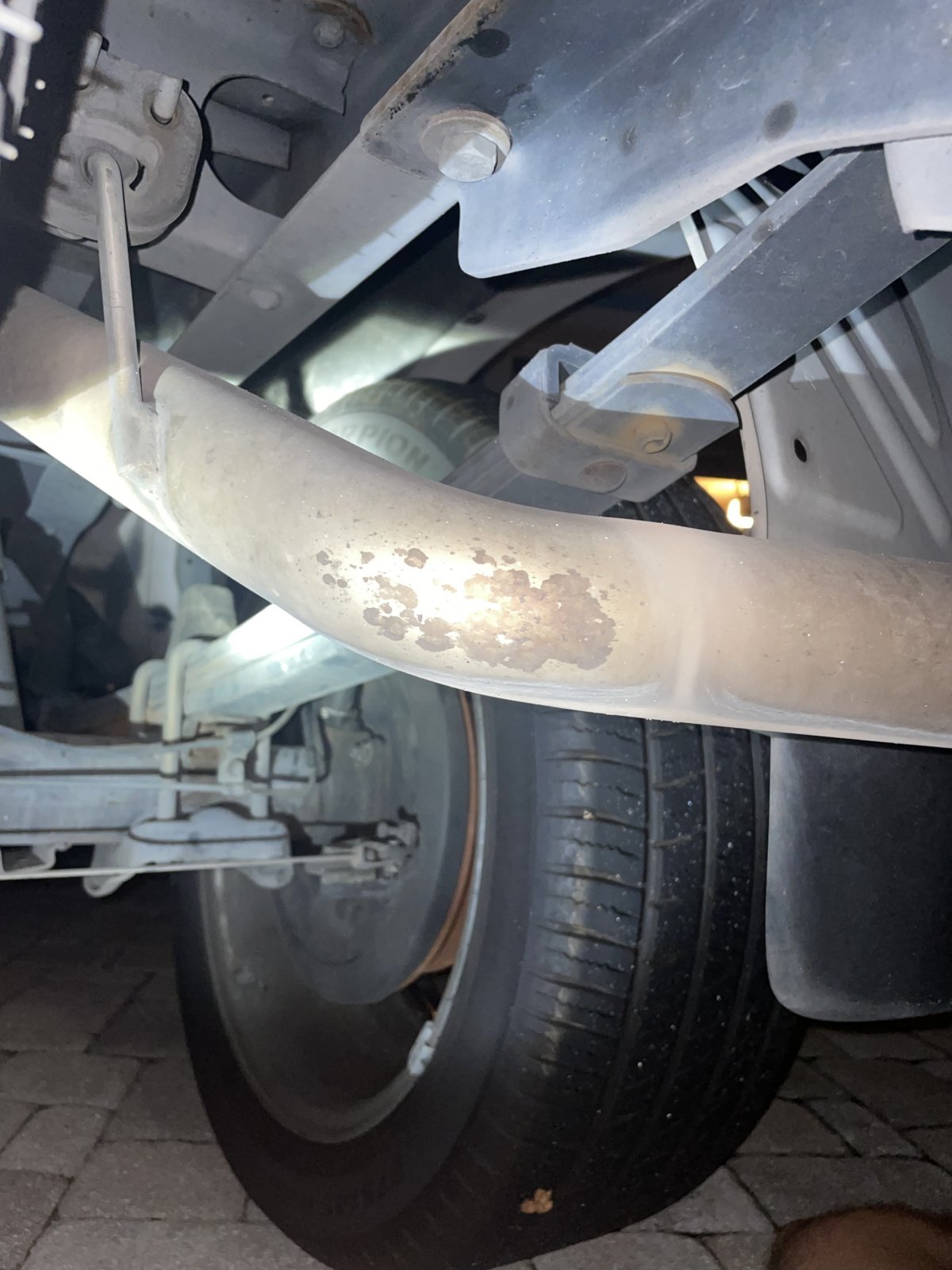

    Rear (Right, Left)
    Front (Right, Left)
    Leaf Springs:
    Right:
    Left:
    Measure from center of wheel. Let me know what y’all think since I don’t know what I’m looking at with the leaf packs lol
    I’ll give them a thorough look over tomorrow when I got daylight!

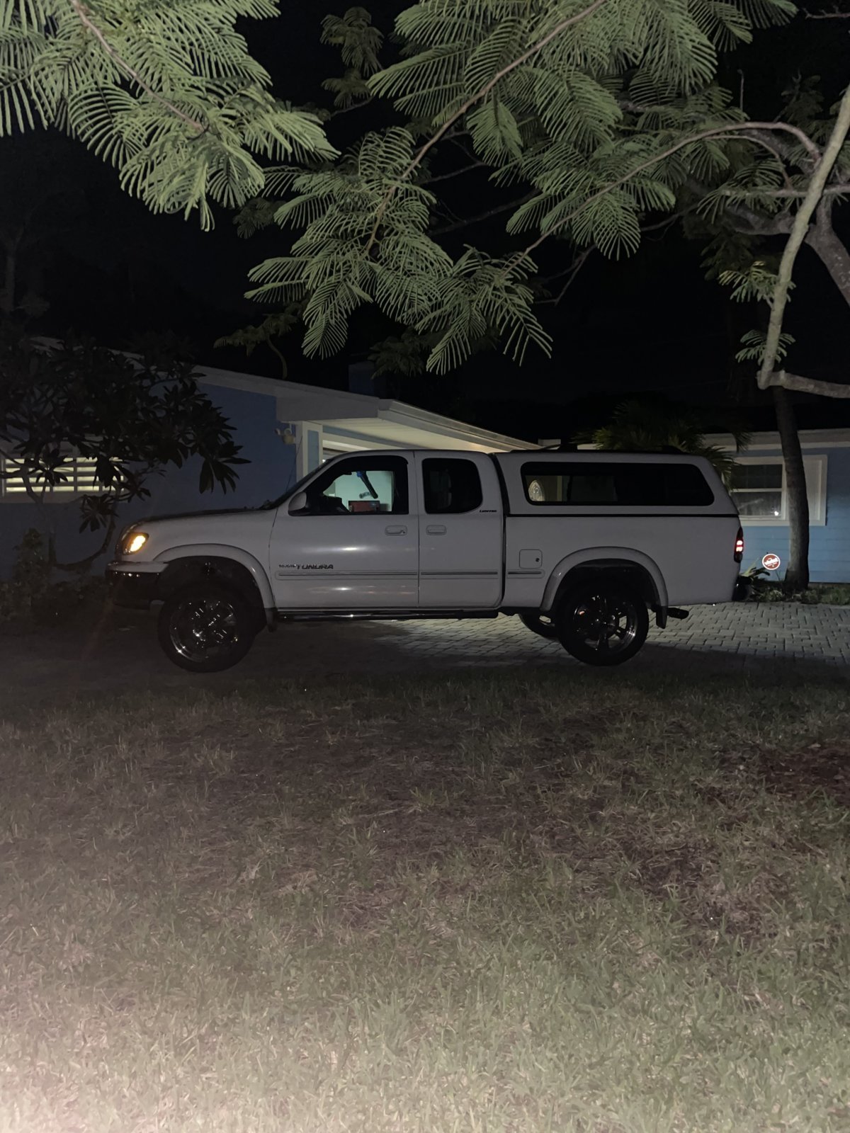

  17. Aug 10, 2024 at 7:16 PM
    michael.crg
    May 13, 2024
    #116814
    199
    Michael

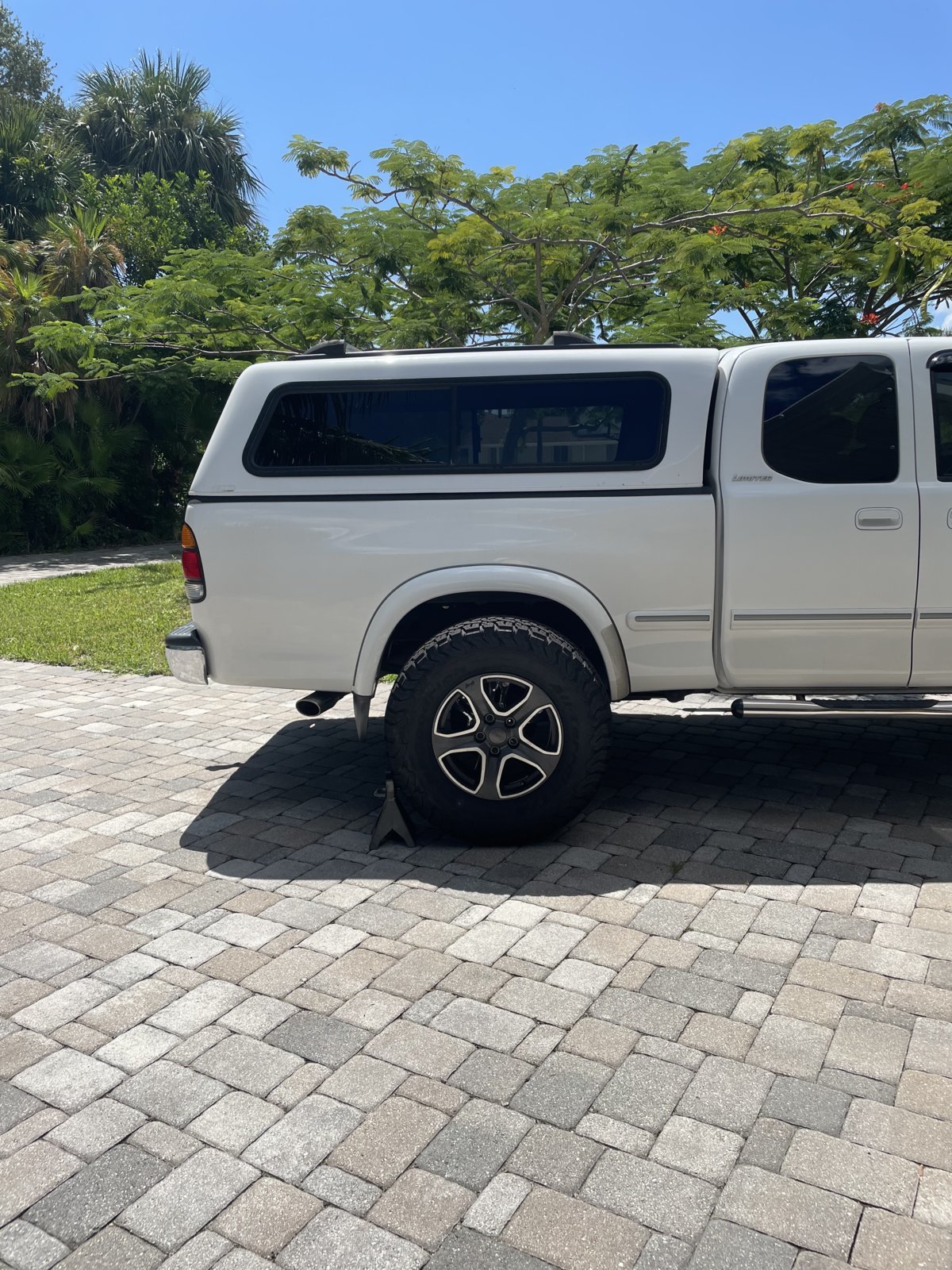

    Also here’s a dark side view. I don’t know if y’all see it but I have a very slight squat going on. Or maybe I’m just crazy
  18. Aug 10, 2024 at 7:53 PM
    shifty`
    Jun 20, 2020
    #48239
    31,563
    ATL
    Yeah it’s high up front by 1.25”, probably after it settles. I’d get ATS HD or Husky springs. Or lower the front.

    with the current height I have, is this going to affect the fitment of the 285/70/17r wheels I’m going to put on it?
    That’ll depend on how urgent I gotta get the packs. If it isn’t that urgent, I’ll give it some time.

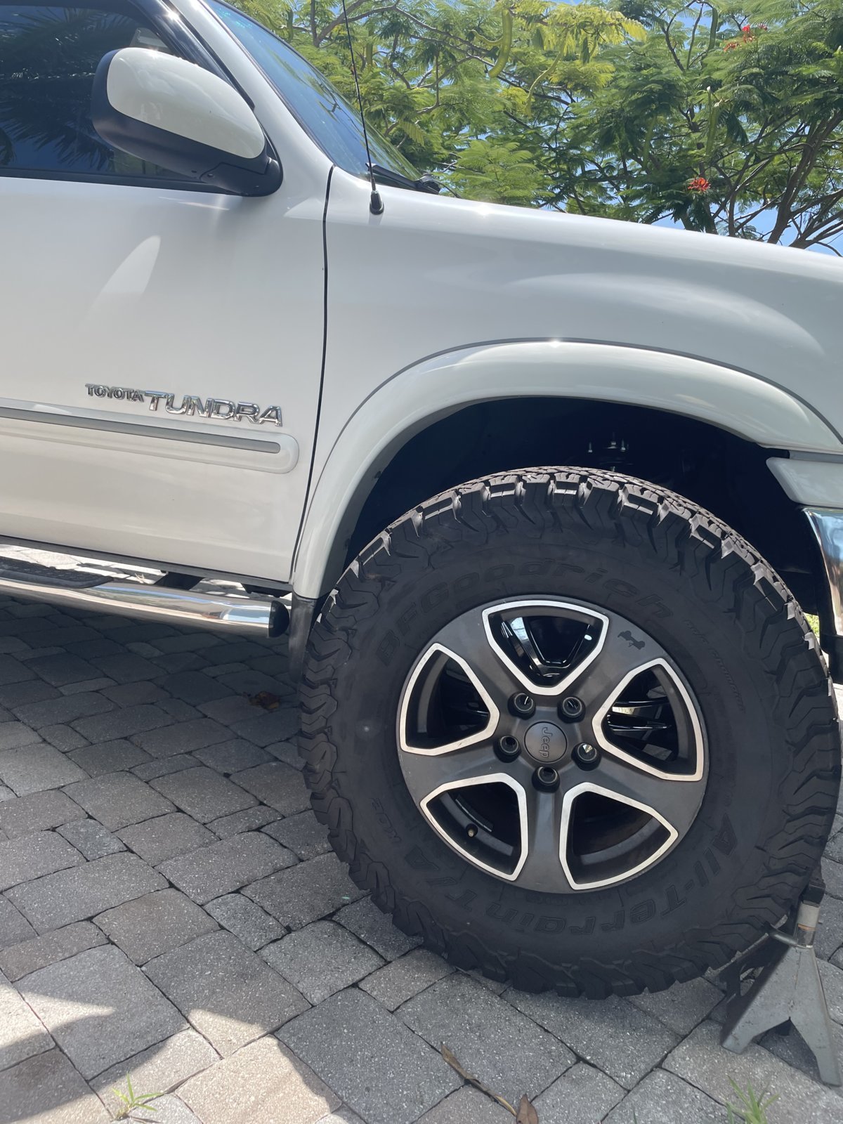

    But @michael.crg, no, I doubt anything you do in front, including lowering an inch, would impact your fitment with 285s with your current setup. A lot of fitment revolves around your wheel choice and alignment.
    As long as we're not talking about MT/mud terrain tires or similarly aggressive ones (like my E-load Mickeys) which will have more tread and thus overside, I legitimately think someone could probably clear 285/70r17 with 1.75" lift and have minimal rub. At the end of the day what'll help you clear rub more than lift is how far it's centered off the hub (wheel offset/backspace) and how it's centered in the wheel well front-to-back (caster). Your major challenges now are to pick an appropriate wheel, and add caster, either by way of afermarket uppers, getting someone knowledgable with alignments, or both. I think it's a pain in the ass to find someone who can properly align. At least it has been a challenge for me.

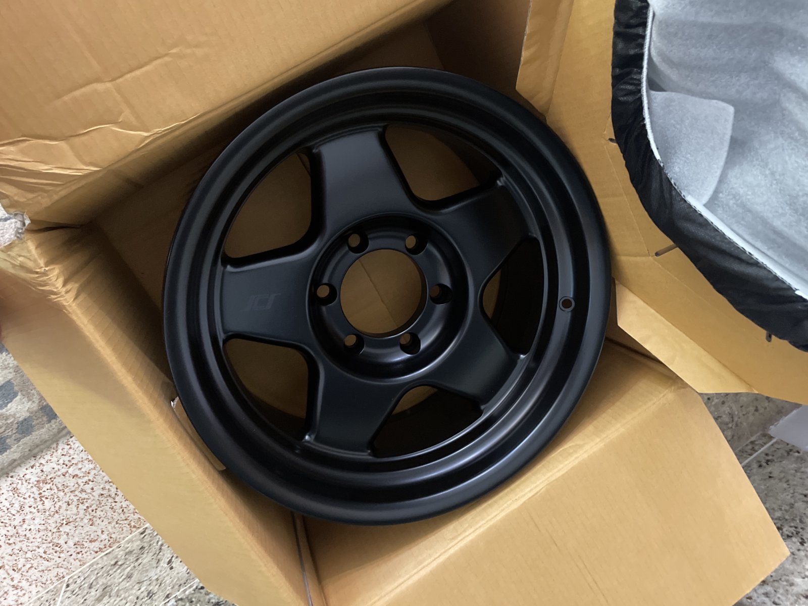

    And to answer @shifty` thing about my wheels I snagged some Stealth Series Custom F5’s in Matte Black which are 17x8.5, -10mm offset so about a 4.3 inch backspacing. So hopefully no fitment or alignment issues on Thursday! Going to a super reputable shop in my home town and we got lifted trucks EVERYWHERE since it’s Florida lol

    So I went out and took some more pictures with daylight. This is the tire that’s going to go on it, minus the wheels since those are getting replaced. The wheels on the truck right now are 275/45/20r so they look tiny compared to the 285’s, but I see what you mean @shifty` about a higher lift in the front, so I did more digging
    Passenger side strut
    Drivers Side:
    Assuming the visible clip count is the current setting, then according to the chart I’m set 7/5, or if it’s on the clip I’m at 6/8, and I’m guessing I get over 2 inches of lift and that’s why I’m not level. Will get that confirmation from Josh probably Monday.
    I mean if it’s a clearance issue with the UCA issue, I’ll just get UCAs. I guess I should’ve done some more research before purchasing the 6112’s, but it looks like I can make it work.
    Either that or a steel bumper in my future to compensate for not being double cab :rofl:
