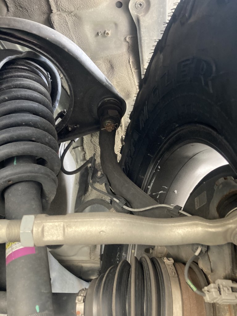

    I have total chaos ucas and they have very good clearance, likely better than stock. Most ucas have worse than stock clearance due to how they are built.
    RCKWRRR[QUOTED][OP] likes this.

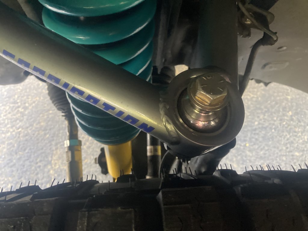

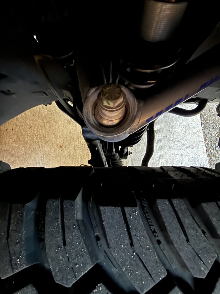

    For reference Total Chaos, 315/70r17, rock warriors.
    RCKWRRR[OP] likes this.

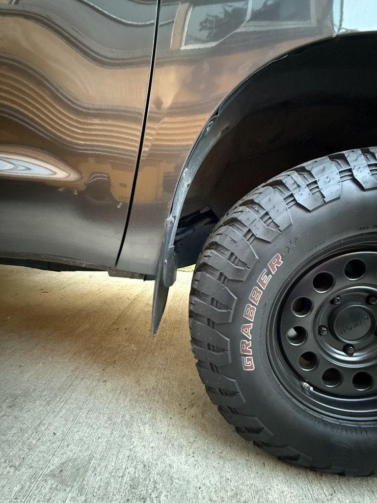

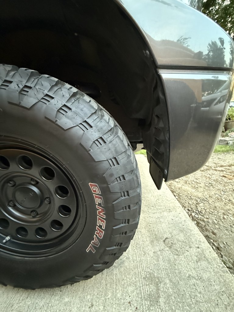

    Here’s some reference of what I’m at now with 295/70/17
    mqqn likes this.
