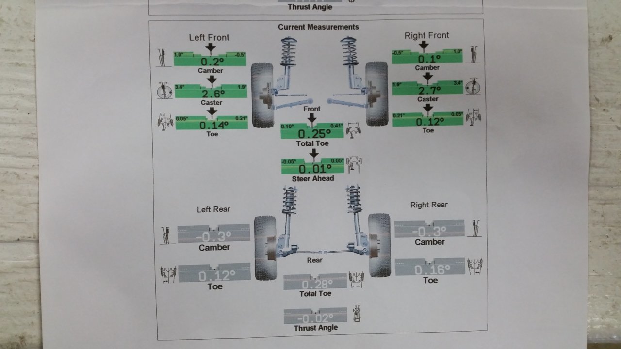

Getting alignment tomorrow, what should I expect as far as numbers ?

    front has TC UCAs and oem Kings shocks set to default ( pretty much level truck) so probably 2" lift front.
    what should I expect as far as numbers ? or close to it so I can check what the technician doing.

    Not sure if this will help but here is the print out from my '13 after doing Bilstein 5100's. The front is up 1.7" with stock UCA's. It rides great and the numbers might at least get you close.20170503_191942.jpg

    You should have no problem getting back in spec with a 2" level.

    just got back from alignement place. All in the green :) similar numbers to above sheet
