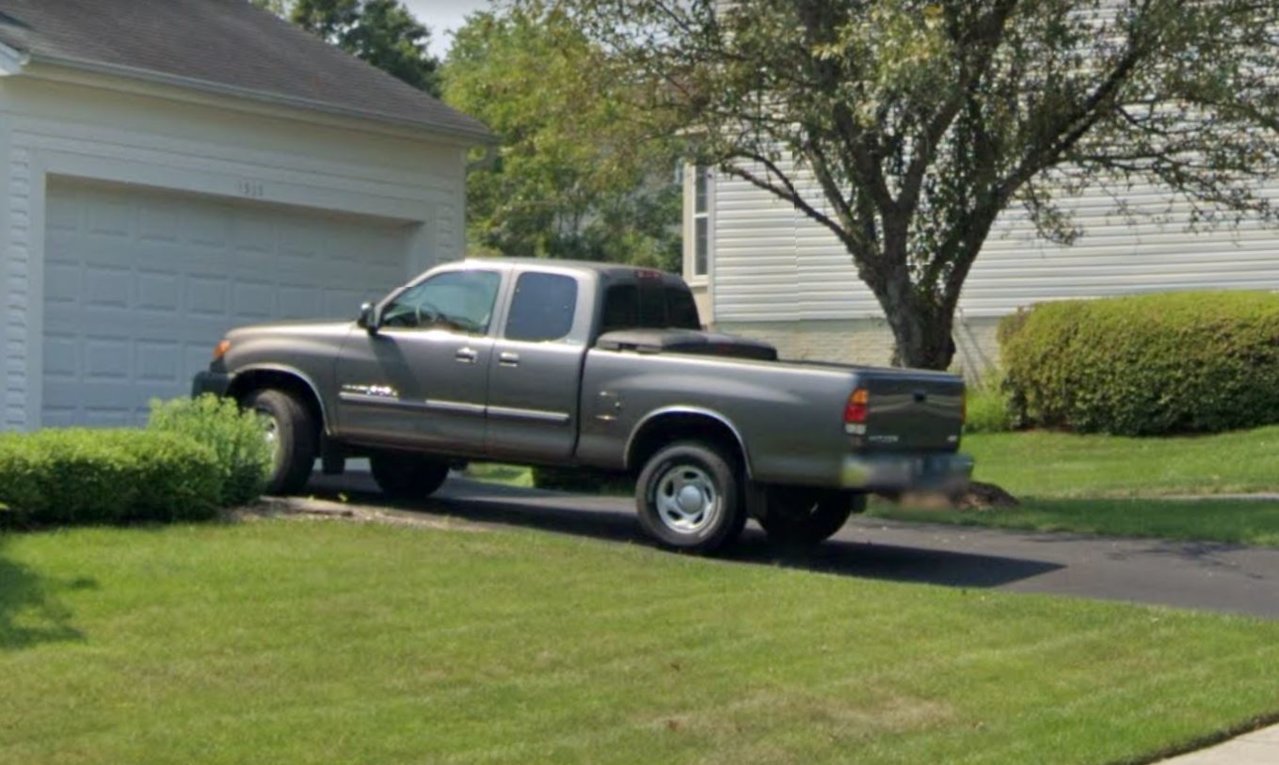

    I don't have any good pics, but here's one from a google maps drive by. driveway pic.jpg

    That’s a good looking truck. Looks to be in great shape.

    Smart way to find a pic
    Judging from the taillights it's an 00-04 which means 3.4 V6 which means timing belt. Almost certain that engine is non interference so if the belt breaks it will leave you stranded but not break anything. Would be best to knock it out if it's never been done before.
    You can find out service history if you make an account on toyota.com/owners and input the vin. Will tell you anything and everything that has been done at a dealer.
    The truck being that low of mileage probably doesn't have any rust and if he took it in and they said it was good it might have been undercoated. Which is probably fine if the truck wasn't rusty. If you plan to do any winter driving I'd definitely keep a close eye on the frame.
