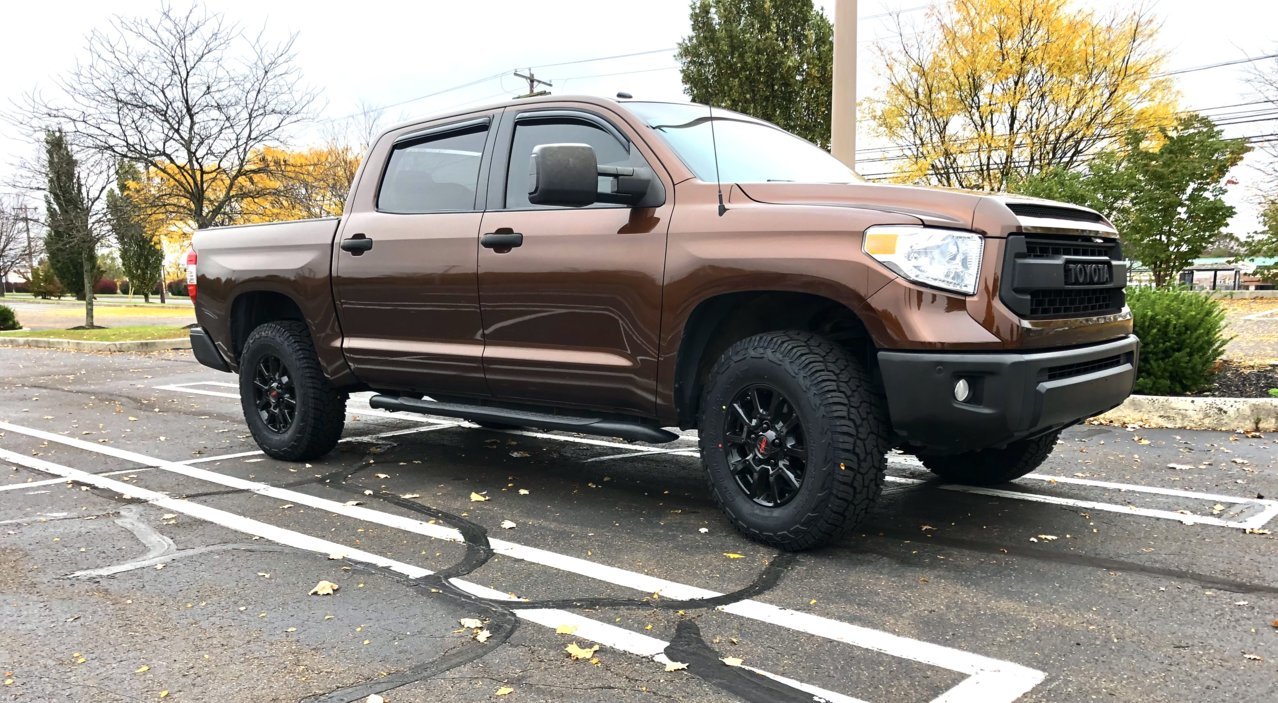

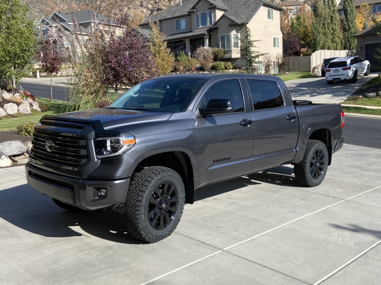

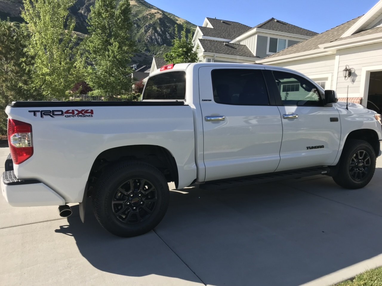

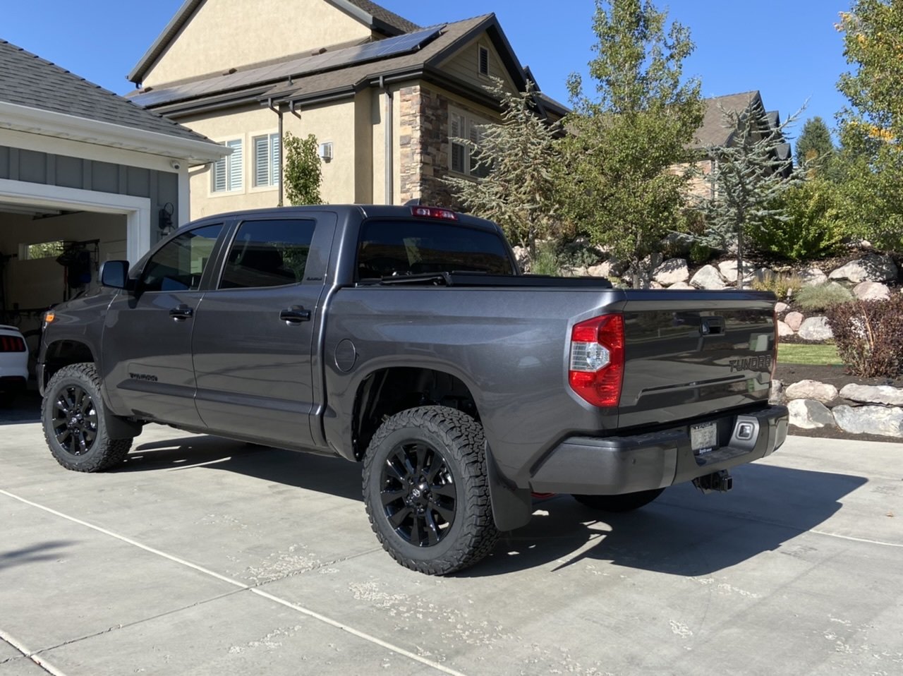

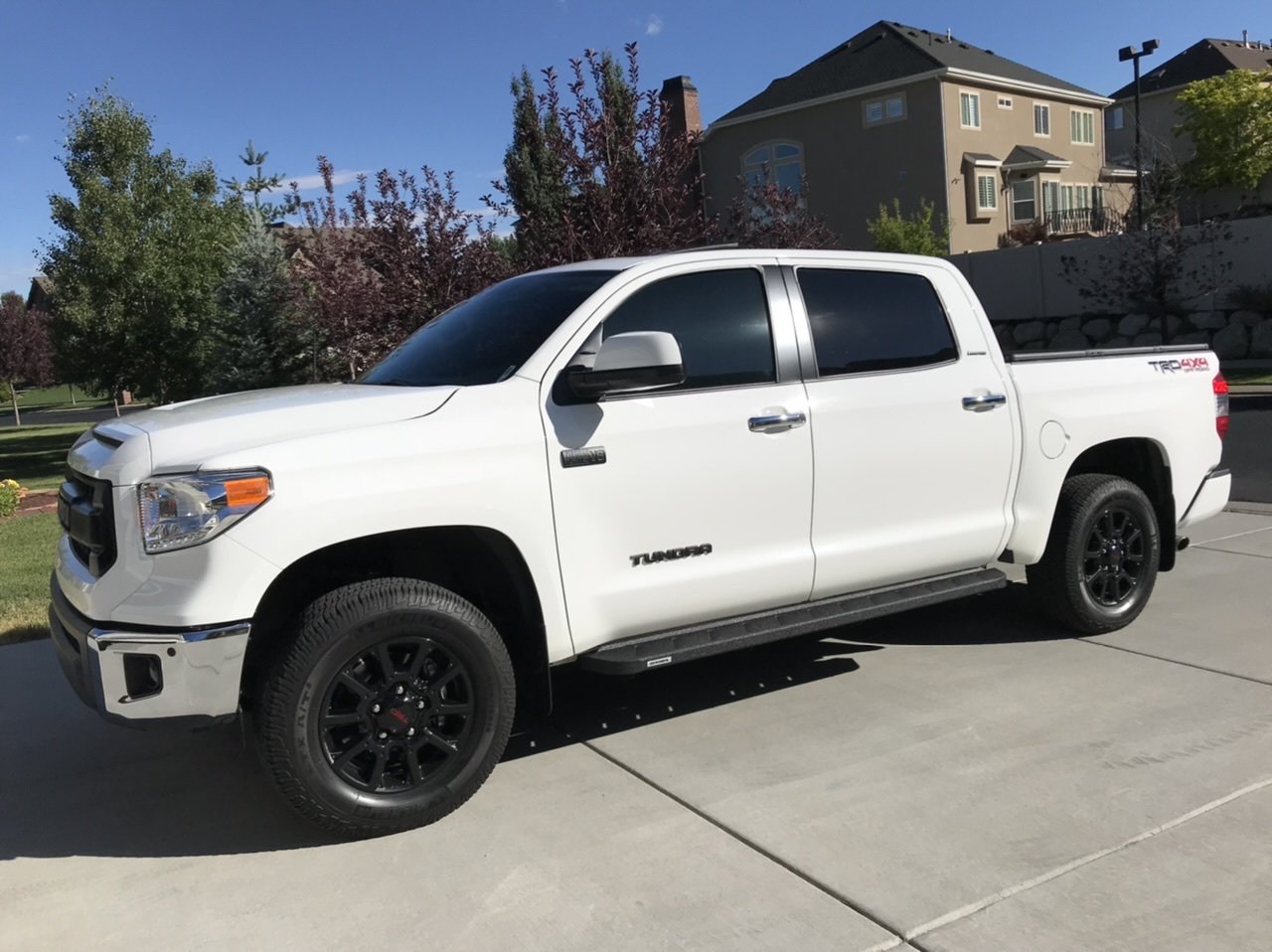

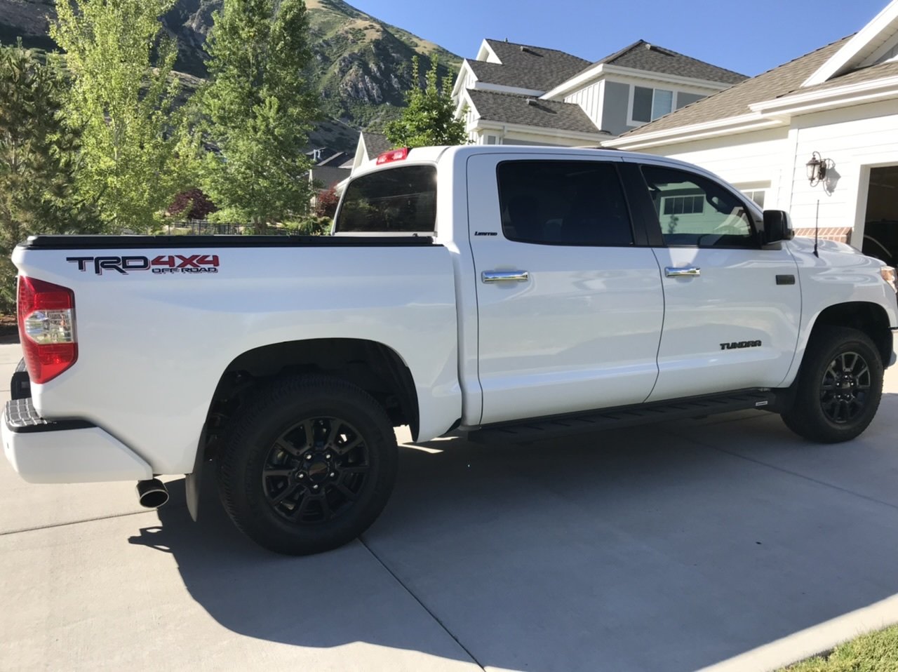

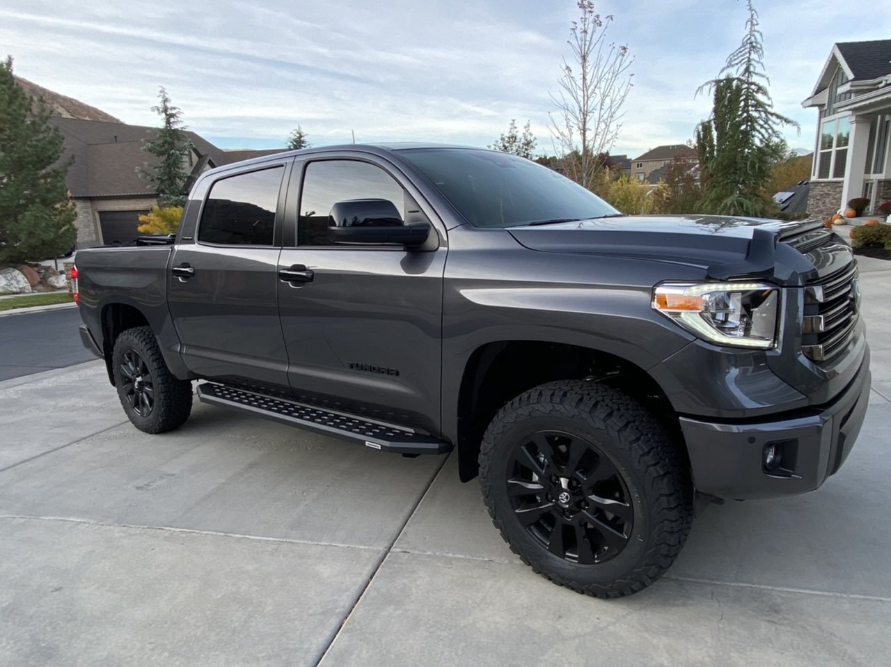

    Hey. I am not speaking as any type of suspension technical expert. Just from my personal experience:
    1. I had a 2016 TRD Off Road that I wanted to go faux Pro without doing the TRD Pro suspension. I did that with Bilstein 5100s all around. My front 5100s were set at the middle (I think that’s around 1.75” lift) setting. No lift on the back. It got me pretty close to the leveled look of the Pro with a slight rake. No other work was done on it except for an alignment. I did not change the tires either. Worked great and for my limited towing (less than 5k pounds) also worked great. Cost was appx. $950 including struts, shocks, install and suspension. It was done by an affiliate of a local Toyota dealer.
    2. I just bought a 2021 Limited Nightshade a month ago. I went back to the 5100 setup. But this time I had the front struts set at the top (I think that’s 2.5” lift) setting and I added spacers front and back so I netted a total lift of 3 in the front and 1.5 in the back. I did this so I could clear 34” BFG tires. It did that. It also only required an alignment with no other changes to the suspension. Total cost for me here was slightly over $1000 including all parts and install and alignment. Same shop did the work.
    The reason I went this route instead of leveling kit is I had read that leveling kits reduce the overall suspension travel of the stock shocks. Again, I’m not technically learned in suspension works so I chose to go with the replacement strut setup that kept full travel and gave me the leveling effect. Plus Bilstein is a pretty well known brand with quality products and this was a great value for the dollar in my mind.
    Hope this helps. And I will upload pics of my two trucks later.

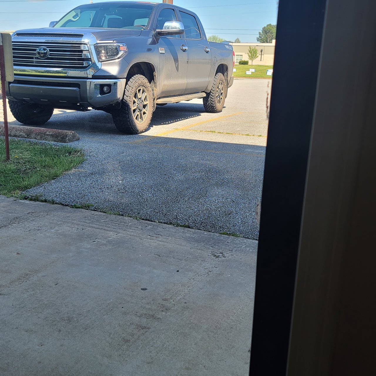

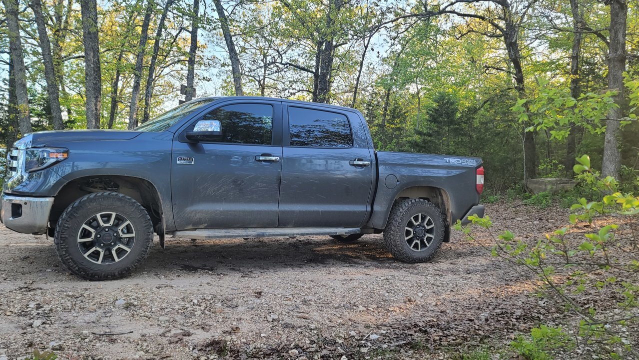

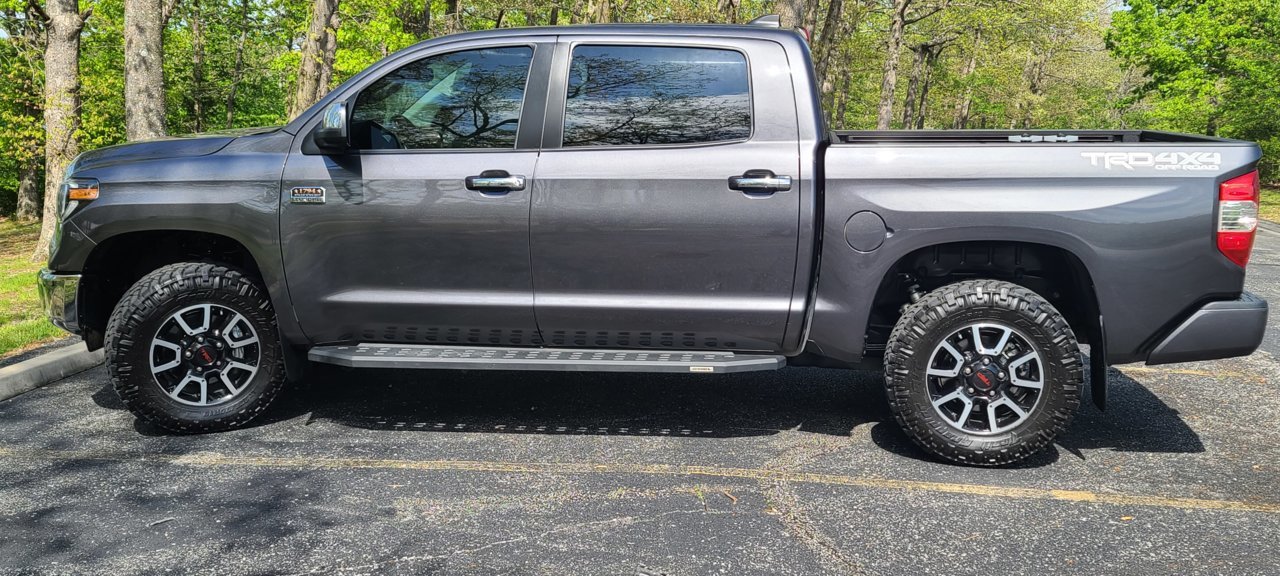

    My truck with Bilstein 6112 coilovers at the 1.9" setting and nothing in the rear.
    Edit: I did add Bilstein 5160 rear shocks but no rear lift.

    I'd say ride is better but that's subjective and let's be honest it's a truck not a Lexus it's a truck.

    The white was my 16 TRDOR and the MGM is my 21 Nightshade. Sorry for the delay. Long day!
