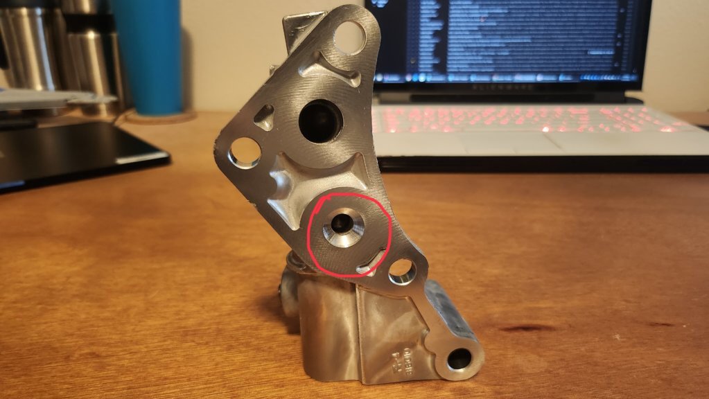

    2018 Limited Tundra

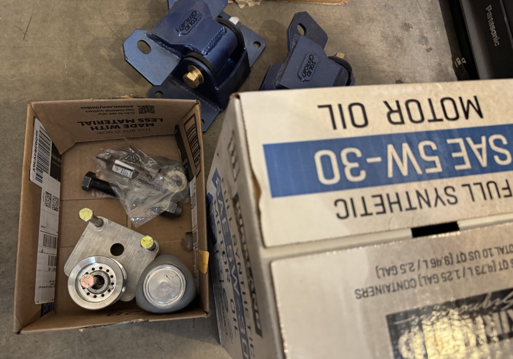

    One positive of my motor fail is Sniv's pulley will finally go on. Do I need a smaller belt to go down 1mm?
    2.299213" is what I currently have on there.
    https://www.ebay.com/itm/115458934864
    vs Sniv's 2.2"

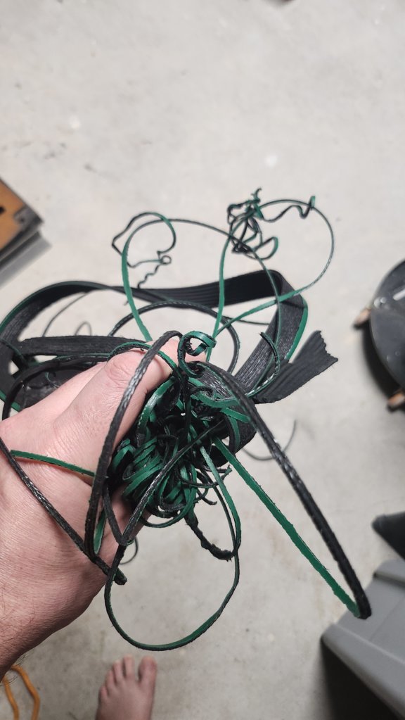

    You shouldn't need a different belt size for 1mm pulley difference. On a related note, my belt was shredded on Monday and now I get to replace a front crank seal...Ho Ho Ho!

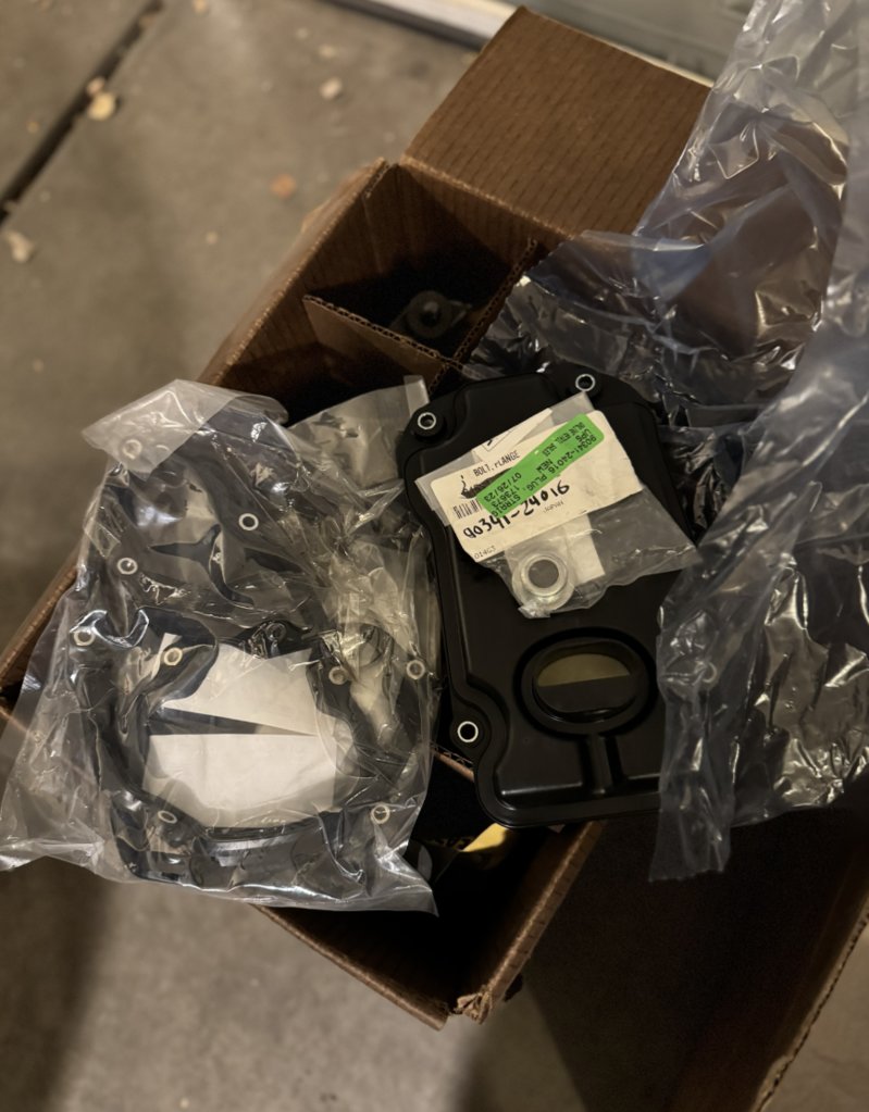

    Thanks to the BMW, I have about 7 belts in my garage, what is the right belt #? (I also have a stock belt & at least 2 of the ones that are on the Tree).
    I remembered I have the Jowett filter housing I need them to move over/they need the tool (gotta remember to get it back) and I have had a trans filter, gasket & Amsoil ATF sitting here for 2+ years, gonna get that done while it's there.
    Mdl and armyoffoo like this.

    I was fully expecting to see it had knocked out my oil pressure sensor, or some kind of major damage, but I thought I got lucky. It wasn't until I was warming up the truck and making sure the new belt was tracking straight that I noticed the drip from behind the crank pulley. There was a rats nest of shredded belt crammed behind there I had removed, but that must have damaged it.

    What caused the shred? Not something ive seen mentioned here much

    Mine was a seized idler pulley and the edge of the belt caught the compressor clutch. I had another green belt just parted and snapped across the ribs.

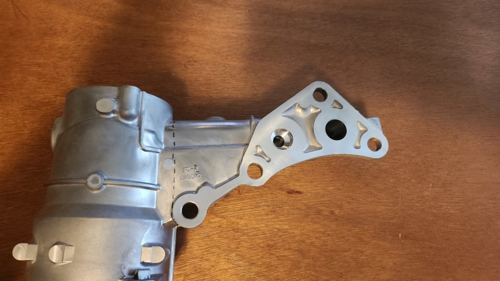

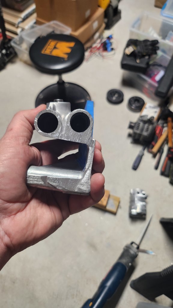

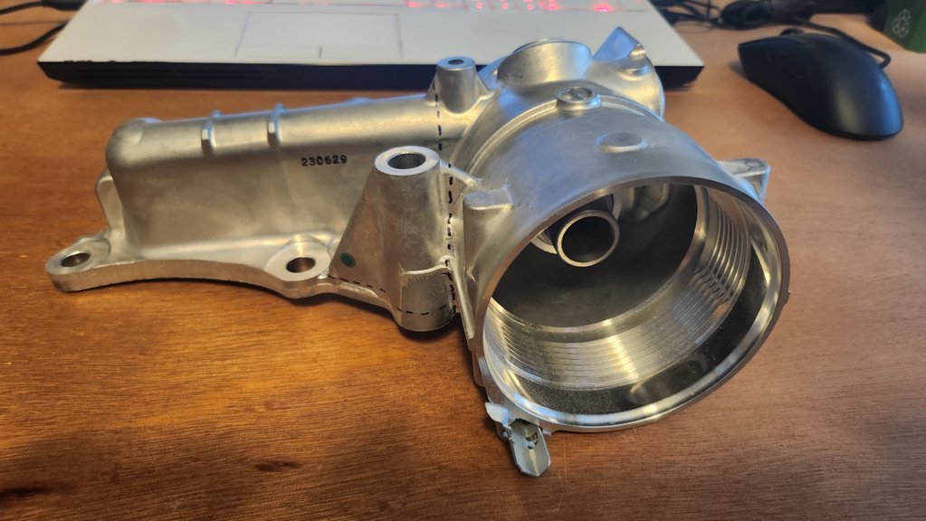

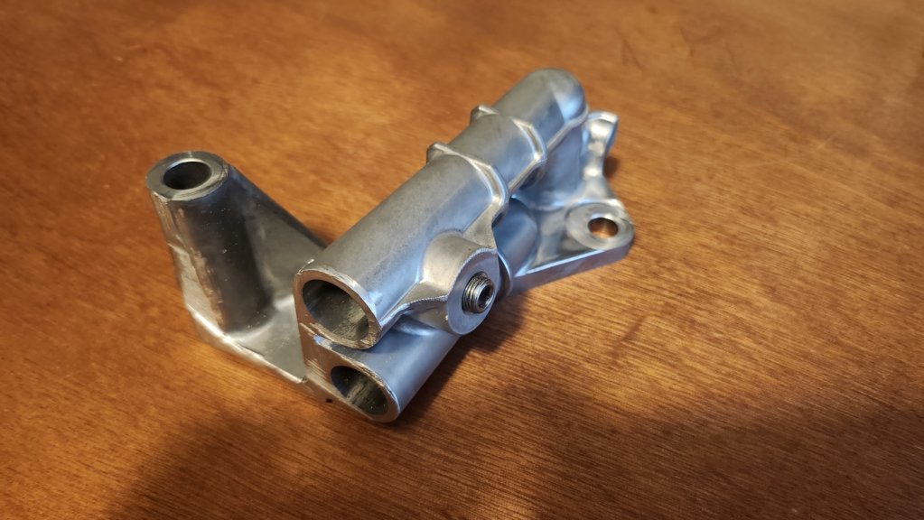

    I wasn't happy with the oil filter housing/adapter setup for my oil cooler project, so I put it on hold until I came up with another solution. I had purchased this housing a while back for the same project, and with the adapter installed, I just wasn't comfortable hanging all that weight off the timing cover. This morning I cut off the filter housing and left as much of the feed/return tubes as I could. It turned out that the inner diameter is 11/16", which is perfect for tapping -8AN ORB fittings, and there is enough material as well as enough space between the ports. I've ordered a tap and chamfering bit to make this happen. I already have 8AN ORB hose ends for 10AN hose, so I should be able to get it all assembled now that I have a better solution for the engine to remote filter mount.
    After cut-off wheel, Sawzall, and filing I ended up with this. I still need to sand/polish the port mounting surfaces, and will likely cut down that bottom mounting boss to be the same level as the other mounting points, or just cut it off all together.
    VWTim, Winks4x4Toy, Wynnded and 5 others like this.

    This is great! Having it tapped and going to the remote filter is sweet. Definitely send some measurements and the finished product. Better than trying to buy and install the RcF filter/cooler setup! I don't like having the filter by the sway bar with the baxter adapter...

    Bore this passage out to full diameter, the 5.7 doesn’t have this restrictor. Not sure why the 4.6 does.. maybe the smaller filter.

    Will do, thanks for the heads up
