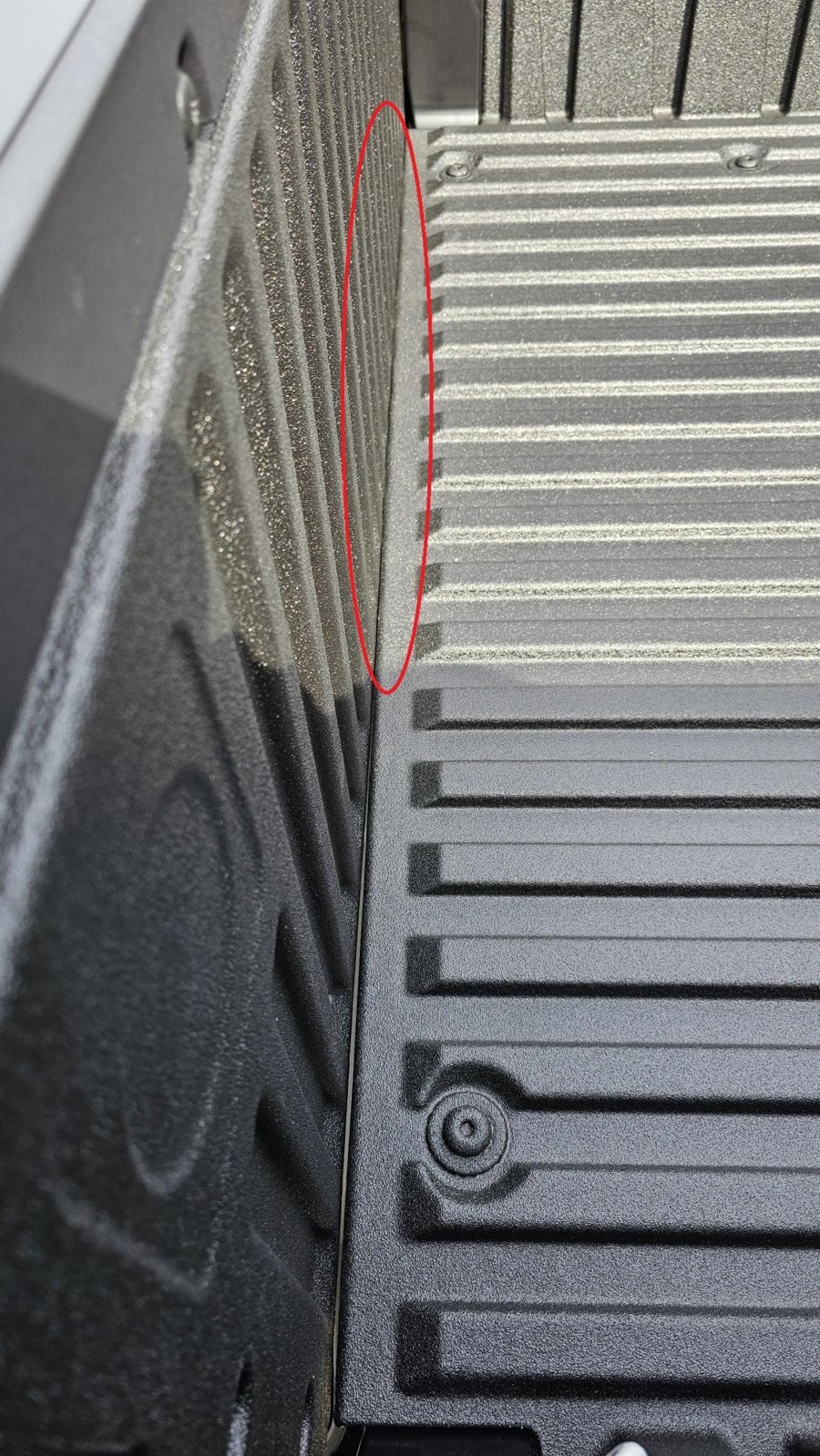

    I'm one of the ones with the misaligned tailgate on my new '24 (Rubbing the paint off slightly on the bottom right edge.) I've seen several complaints about it and I saw about 5-6 other brand new Tundras at the dealer with the same issue of the tailgate hugging the passenger side tail light. Since I'm waiting for the body shop to get back in touch with me, I just started looking at the gate and hinges real closely for the hell of it. Wouldn't you know it, the driver's side hinge is actually bent. Dropping the tailgate you can see the passengers side hinge is flat and mounts flush to the bottom of the tailgate. However, the driver's side is bent downward and it doesn't mount flush to the tailgate. It also causes the driver's side bottom of the tailgate to press against the bed when closed, whereas there's a slight gap on the passenger side. Anyway, it's something to check for others having the same issue. The attached pictures help illustrate.

    I ended up just looking up the part #s for the left and right tailgate hinges and ordering new ones. They're only about $40 ea. and picked them up at the dealer same day, which was surprising. After taking the tailgate off and removing both hinges, it looked like maybe the driver's side hinge wasn't bent, but it was somehow mounted improperly. I put both new hinges on anyway, touched up the paint on the edge of the tailgate and then re-installed it. The gap by the passenger side tail light is still smaller, but it's better. It also doesn't rub the paint off anymore and it doesn't pinch the bed on the driver's side when closing the tailgate. That was really all I cared about. Kinda lame having to fix stuff like this, but the dealer didn't really even try to fix it and I'm tired of waiting for the body shop to someday get back to me.

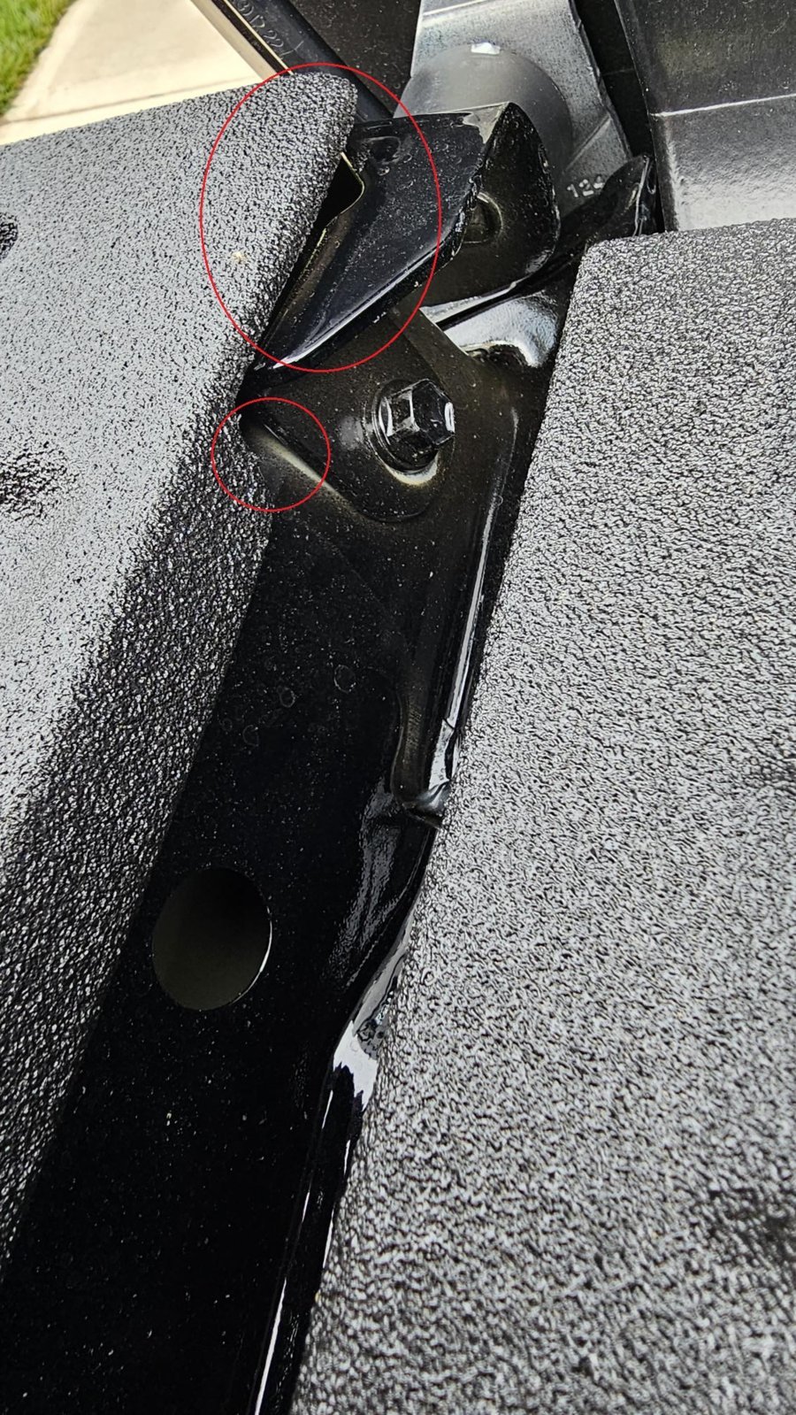

    The gray paint you see by the bracket (smaller red circle) and the bolt hold the bracket are from tailgate adjustment. It's usually done by a body shop when lining up door jams and fitting fenders and reveals. In the case of a new vehicle, it may be an adjustment made after assembly during QC or possibly at the dealership before final check. I'm not suggesting the vehicle has had body work or anything - it's not a big deal to adjust things like that. But seeing as you have a spray in bed line, I would think that perhaps the bed liner caused some interference between the bed and tailgate, so whoever applied the liner had to adjust the tailgate in order to close it. That's just a guess..

    Yeah, I was wondering about the port installed bedlinder as well and if maybe someone tweaked it then. The drivers side bracket was moved at some point because I could really see the outline of where it was painted over at the factory on the side of the bracket (Not shown in the pic). When I reinstalled, it fit pretty much prefect over the paint pattern. Yeah, it ended up being a fairly easy fix once I just decided to do it myself.
