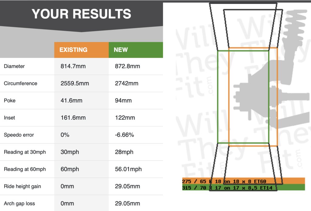

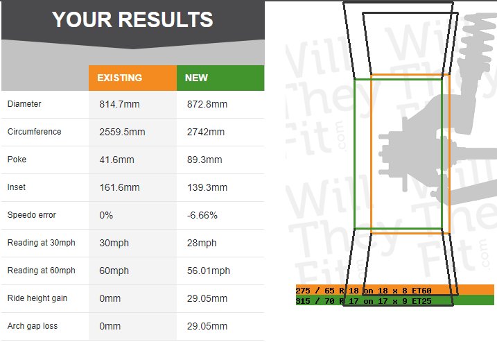

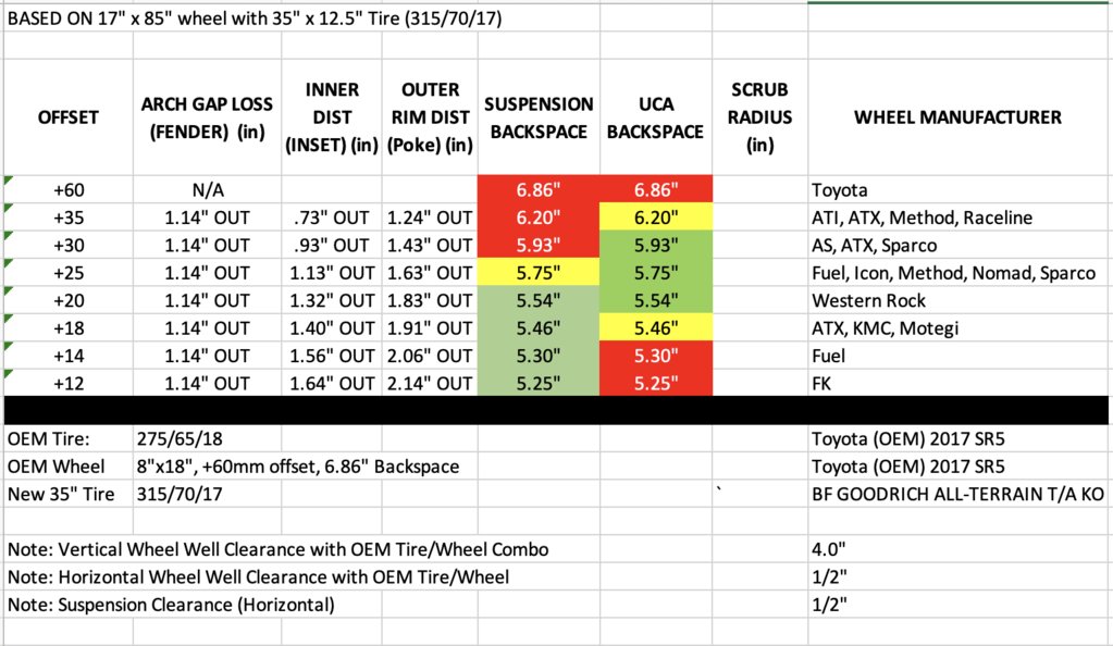

    Standing by for corrections. Trying to minimize rubbing, cutting, etc. and maximize the ability to air down (within reason) without going to bead locks, or losing a tire (I take the kids and wife with me). From scouring the internet, it seems 8" is the ideal wheel width for 35" tires to execute that endeavor, but that width can preclude some tire options, unless you are running bead locks (I won't). Not interested in fiberglass quarter panels, or a bunch of cutting/fabrication if not necessary.
    Not sure which offset is best for the least rub and maximum articulation.

    • Backspace
      • OEM: 6.86"
      • Recommended Range / Limits:
        • Camburg: 5.75” - 6.00”
        • Dirt King: No more than 5.0"
        • Fox: At least 5.5"
        • Icon: 5.75" ideal
        • JBA: 5.75" ideal
        • King: At least 5.5"
        • MCM: 5.75" ideal
        • Method: 5.75" ideal
        • Total Chaos: At least 6.5"

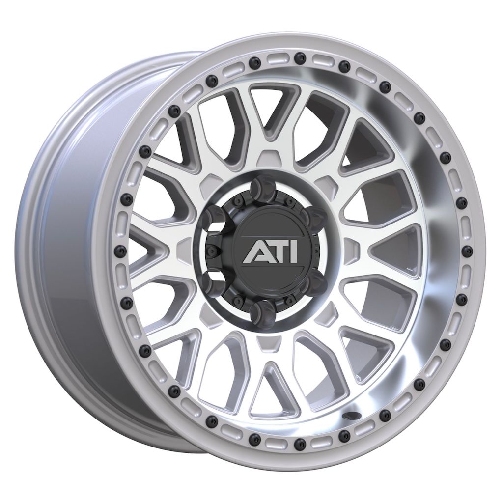

    All Terrain Industries (AT) AT-01 Hybrid Beadlock
    Price: $246
    Wheel Diameter (in): 17"
    Bolt Pattern: 5x150
    Wheel Width (in): 8.50"
    Offset (mm): +35 mm
    Backspacing (in): 5.88"
    Hub /Center Bore (mm): 110.15 mm
    Wheel Weight (lbs): ?? lbs
    Max Load (lbs): 3,637 lbs
    Note 1: Lifetime Warranty (structural)
    Note 2: T6 Heat treated A356 aluminum construction
    Note 3:
    Recessed valve stem for added protection

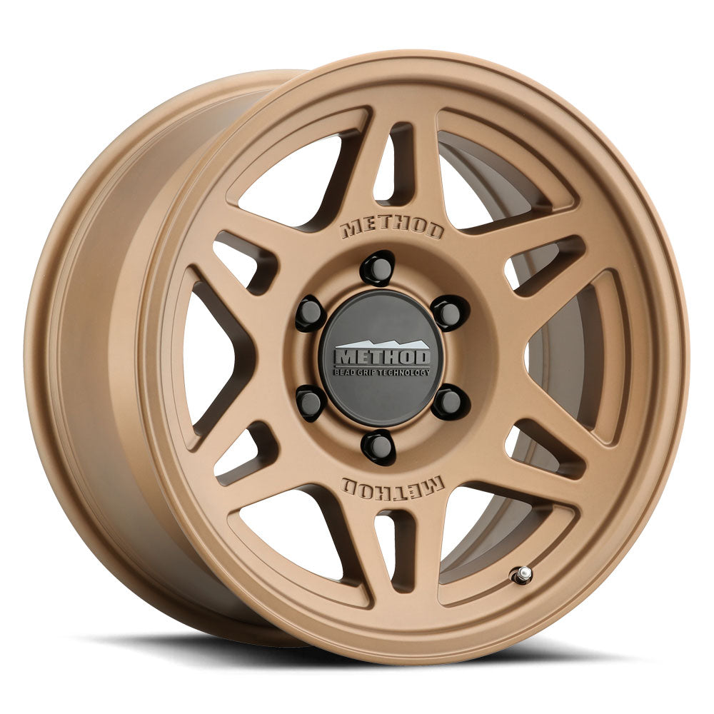

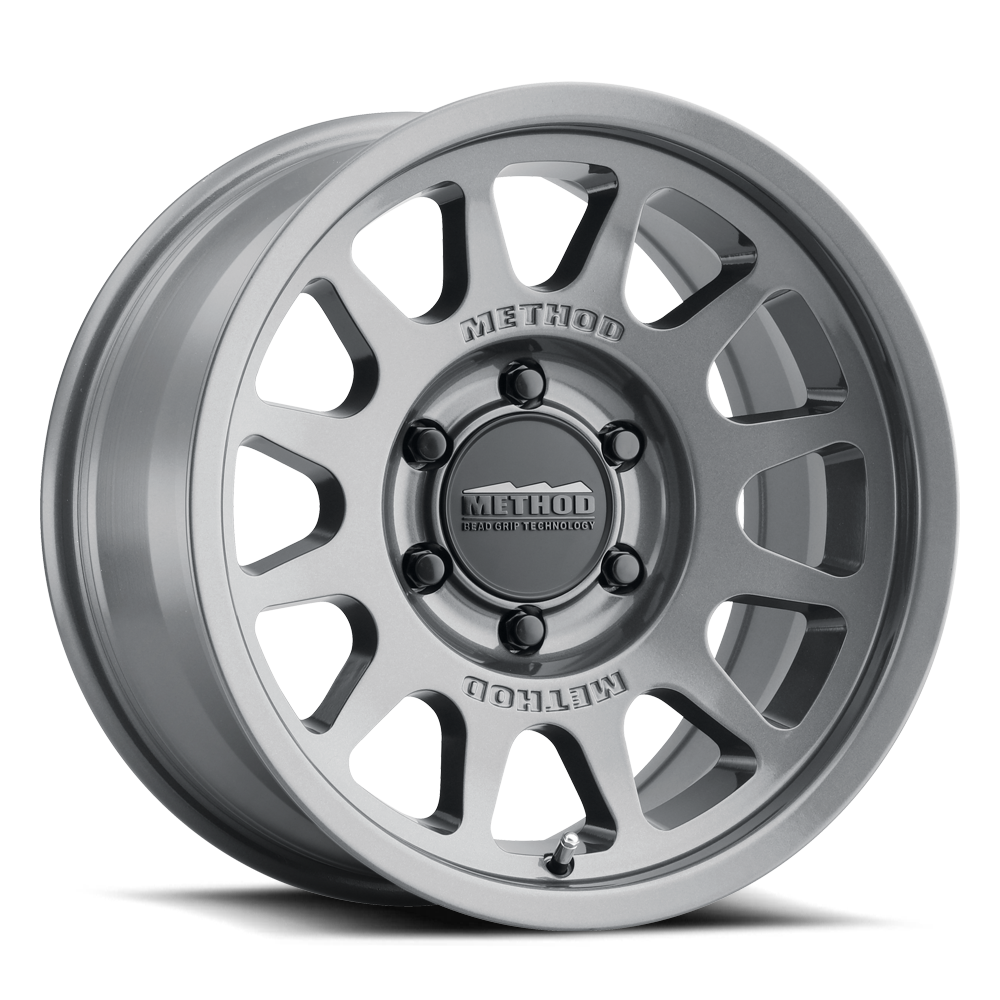

    Method Race Wheels 703
    Price: $319
    Bolt Pattern: 5x150
    Wheel Width (in): 8.5"
    Offset (mm): +35 mm
    Backspacing (in): 6.2"
    Hub Bore (mm): 110.5 mm
    Max Load (lbs): 2,650 lbs
    Wheel Weight (lbs): 27.91 lbs
    Note 1: Bead Grip for low pressure (Method)
    Note 2: Solid A356 Aluminum with T6 heat treatment (Method)
    Note 3: Reinforced inner lip from MRW race wheel for increased strength (Method)
    Note 4: Lifetime Warranty
    Method Race Wheels 705
    Price: $319
    Bolt Pattern: 5x150
    Offset (mm): +35 mm
    Wheel Weight (lbs): 25.55 lbs
    Max Load: 2,650 lbs

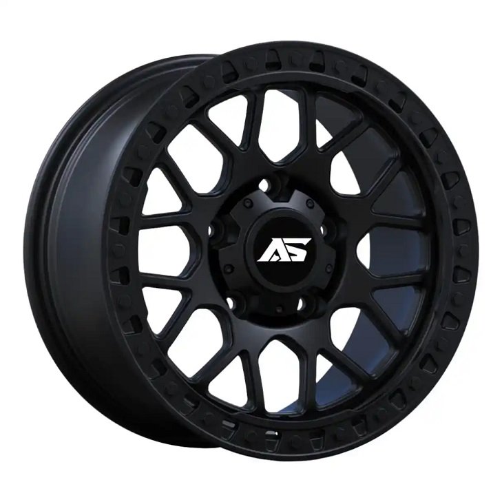

    AutoSpec (AS) Forged Alloy Titan
    Price: $499
    Bolt Pattern: 5x150
    Offset (mm): +30 mm
    Backspacing (in): 5.93"
    Hub /Center Bore (mm): 110.1 mm
    Max Load (lbs): 2756 lbs
    Note 1: T6061 aluminum
    Note 2: Protected recessed valve stem design

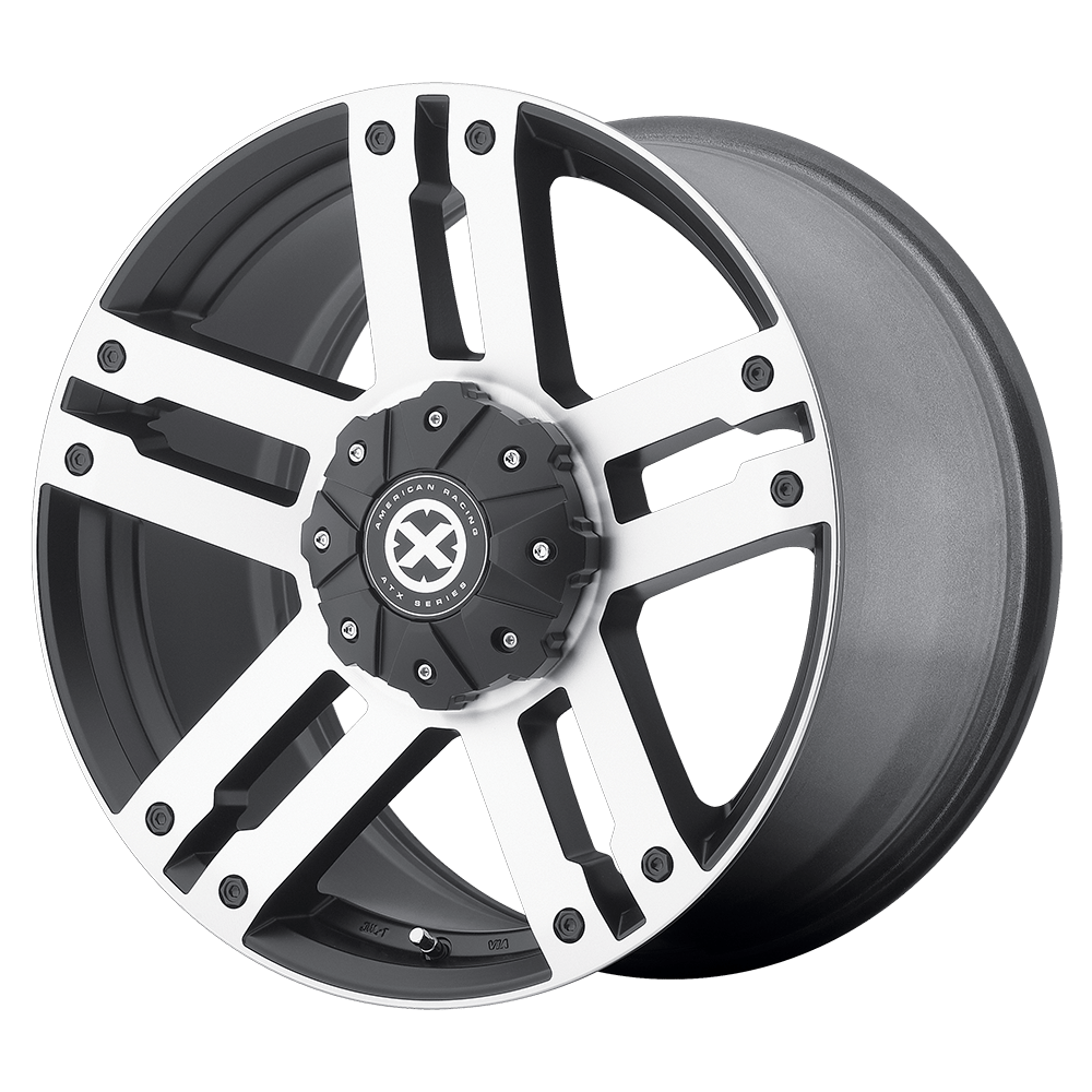

    American Racing ATX AX190 Dune
    Price: $107
    Bolt Pattern: 5x150
    Offset (mm): +30 mm
    Wheel Weight (lbs): 23.26 lbs
    Max Load (lbs): 2,500 lbs
    NOTE 1: Lifetime Structural Warranty

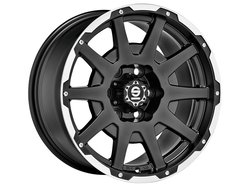

    Sparco Dakar
    Price: $181
    Bolt Pattern: 5x150
    Offset (mm): +25 mm
    Backspacing (in): 5.75"
    Hub Bore (mm): 110.1
    Wheel Weight (lbs): 28.88 lbs
    Max Load: 2,535 lbs
    Note 1: Gravity Cast
    Note 2: Heat-treated for strength
    Note 3: TUV certified

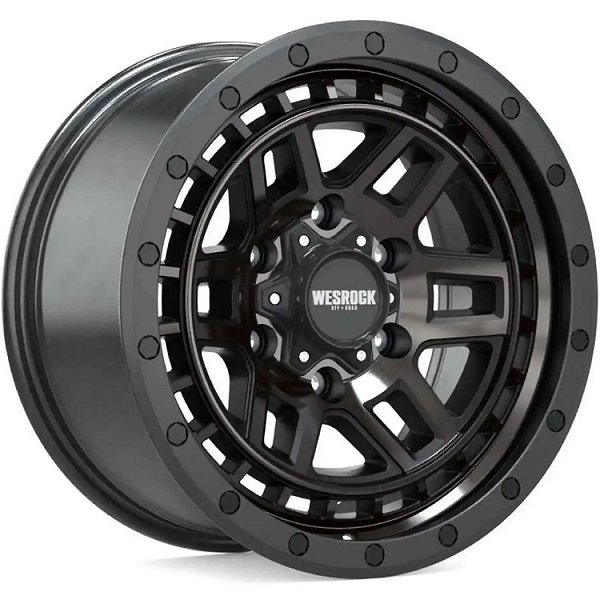

    Western Rock ( WESROCK) Wheels BT-26
    Price: $191
    Bolt Pattern: 5x150
    Offset (mm): +20 mm
    Backspacing (in): 5.0"
    Wheel Weight (lbs): 28.20 lbs
    Max Load: 2,500 lbs
    Note: Lifetime Structural Warranty

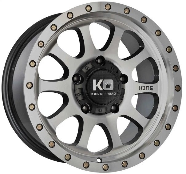

    9.0” (+35) OFFSET WHEELS
    King Hurricane II
    Price: $207
    Bolt Pattern: 5x150
    Wheel Width (in): 9.0"
    Offset (mm): +35 mm
    Wheel Weight (lbs):
    28.70 lbs
    Max Load: 3,527 lbs

    Below should be a decent comparison of OEM vs aftermarket wheel options - with 8.5" wheels combined with the largest tire (315/70/17 ~ 35/12.5/17) of the group above as a worst case.
    What I do not know, and appreciate help on, is if the Fox can/reservoir really requires a limit of 5.5" backspace on the Tundra when mounted.
    Appreciate the help and hopefully this is useful to someone else going through wheel selection for the first time and confused as I am!
