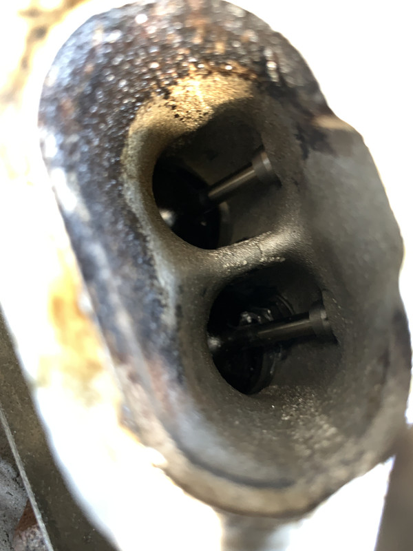

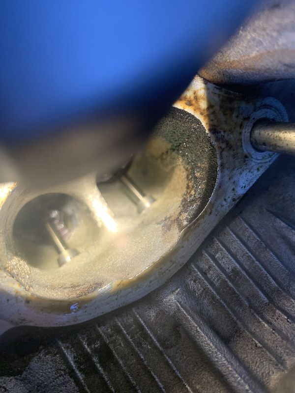

    Well I have an update on my issue and I feel like a complete idiot. While I was removing the head originally to do the repair I found 3 random bolts (that didn’t below to the truck) sitting on the manifold. All ready to fall in. Didn’t think anything of it and I have no clue how they got there. Maybe I pick them up on the freeway.
    Turns out I missed one and it fell into #7 while I pulled off the intake manifold.
    I did put shop towels to cover each hole and I a mirror, magnet and even took a shop vac to each before closing everything up.
    And I still missed it.
    Even with a flashlight it was hard to see because it was on the inside corner of #7.
    The nut is now out, I turned the engine Manually and I have good compression. Looks like the nut wedged itself cause it was very difficult to remove. Will be putting everything back on Tuesday, I hope no damage was done.

    Good Eye on that.
    I had a Banjo Washer fall into and land perfectly inside one of my Infector Holes when removing/upgrading to 12 Holes. I knew about these Banjo Washers being tricky, but this one fell without me seeing where. Started into a FULL @Pucks18 Panic Attack searching all over.
    Summonsed up The Spirit of Chief Eagle Eye in the Sky through Deep Breath Meditations and He guided me to Injector Hole #1. It was laying flat in there. Chances? Higher than becoming a Hand Model.

    Do you have a sharper picture? I’d like to put it in the FOD/FOE ( foreign object debris/foreign object elimination) presentation I have at work. J/K :D
    Although not nearly as bad as the guy who left a peanut butter sandwich stuck to the inside of a missile radome. :eek2:
    Great find! Hopefully no further issues or any permanent damage as a result.
