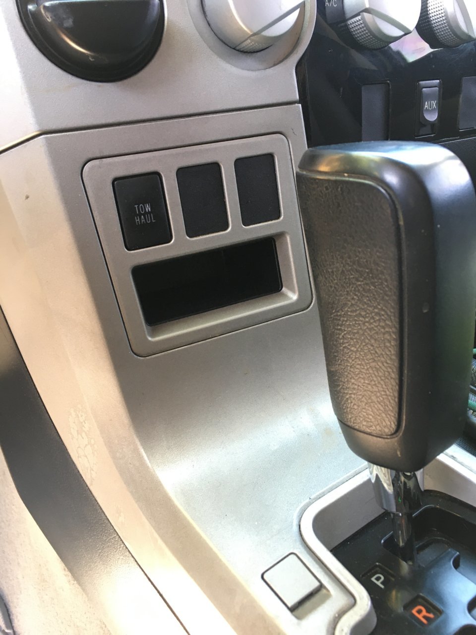

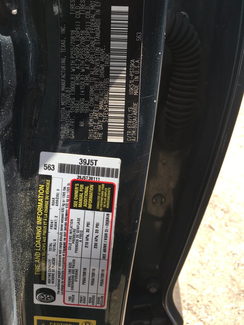

    If it does have the tow package, there will be a Tow/Haul button in the center console forward of the floor shifter. I can't recall where the T/H button is for the column shift trucks. The T/H equipped trucks all have a 4.30 rear ratio. Also, on the door jamb there's an informational sticker that will have the code for the rear ratio, grab a pic of that and post it here and someone can sort it for you.

    Im assuming it does have a tow package lol

    Yep, there should be a receiver hitch under the bumper too, unless someone remover it...

    It does. I just thought someone may gave put it on there. So it has a 4.30 ratio. Thanks...

    A/TM: B02A is the ratio, 4.30; AB60E is the transmission.

    You’re the bomb bro thanks greatly appreciate it
