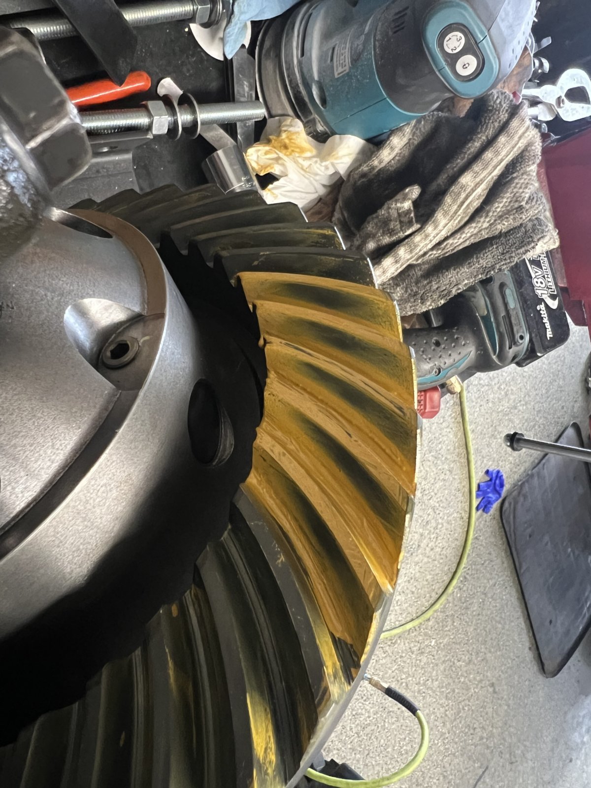

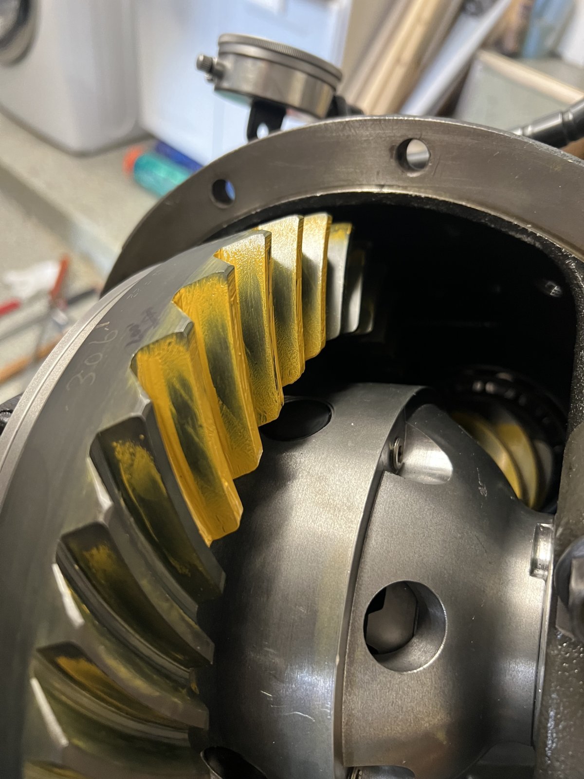

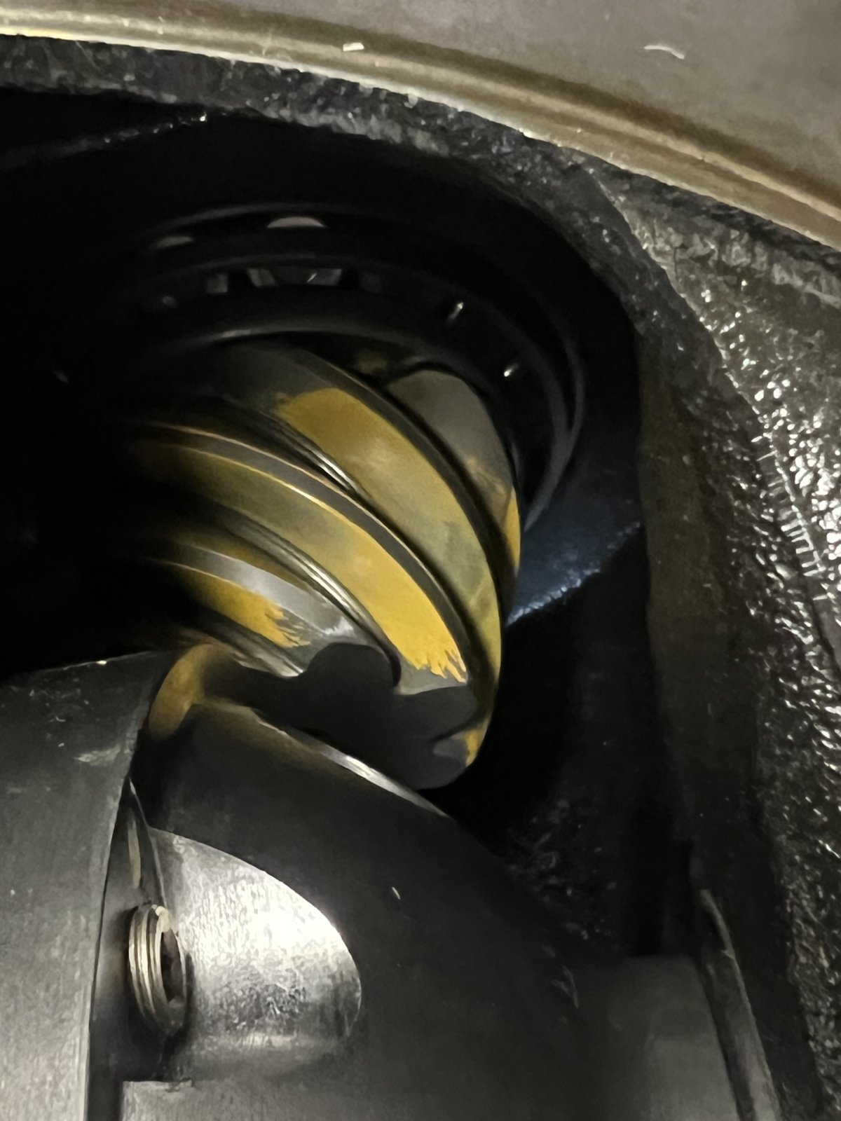

    IMG_4595.jpg Hello,
    I’ve installed a new ARB locker with new 5:29 gears. I’ve been playing with adjustments on the pinion depth and backlash. Btw I’ve seen varying specs on backlash from .004-.008 and .008 to .010. I went with .008 because I’ve read that dealer gears (5:29s) need more backlash. Is anyone been there and done that? Please look at my pictures and give me your opinion. Thank you IMG_4593.jpgIMG_4597.jpg
