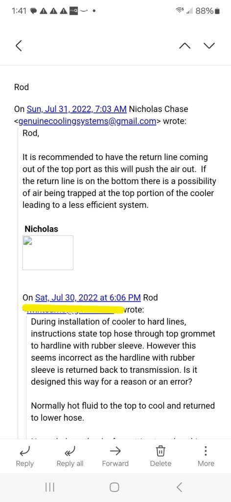

    I called GCS about that and they said (per instructions) that hot transmission out to bottom of radiator and cooled radiator out to transmission is top port. I was always under the impression (like coolant system) it was opposite. They mentioned trapped air in top of radiator as the reason.

    I don't see a number anymore, I installed my cooler 3 years ago. Try emailing them?
  24. Mar 10, 2025 at 1:45 PM
    #24
    Tunrod
    Tunrod New Member
    Jun 11, 2024
    #118267
    530
    Rod
    2021 SR5 CM 4x4
    I take that back, I actually emailed them. Screenshot_20250310_134158_Email.jpg
