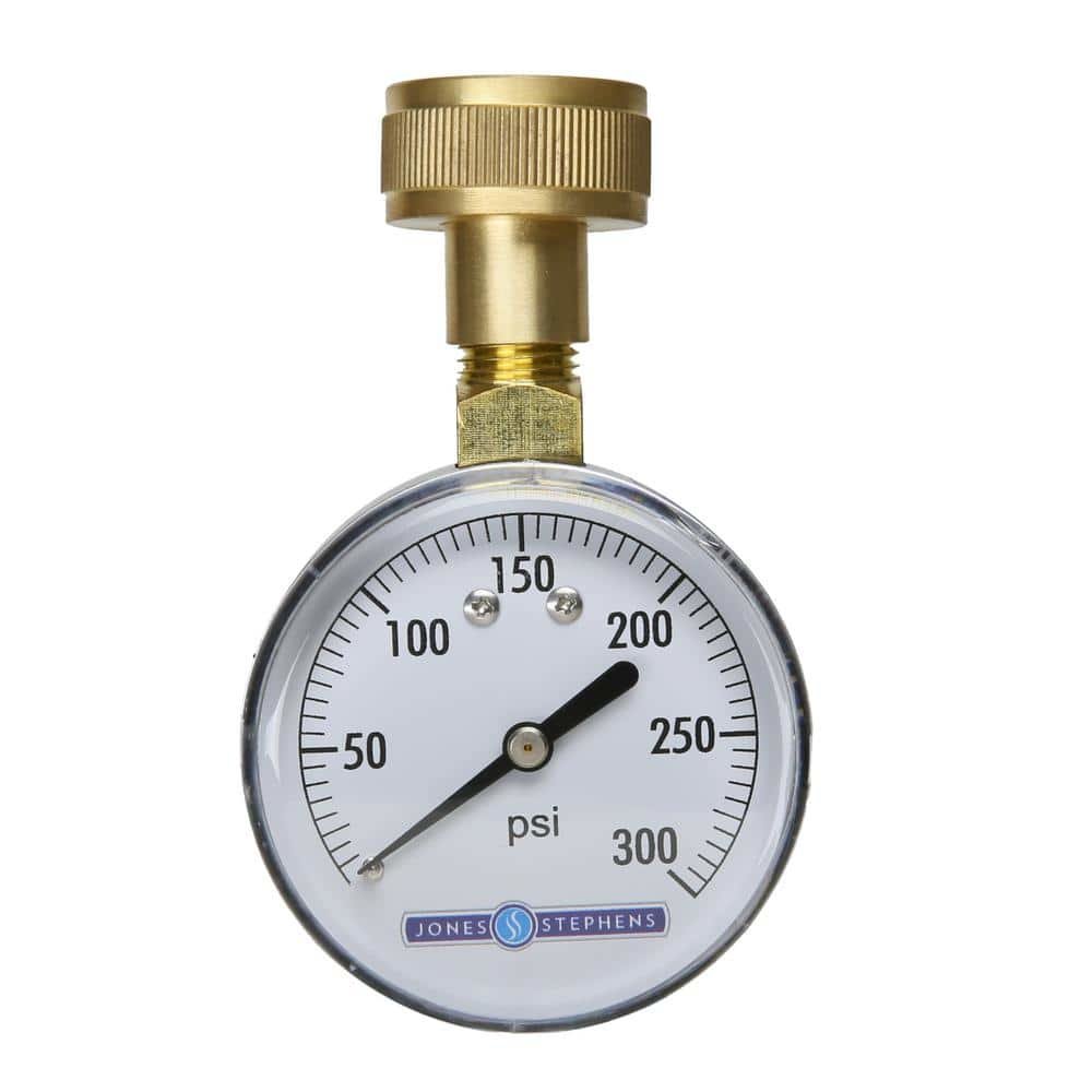

    I’d connect a pressure gauge on your system and check system pressure. Assuming you have a pressure regulator valve somewhere in the area of the main shut-off (interior / crawlspace), it may be malfunctioning and letting the pressure get too high, thus the leak at your new valve. Note that exterior hose bibs may be plumbed to the main before the regulator, so that might not be the place for a gauge.
    Or, your new valve is made from low quality chinesium and might need to be melted down into a higher grade of chinesium. Lots of garbage parts out there these days. I had a new toilet supply line (braided SS) leaking at both crimps just recently.

    Hmm, yeah, another possibility. If @TXRailRoadBandit73 has a thermometer (meat thermometer works great), it would be easy to check at the tap if it’s getting too darn hot.
    For a rough reference, my thermostat is set to the middle of the road, and temp is about 135 - 140F.
    I’m still thinking it’s a high pressure issue.

    Just looked at mine and fitting on discharge valve is larger than standard water pressure gauge. Ideally you would want to measure pressure at discharge valve. Gauge will hook up to drain valve but I'm not sure if pressure is different down there.

    Even if the expansion tank or lack thereof is the problem, that will show up on a pressure gauge on the tank, though you might have to watch it until you go crosseyed to see it. The highest pressure would be when the temp gets to the highest just before the burner shuts off.
