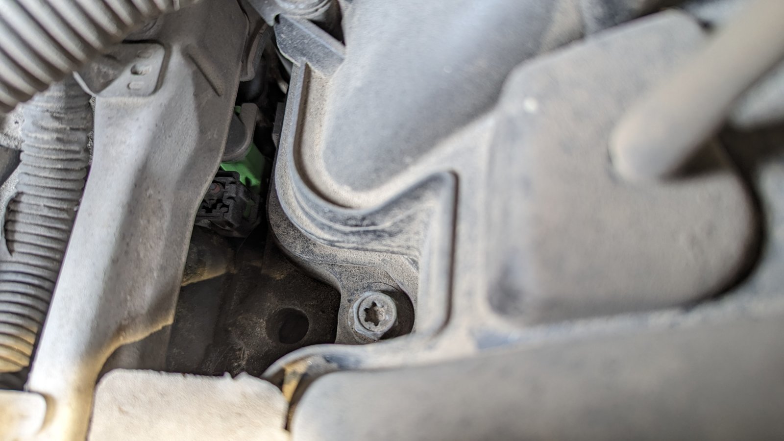

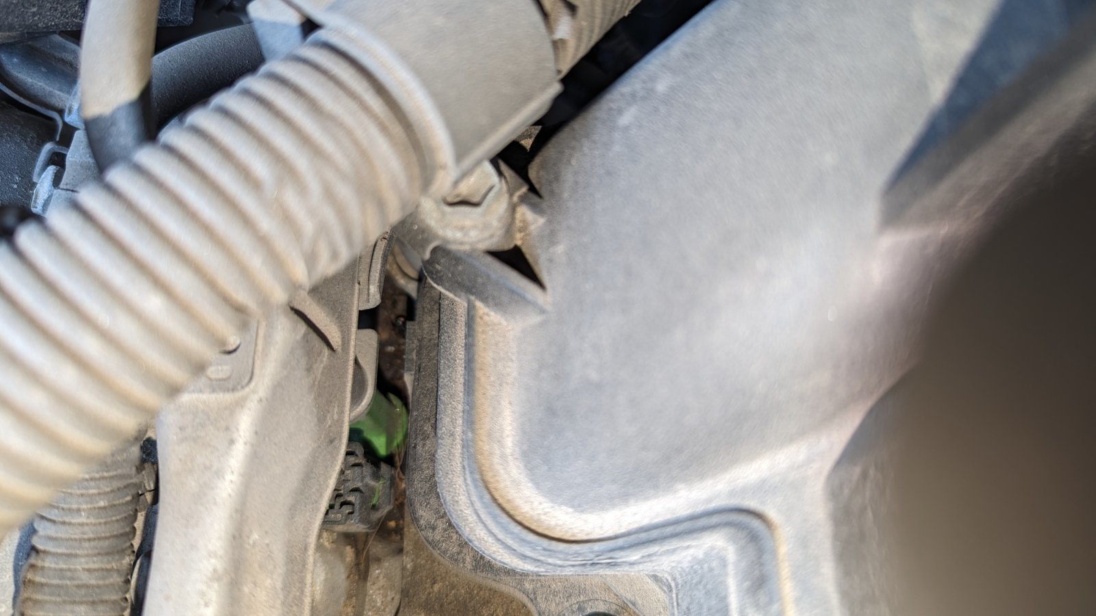

    Are these stock injectors? I wonder if one of the o-rings went bad? PXL_20240509_150742160.jpg PXL_20240509_150814985.jpg

    As far as I’m aware, all stock injectors are tan in color. Anyone else have info to refute that? The green injectors came with the TRD SC kit.
