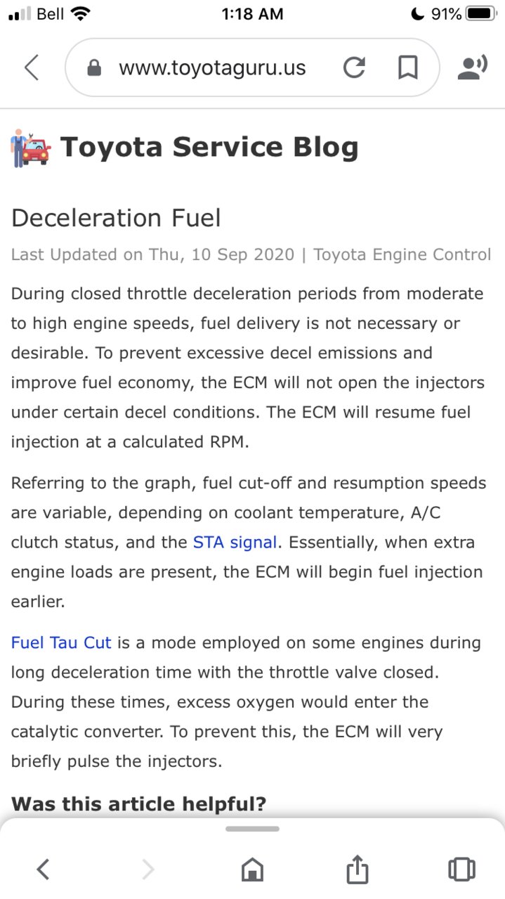

    Here is a page from the repair manual talking about torque converter lock up during deceleration fuel cut, allowing the engine to be turned by the wheels during deceleration through the locked up TC clutch to save fuel.

    World's fastest supercharged Tundra - 2010 RCSB - 10.8 @122 - All wheel drive conversion, lowered, supercharged 2008 DCLB - All wheel drive conversion, 13" lift on 37's
    Under a lot of coasting conditions (but not all), there is no fuel being injected into the engine whatsoever.
    Once the engine rpm drops to a certain point, or the accelerator is applied, or the transmission is put in Neutral, fuel injection restarts.
    There is really no point for me to try to convince you any further.
    I have been a shop foreman at a Lexus dealership and a Toyota master tech for 15 years.
    You could just google “deceleration fuel cut” and read up on it.
