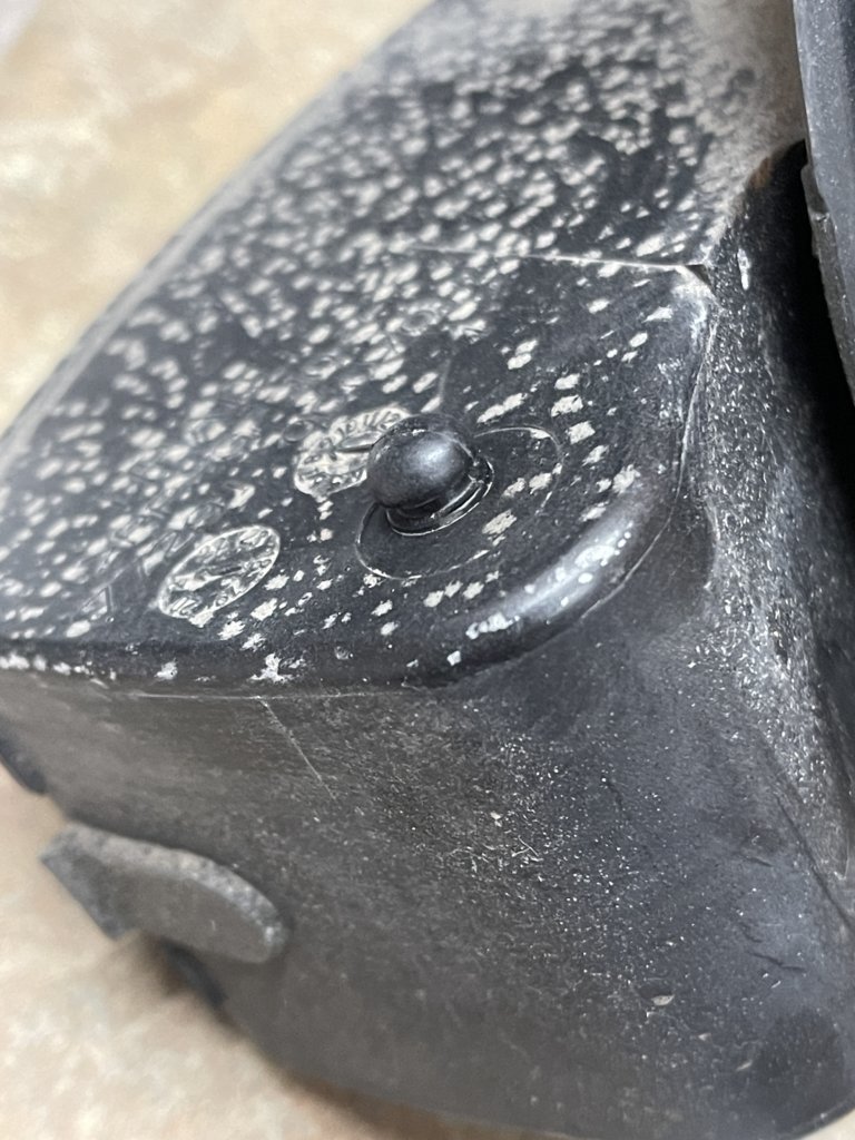

    Anyone come across this issue? Just recently, the gas door doesn't stay closed. It basically stays ajar about a half inch. I don't notice anything obvious that could be wrong with it. See the picture for example.

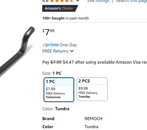

    Lay on the ground and look up under the truck by the fuel door with a flashlight. You should be able to see the spring mentioned in that youtube video posted above. I did this and noticed the spring was extremely rusted. Next, I replaced it with a stainless spring and the door now closes completely. Search ebay for "tundra spring door" and make sure it comes with an e-clip.

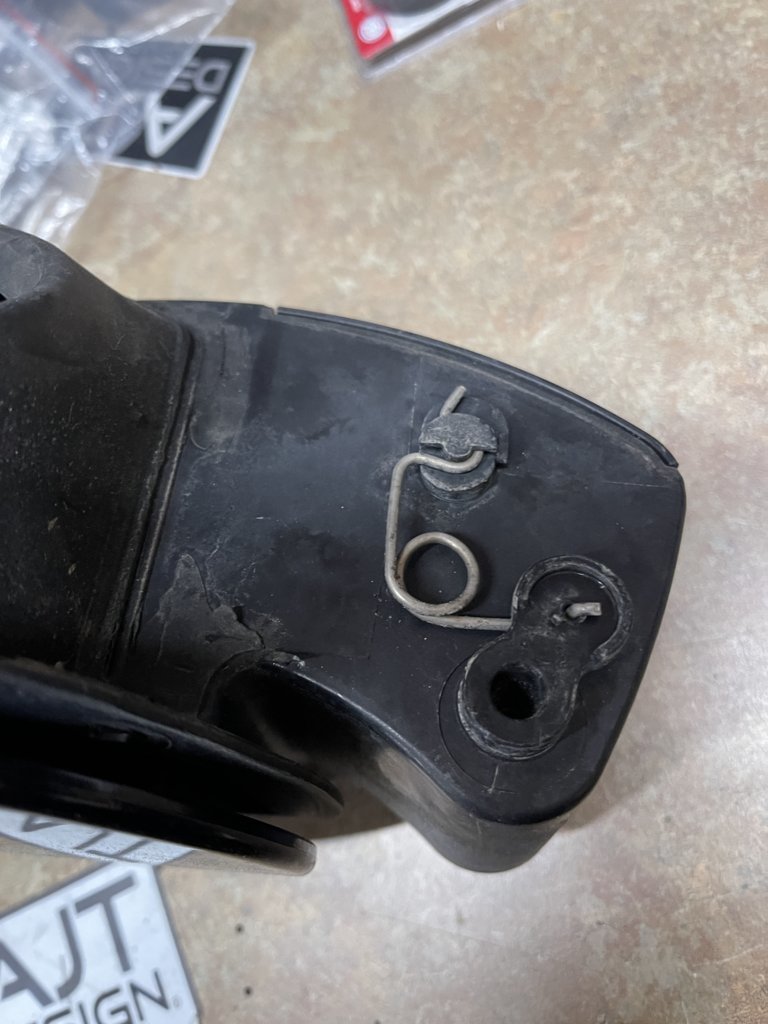

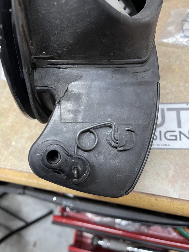

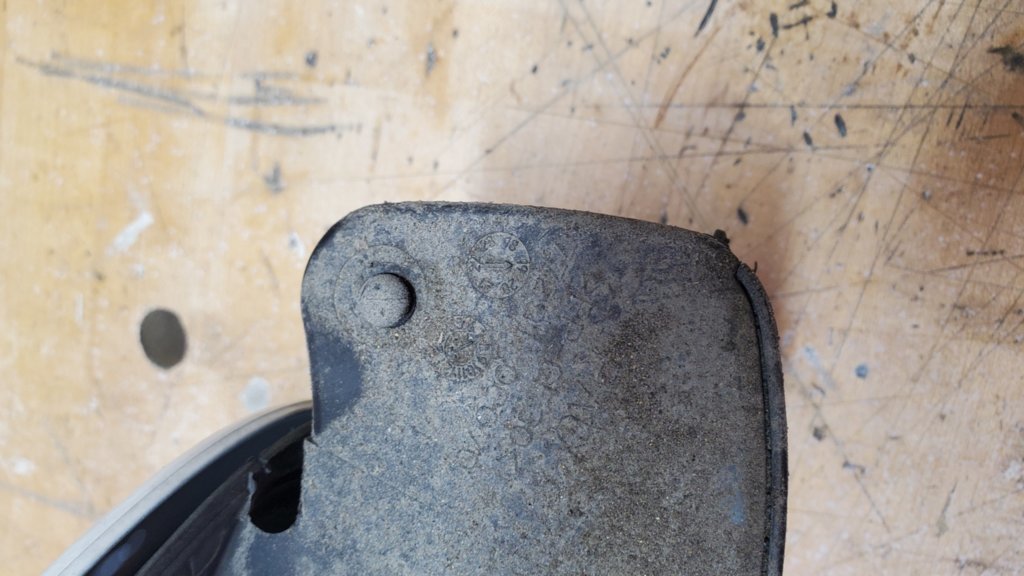

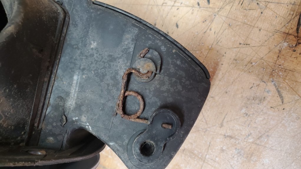

    Just got done replacing the spring on my 21. 15mins job. Super simple. Mine was missing the C-clip from factory. I dont know if it fell out or someone forgot to put it in. But it’s better now. When you close the lid, it actually shut. The factory spring seems weak and would not “shut” when closed. No “snap” in.
    $10 for 2 springs and c-clips.
    missing C-clip
    Old
    New
    woods likes this.

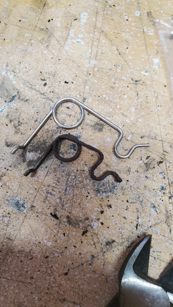

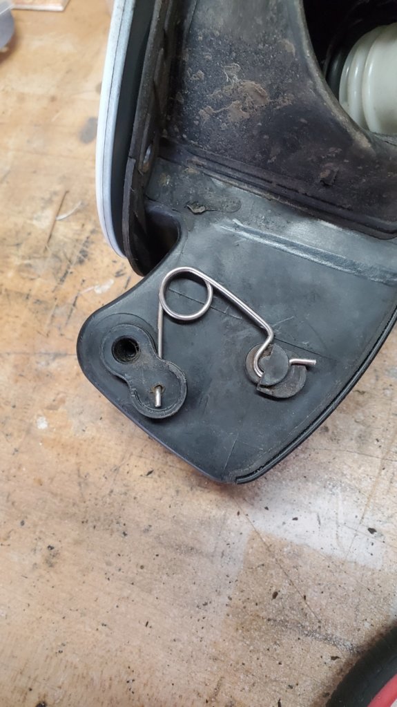

    Well, it has been repaired. The spring was nearly rusted through and broke as I was taking it out. I'm actually surprised that the new spring is larger than the old one. Not sure if it has been updated or if it is just a shitty part manufacturer. Either way, it works now. It was a bit of a pain getting the spring out of the plastic hole. All in all, it probably took about 15 minutes.
